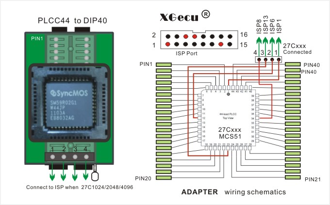

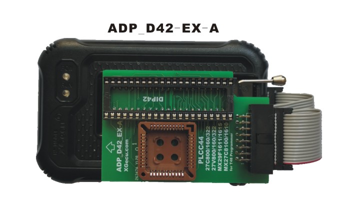

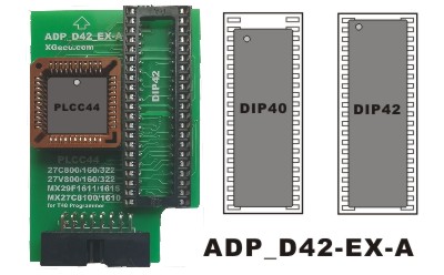

T48 Adapter DIY (T48编程器自制适配器)
1.DIP42/PLCC44
for 27C800/160/322  27V800/160/322  MX27C8100/1610
only for T48 Programmer
T48_DIP42-2.rar (657.12 KB)
2.PLCC44  for  C51 /27Cxxxx / PIC
PLCC44_T48.rar (1.07 MB)
