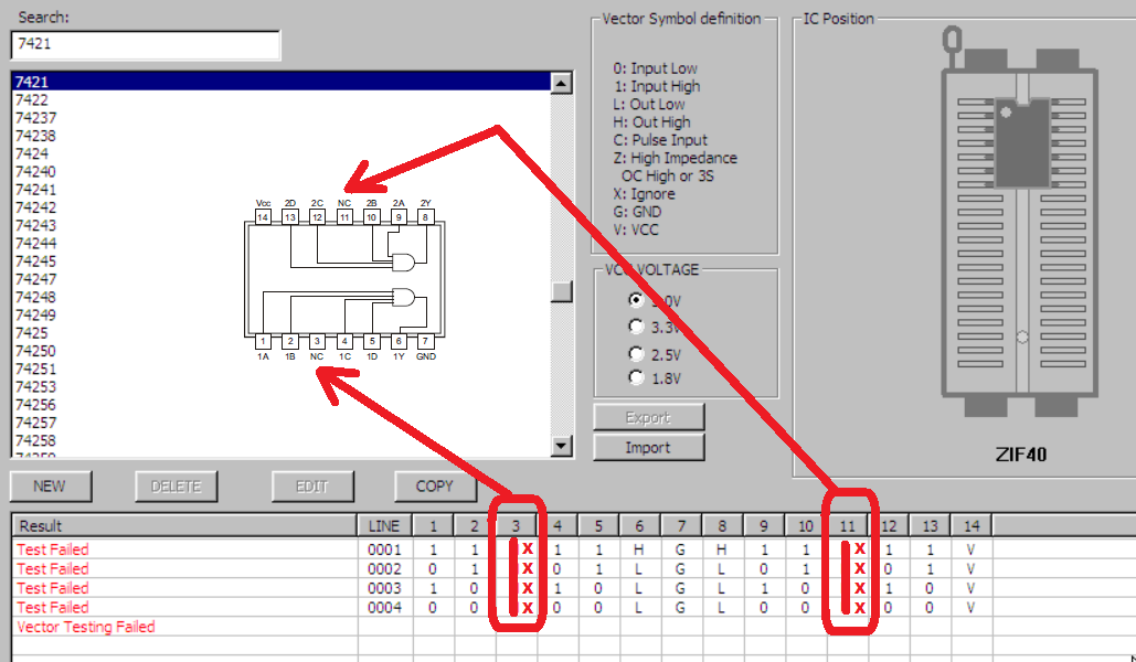

74LS21 fails with TL866
Testing a known good 74LS21 fails with  TL866II-Plus App Ver 11.90

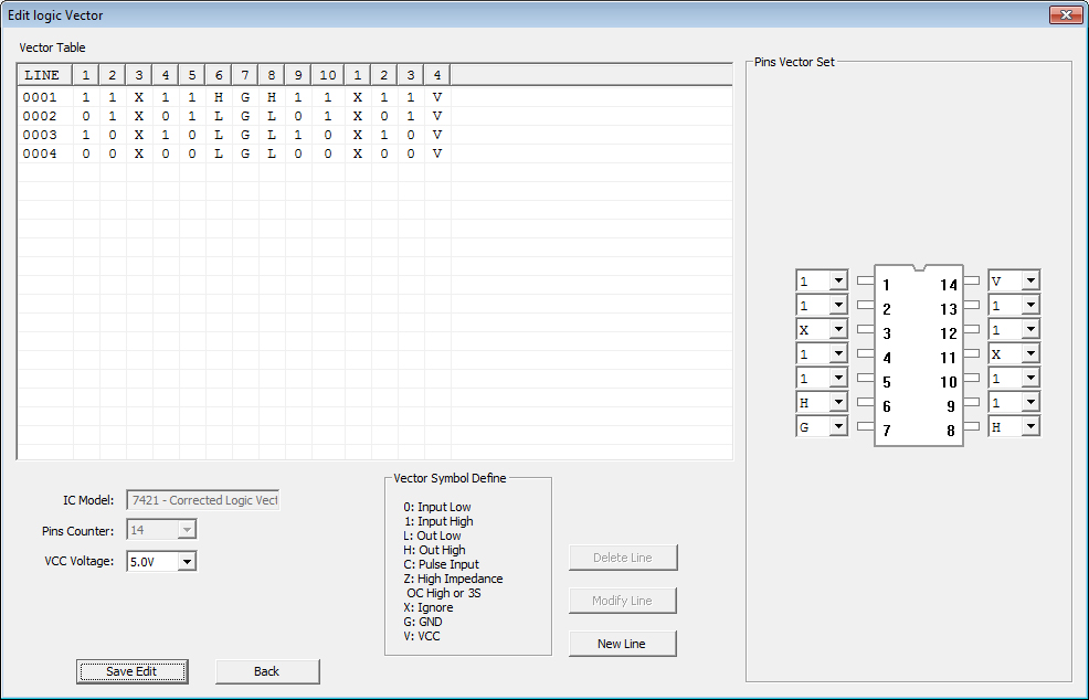

   Out of curiosity I checked what the logic vector of the 7421 chip looks like from other companies. I found a couple of companies that also have the wrong vector, but I guess they don't have as much support as XGecu, which will have a revised logic test any day now.
I can already see the screenshot, it hasn't displayed for a while,
Yes this logic vector is wrong, because pins 3 and 11 are unused/not connected (NC), so instead of expecting the value "H" (TTL logic level high/logic value "1"), there should be an "X" there as shown. In some time this vector should be corrected. Thank you for the information.

   Please post a screenshot showing the erroneous test.
