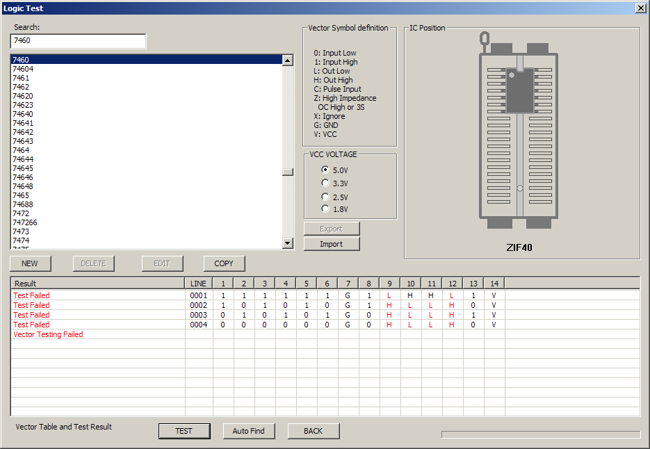

I bought some 7460 expander circuits and some circuits that they connect to, I chose 7450. After checking it turned out that the vectors for 7460 in your programmer are wrong.
It's best to test expander together with other connected chip that controls it, but it's not possible in programmer without additional connections.
Additionally there is a small problem, that expander doesn't have normal logic outputs.

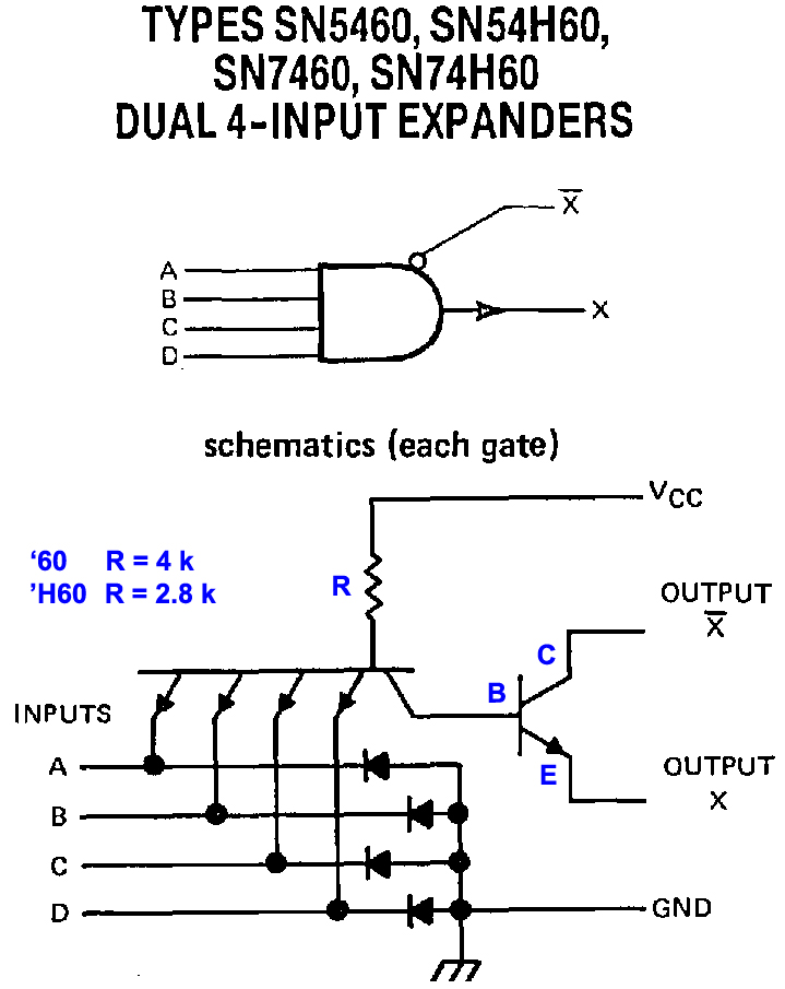

Looking through the circuit diagrams I noticed that the gates cannot give two different TTL logic levels on both X and /X outputs as in your Logic Test, because these are outputs (N-type layers) of one transistor (NPN): X-Emitter (E), and /X-Collector (C). However, you can take advantage of the fact that when the transistor is controlled by an AND gate, states appear on its Base (B): low (logical zero-false "0 ") and high (logical one-truth "1"). If it is a low state, the transistor is occluded, and we should recognize a high impedance state "Z" on the X and /X outputs. However, if it is a high state (positive voltage above 2-3V), and the Base (B) is a P-type layer, it will be possible for a low voltage to flow from the Emitter (E) to the Collector (C), and in addition, looking at the transistor as a compound of two diodes, a current will flow from the Base (B) to the Emitter (E) and to the Collector (C), and we should read a high state "H" there. I tested this theory and it turned out to be true.

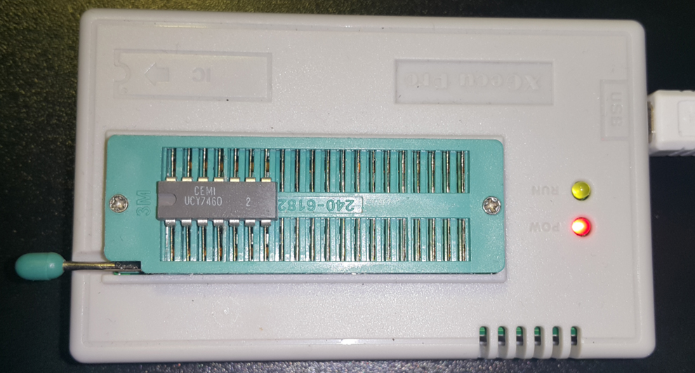

I enclose the result of a faulty test of a 7460 chip, specifically a UCY7460 from Unitra CEMI (Poland) . The tests of all 4 purchased chips are identical.

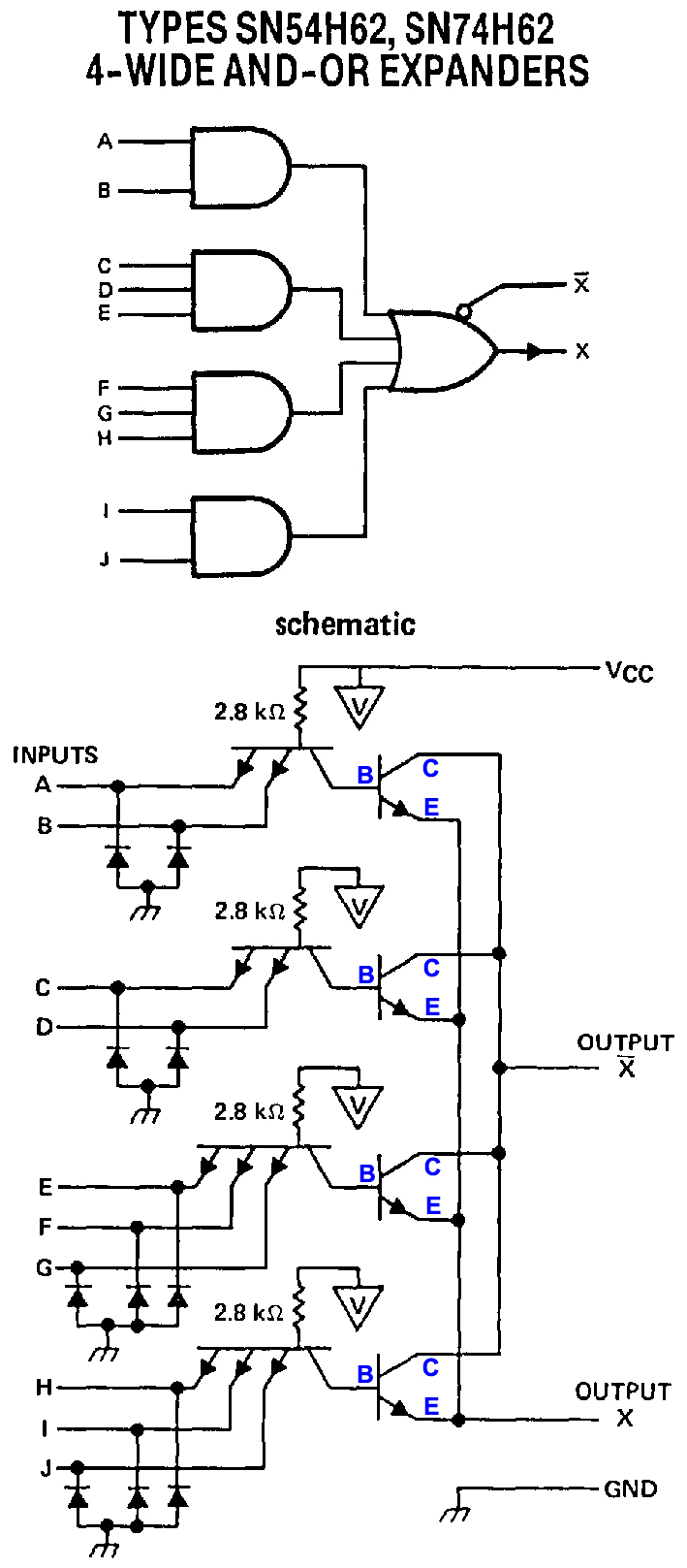

I also attach the datasheets of those expanders and the schematics of the gates they contain.
Since expander 7462 has a similar structure, its Logic Vectors must also be wrong.
Exactly the same vectors, that is also the same errors, have the following professional (and very expensive) universal programmers:
-Genius G540, G840
-SmartPRO X8;
-TNM series of programmers (for example 5000 and 7000);
-VELLON series of programmers;
-XELTEK programmers.
