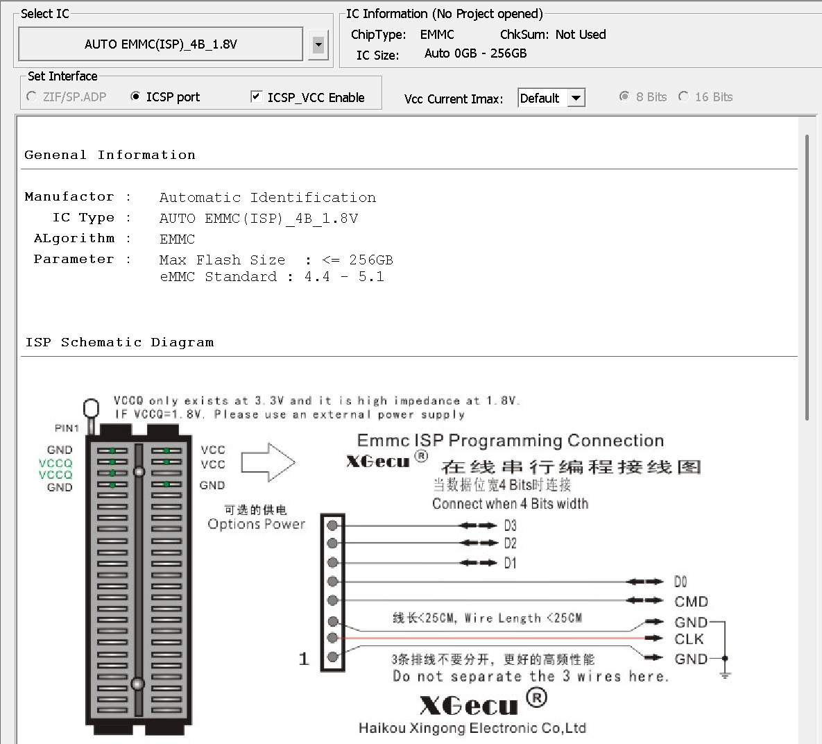

My plan is to use the last adapter and rewire to use the ISP connector and see if the T56 can read t ...
luzmina 发表于 2026-1-17 05:25
Using ISP.... till 4 bit only, slower, and select auto  xxxxxxx, see picture
My plan is to use the last adapter and rewire to use the ISP connector and see if the T56 can read the chip, they do not provide the schematic of the adapter, so it will take me a few hours to do it. Thanks

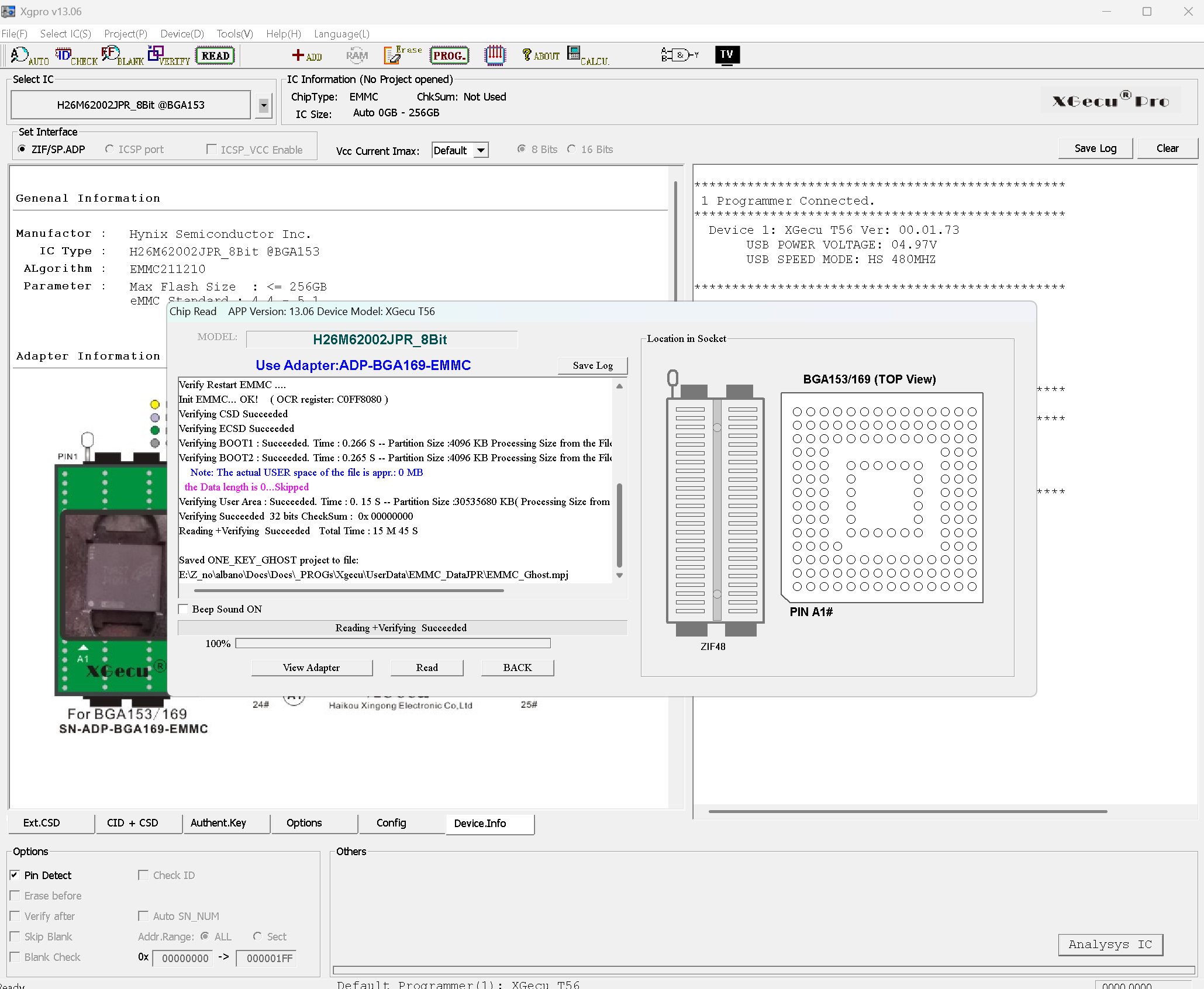

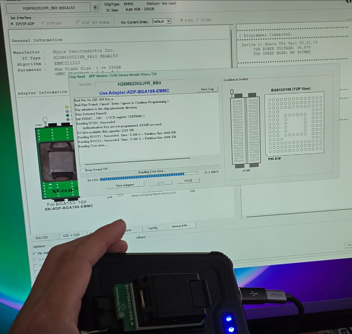

I purchased this one on their site and same problem, failed to read the H26M62002JPR, I contacted th ...
luzmina 发表于 2026-1-15 03:58
   At least they can't say 'you are the only one with the problem' as they already have at least 2 complains, as you bought adapter number 2, from picture in the post before, and also failed, and they know that. Even the problem may be at shielding level, is so severe, that the software trottling down in frequency, you already shown in the log, down to the bare minimum  , 8MHZ, isn't capable to initialize the IC. I stop all 'guessing' till they update the software to support all adapters, if they do not do it , as the software is the very same for T48, not big deal, restart selling the discontinued  adapter, as other faster ICs, for sure will (may) also fail, i will try to build a faraday cage that connect to signal gnd.As a work in progress, please, post here any new versions you may know, even not tested yet, of IC new versions used in the boards of that Tvs, i'll try to test here a.s.a.p.
Note: There are one other available way to use BGA153 in the T56, that needs adapter Adaptador rt809h para t56 para emmc, RT-BGA169-1, adp bga169 EMMC-2 bga153 bga100 bga162 bga221 bga254 - AliExpress 7   and also, for those that already own a RT809H, the  BGA153 adapter version 2.5, as the last version i found, some 2.3 already seen for selling, Adaptador original RT-BGA169-01 bga169/bga153 emmc v2.5 com 4 peças caixa de ligação bga para programador isp rt809 rt809h - AliExpress  . I did not test this way, as i do not have RT809H in my set of tools,  T76 instead.
Even if a new PCB is needed, they can sell it alone, cheap, and techs move the old BGA 153/169 socket to it....
Best Rgds
I purchased this one on their site and same problem, failed to read the H26M62002JPR, I contacted the store and they answer: I will report this to the manufacturer to see if there is a good solution.
link
Hello,         Send them a note (mail) with the link of this
Maybe them acelerate the fix hope ...
Albano.Matos 发表于 2025-12-16 03:39
    Hello again,
                      I've asked Ali XGECU store to help. The first answer i receive was i was the only one complaining :'(...

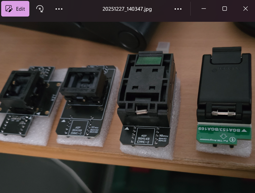

and accept to test the very latest two BGA153/169 adapters, cheaper ones with only one format, not 3 or five with different
size adapters provided as previous.
And all those adapters fail the simple read test with H26M62002JPR, except adapter number 4, that is, currently, discontinued.
Hoppefully, or they update the software, and or firmware, a new hardware adapter, discontinued for T56 is needed to read this IC. Lets wait to see the development. I've sent them all picture tests from failure and sucess.
Best Regards

             Some news for you, anyway , maybe not the one you expected, neither myself, but is what it is so far....
Using my adapter, same as yours, got same inititialisation error return code,
but, as i've told you, T56 have several adapters to read BGA153, and have it here and tested both and it works with latest one
https://xgecu.myshopify.com/products/emmc-bga153-bga169-adapter-ic-socket-for-xgecu-t56-programmer-with-du
Maybe this help ADMIN to fix issue,  give a tip, or an answer that isn't expected at all....

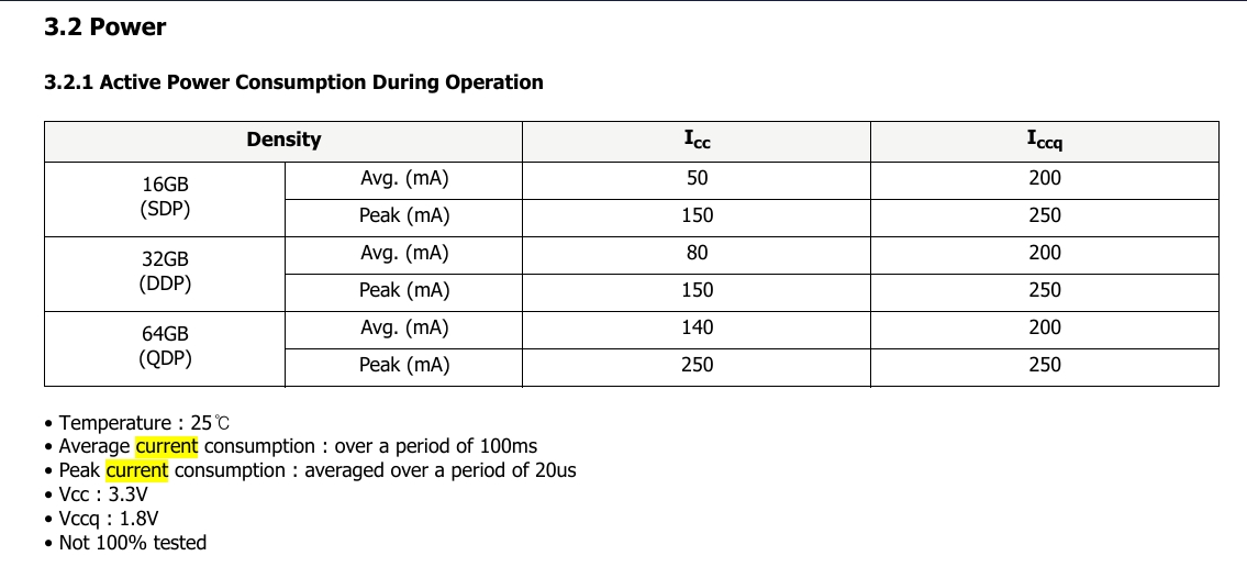

             Trying to see in datasheet https://datasheet.lcsc.com/lcsc/2204261415_SK-HYNIX-H26M62002JPR_C3002776.pdf  if any helpful info is there, but so far do not yet  find a reason. Hopefully it can be fixed for you, or if bad ICs, or any software limitation that prevent read, but that shouldn't occur in new, but never used Ic.
In the mean time, found this info that can be relevant, that may indicate that the IC draw a bit more current then default and need an adjustment of 'vcc current imax' ...

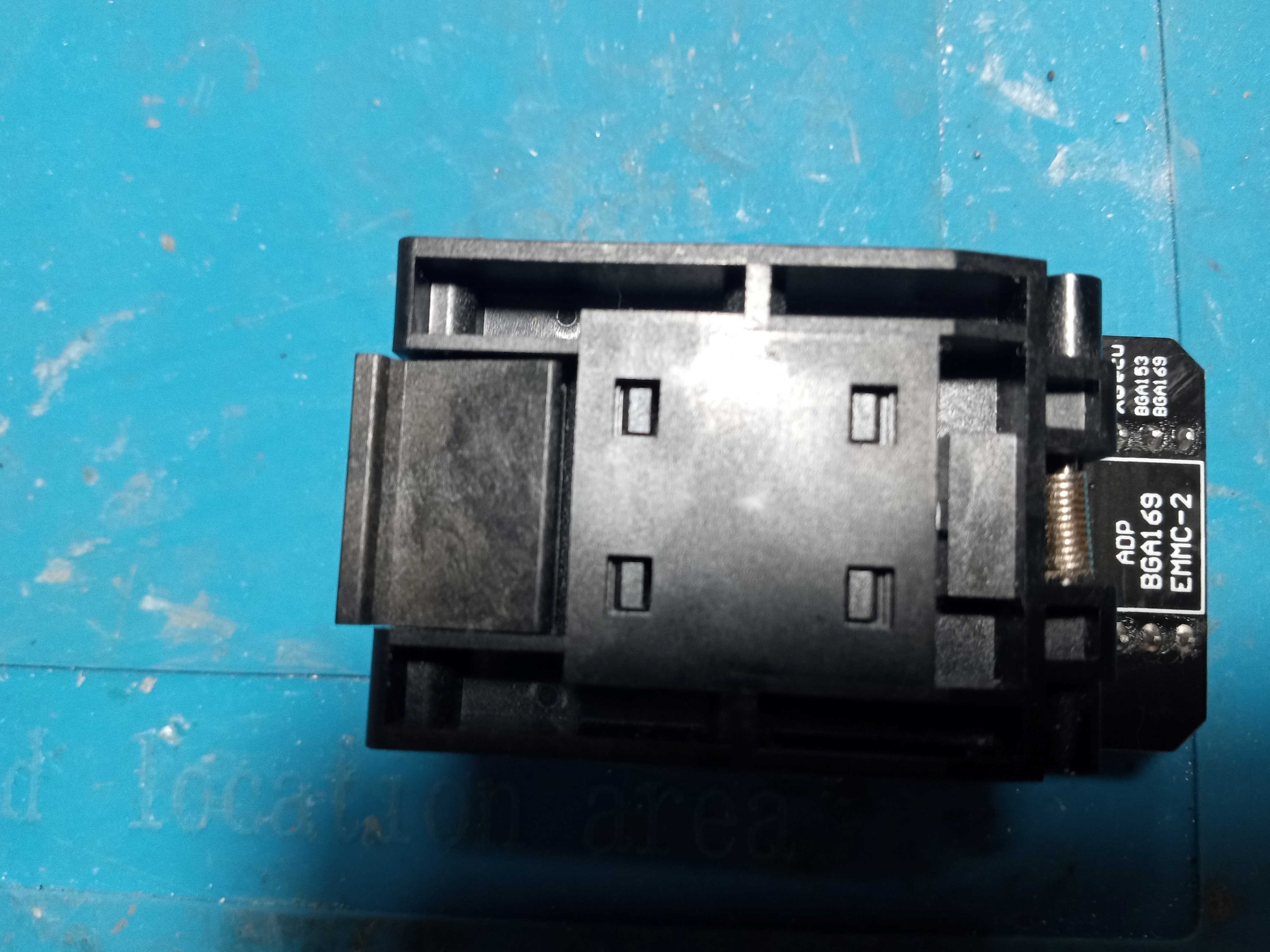

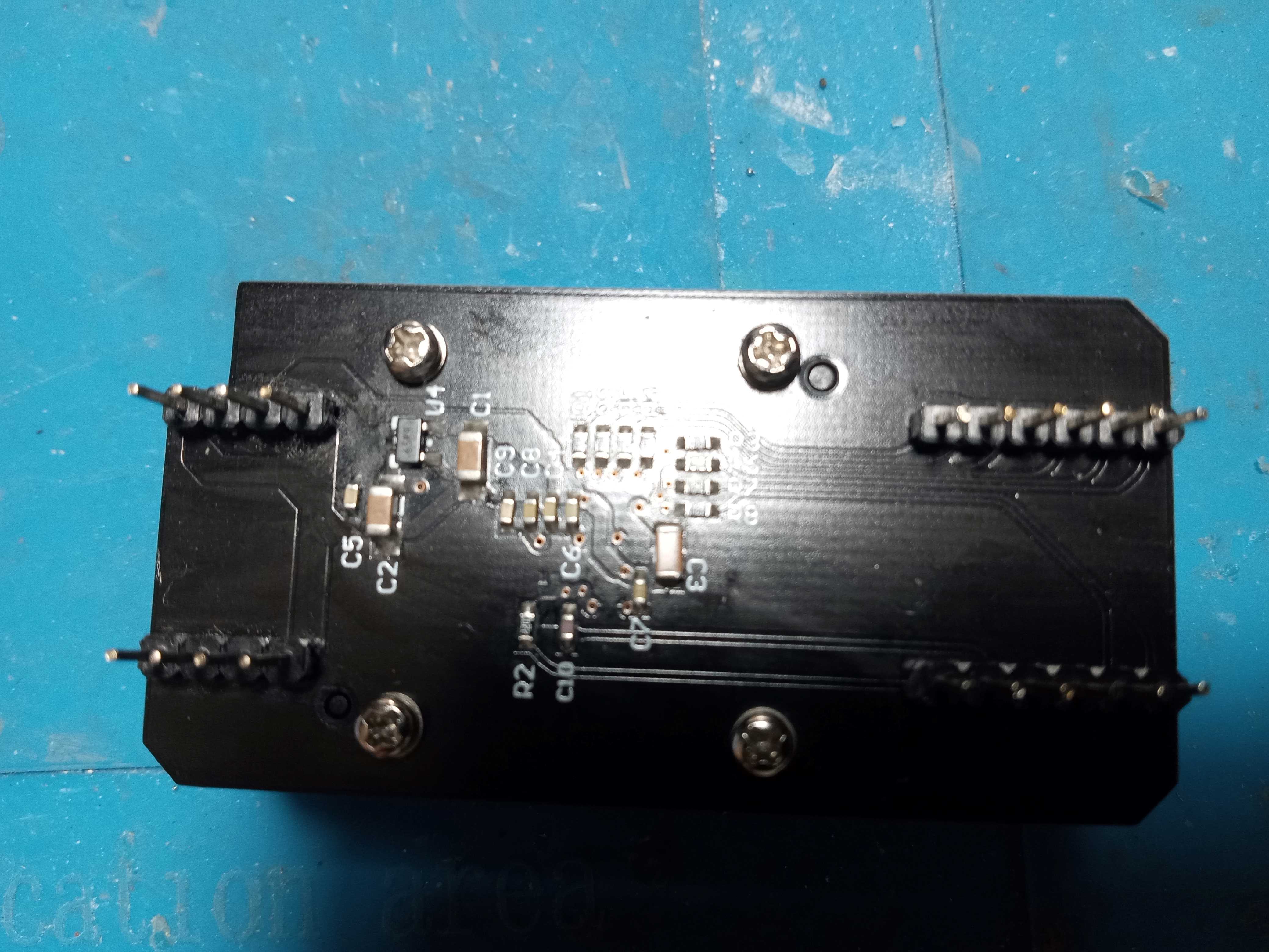

    Guessing again, Your adapter looks like mine, but i also have a newer adapter with Xegu socket on it for T56,but no MMC to test, yet, or test it in the T76, but no MMC , no test :-( I
Note:
In the options tab, a little scrolling down you have a folder path in file directory, to store files.
Check this if it is correct.
Hoppefully ADMIN will read this post and help!
Adapter BGA153
Adapter

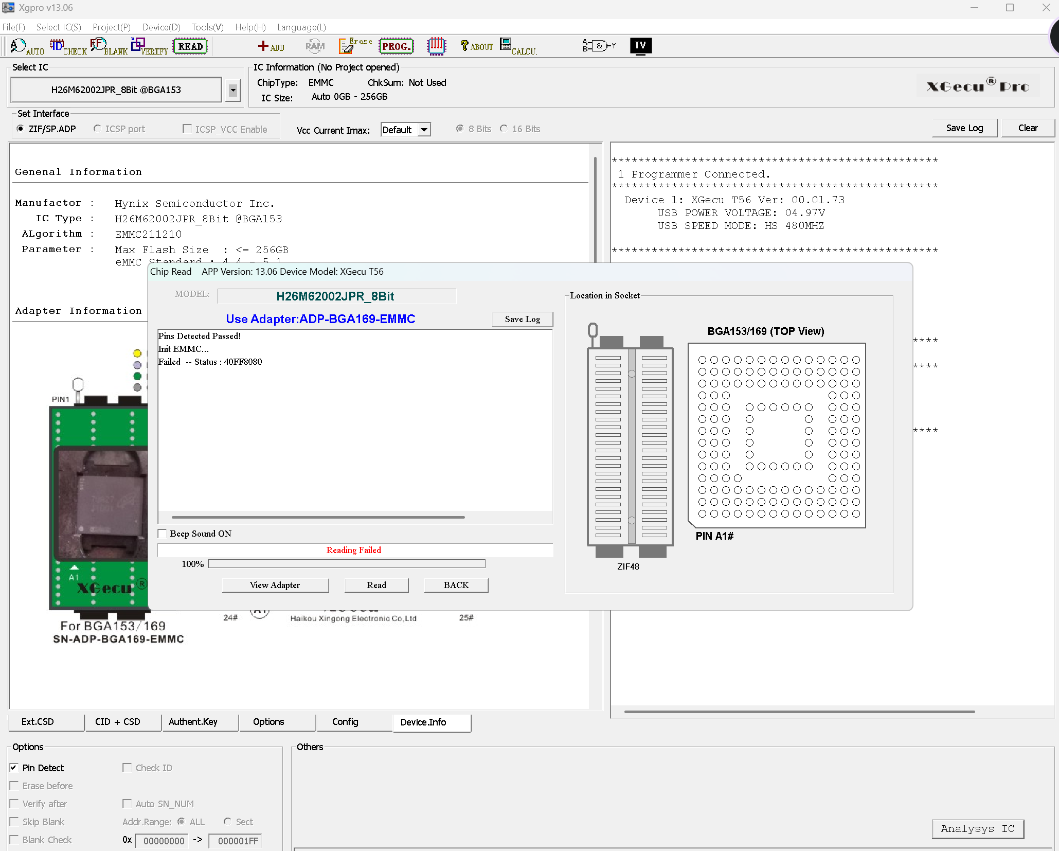

I am using an external 5v power supply, also I tried auto emmc (1 bit, 4bits, 8 bits) with same error, also I put a H26M52103FMR and reads and analyzed OK, so I know the device is OK. Adapter is XGecu BGA153 BGA169 (ADP BGA169 EMMC-2). Have anyone been able to read the H26M62002JPR with the T56?
This is the log one minute ago:
APP Version : 13.06   Model : T56  MFG:2022-03-06
     Device : H26M62002JPR_8Bit @BGA153
1 Programmer Connected.
  Device 1: XGecu T56 Ver: 00.01.73
       USB POWER VOLTAGE: 05.08V
       USB SPEED MODE: HS 480MHZ
  < Analysis  IC >
    Pin Detected Passed.
      * Clock Frequence is 8.000 MHZ   *
      1..Emmc Initialization ......
      Failed  -- Status : 40FF8080 ERROR CODE: 1

luzmina 发表于 2025-11-24 04:56
          As a user....Just guessing, are you using an Usb Hub to connect programmer cable?
The reason a ask, is the very low voltage, 4.7v on usb, usualy it show 0,2 to 0,3v when passing
through an hub, and T56 is a little sensitive with supply voltage below 4.9 with some IC's.
If yes, try connect direct to an USB port, or if not possible an hub with external power supply,
but connected to mains power.
Please better describe, detailed, with adapter, and also try other 'bit' options when
choosing ic, and which adapter you are using, post some photos, above and below, as some
adapters may need rework.
Hope it helps, or not... :(
