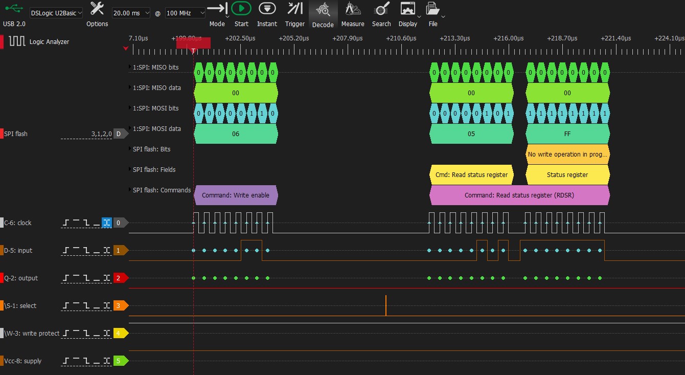

I have been trying to program a M95640-W for a while using ISP and the connections stated for the chip. I can read the chip but when I try to program the chip (just the status register) I get the reply during the verification phase that the programmed value is not identical to the one on the chip. Even though the xgPro program states the operation was successful.
I have connected a logic analyzer to debug the communication. I can see that a WREN (Write enable) operation is send, but it is followed by a RDSR (Read status register) operation, while I expected a WRSR (Write status register). What am I missing here?

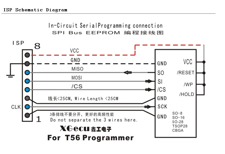

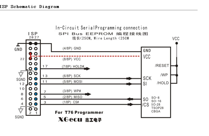

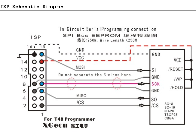

Hello, voltage can be stable for M95640W, from 2.5 to 5.5v, but 'stable'
as per datasheet, but in circuit with other ICs can be higher or lower....
[attach]2277[/attach]
You can see that they recommend lower then 25cm... For T76, T56 or T48, and recommendations
for clock lines....
Screenshot 2025-03-21 143857.png Screenshot 2025-03-21 144058.png Screenshot 2025-03-21 144220.png
You show, in the proto board the IC in an adapter that may fit the programmer socket directly,
then length cables at the lowest :-)
If any software change that may help you, hopefully Admin read this, and implement.
Rgds

   Hello,            If the problem is created by cable length, and excessive 'parasite' capacities,
reducing speed of communication, may help, or not. Having all cables, with similar
length to avoid protocol timing corruption. Then i recommend use some adapters
that are like 4pcs for Sop8 Soic8 chip download burn write probe spring needle flash eeprom chip burner cable Sop8 Soic8 chip - AliExpress 13
or 1PCS TSSOP8 MSOP8 PCB chip burning test fixture probe download programming cable - AliExpress 13
chip case dependent, anyway , some of those adapters do have excessive cable length, but can have easily
modified. Also, the xgecu program, allow for T48-T56-T76 programmers  that initial surge
current to be changed, to accommodate 'in circuit' use, it may fail first try, but almost work
second time, with voltages stable.
Hope it helps

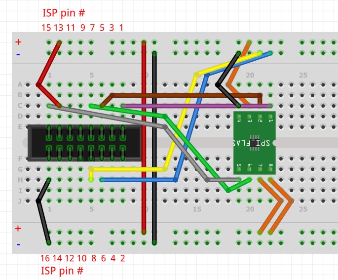

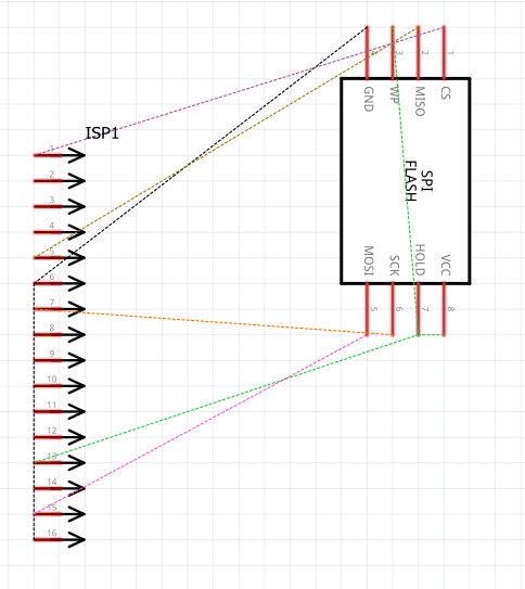

I have added some images that hopefully should explain what I am doing. I am trying to program the status register to see the operations. However, I can see that I am missing the WRSR (Write status register) operation after WREN (Write Enable)
M95640-W breadboard connection - no test connections.jpg (104.45 KB)
Fitzing layout
M95640-W schematic connection - no test connections.jpg (49.33 KB)
Schematics
Logic analyzer - Program status register.jpg (178.5 KB)
Logic: write status register
