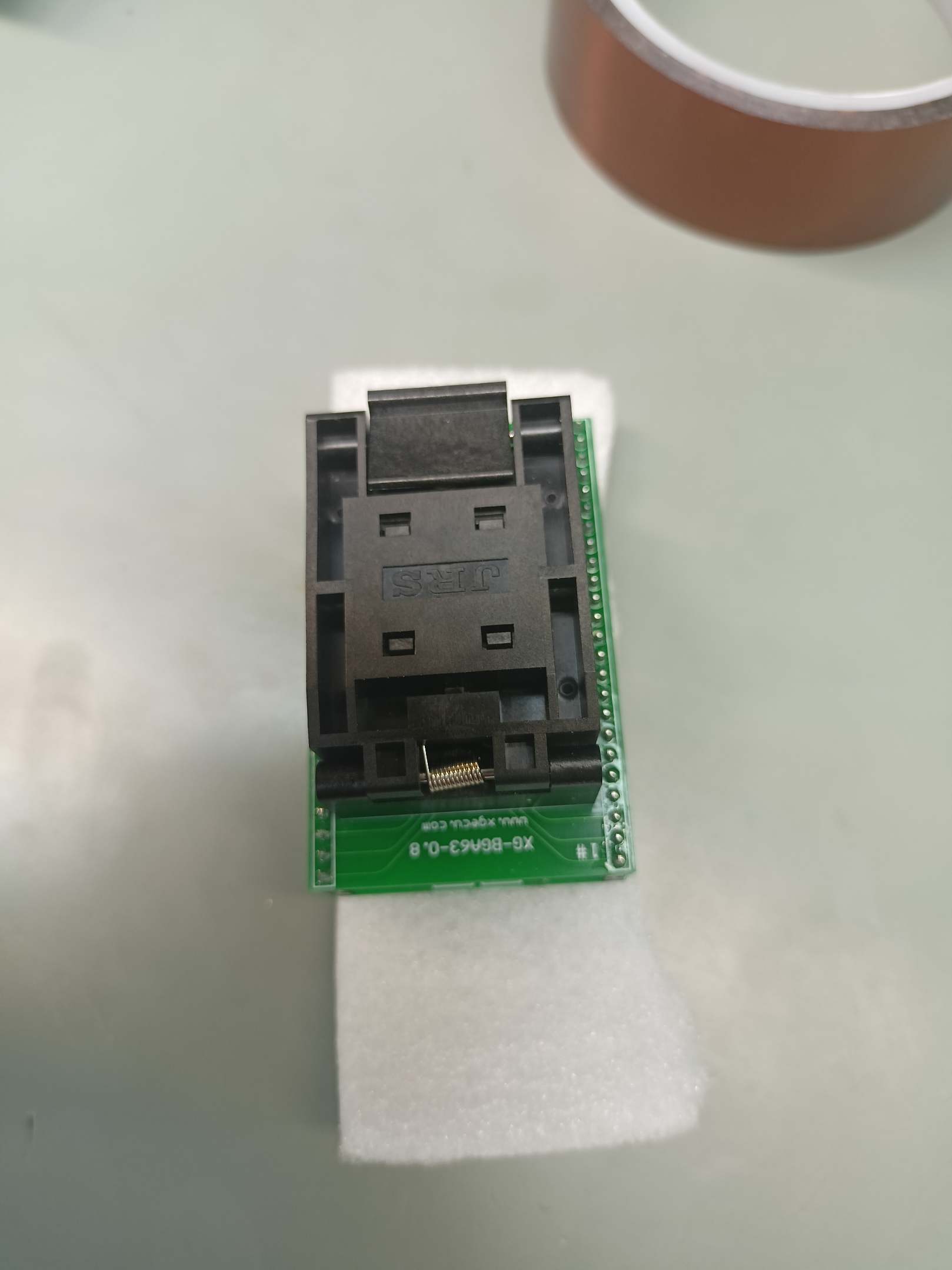

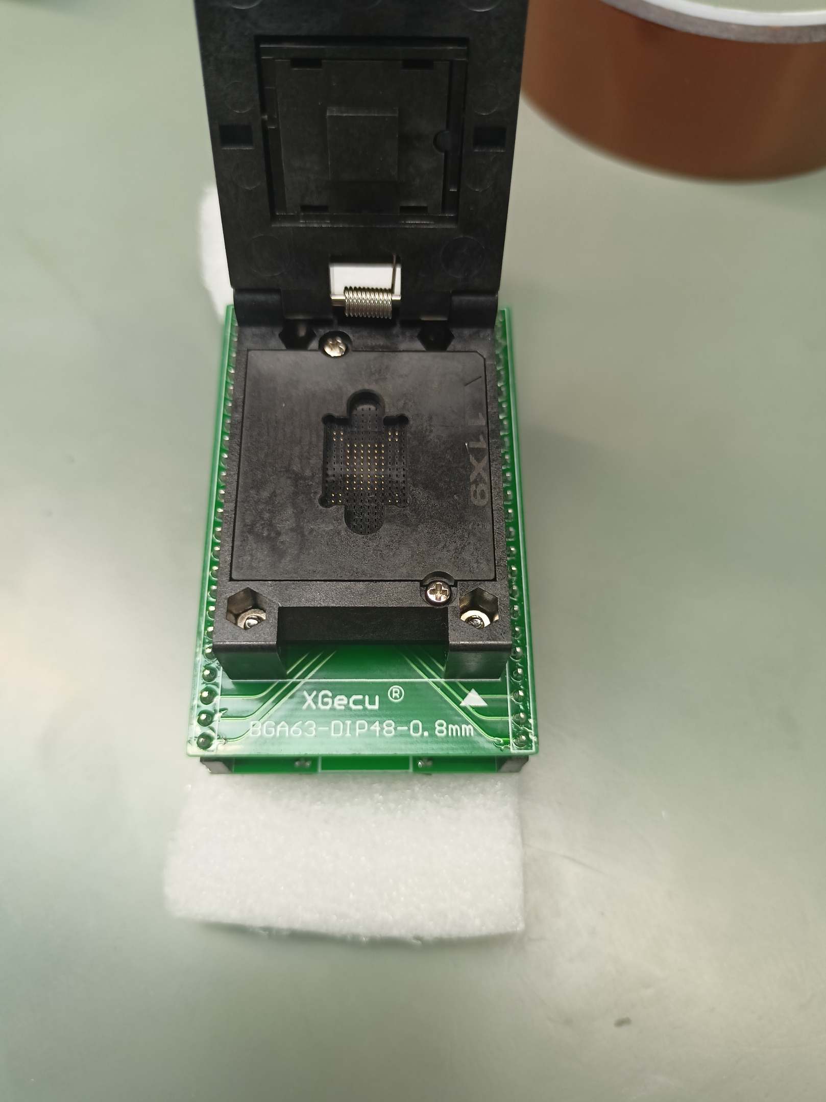

Hello, Thank you for share your findings and experience. Please post the pic of your adapter,
as 3 already exist for T56. Maybe Admin correct it , hopefully. :)

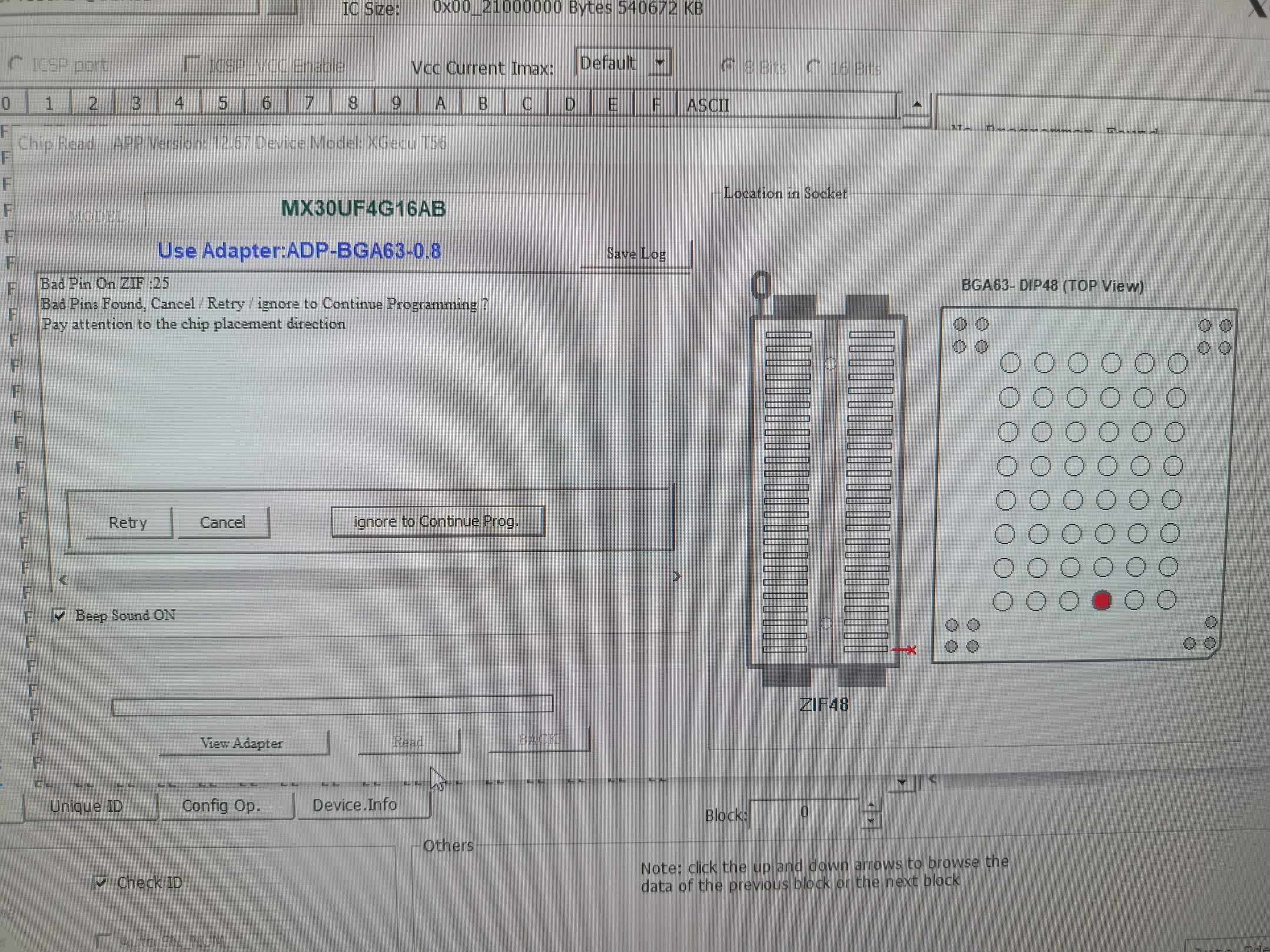

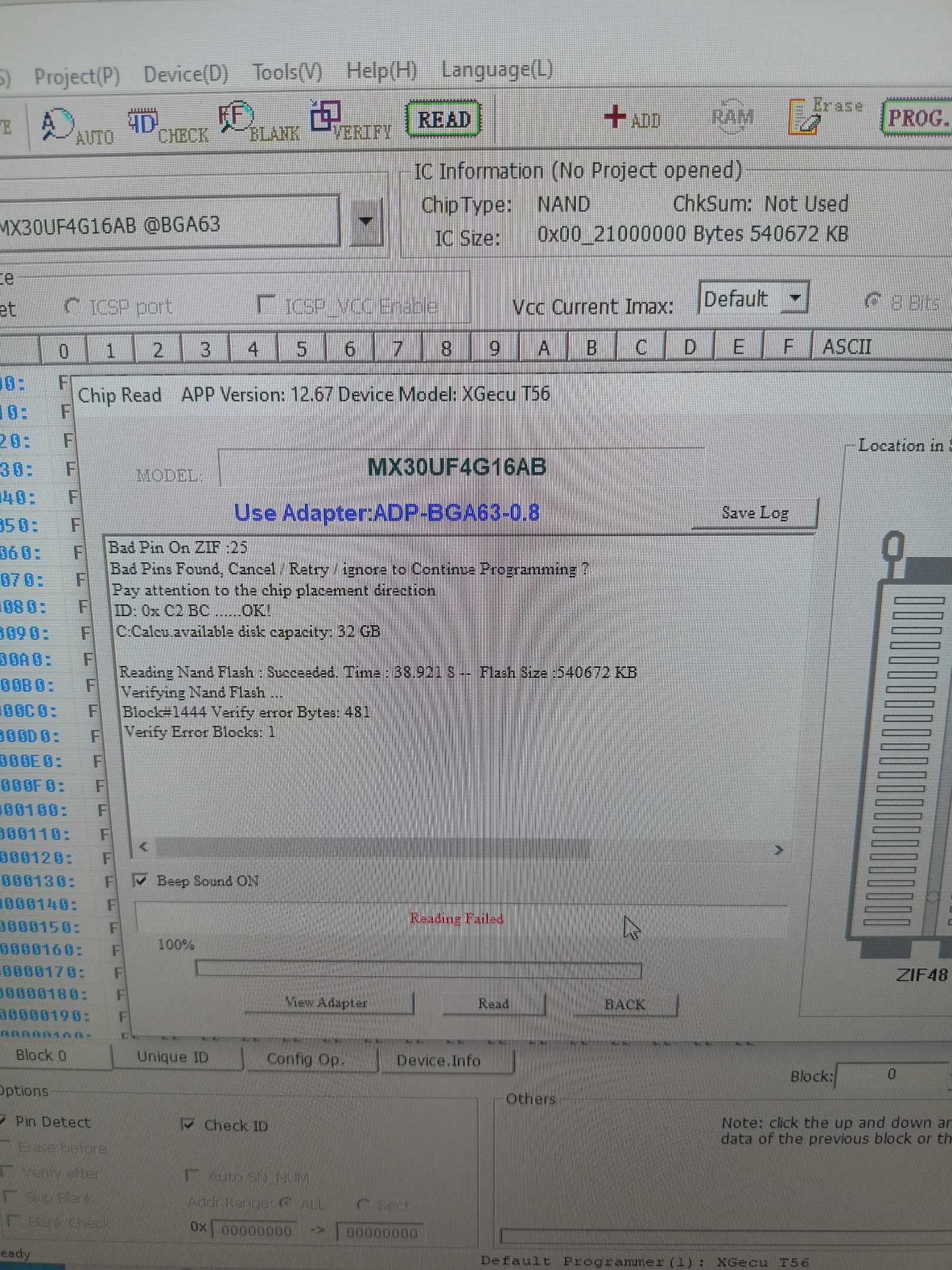

Albano I tested, unfortunately came across 2 faulty chips, which gave errors in different places. Were replaced with new ones, but the contact error on them remained, just ignored, or make a jumper on gnd according to the connection compression of the adapter contact (only for this series chip)
Albano hello, I use the latest version of the software, adapter, rang, all contacts are working. This contact on the chip does not ring anywhere, in my opinion this is the ground contact, I forcibly made a jumper to another ground contact, the error in determining the contacts disappeared, but nothing changed, the dump also remains empty (FF). Why there is only one error in the log I do not know, most likely the code for working with this chip is not finished. The chip is working, fully works in the device and does not fail. I do not understand why the programmer support does not respond to problems. I have another programmer, not xgcue, it reads this chip, but with errors, tech support advised me to read the documentation and play with delays.

Dear Dmitry,
Try latest known software HTTPS://www.hklrf.com/Downloadfile_59.html ,
with some corrected ICs. Why? You got one error with one address lines, you should got
multiple errors....
Anyway, if not help, please post your adapter, clean it ( just in case), if adapter socket is removal
capable, clean everything. No Good? Wait as T76 is almost out and a new software will appear.The IC used maybe have bad sector...
