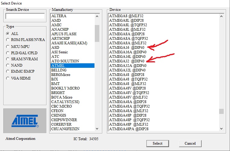

Good afternoon! Please add for the adapter QFP44_EX1 QFP44 K DIP40(3 in1) (only T48) the ability to program ATmega16, ATmega32 in the TQFP44 enclosure. Thank you.

回复 5# gsyanan
在T48/T56 上已经支持了
