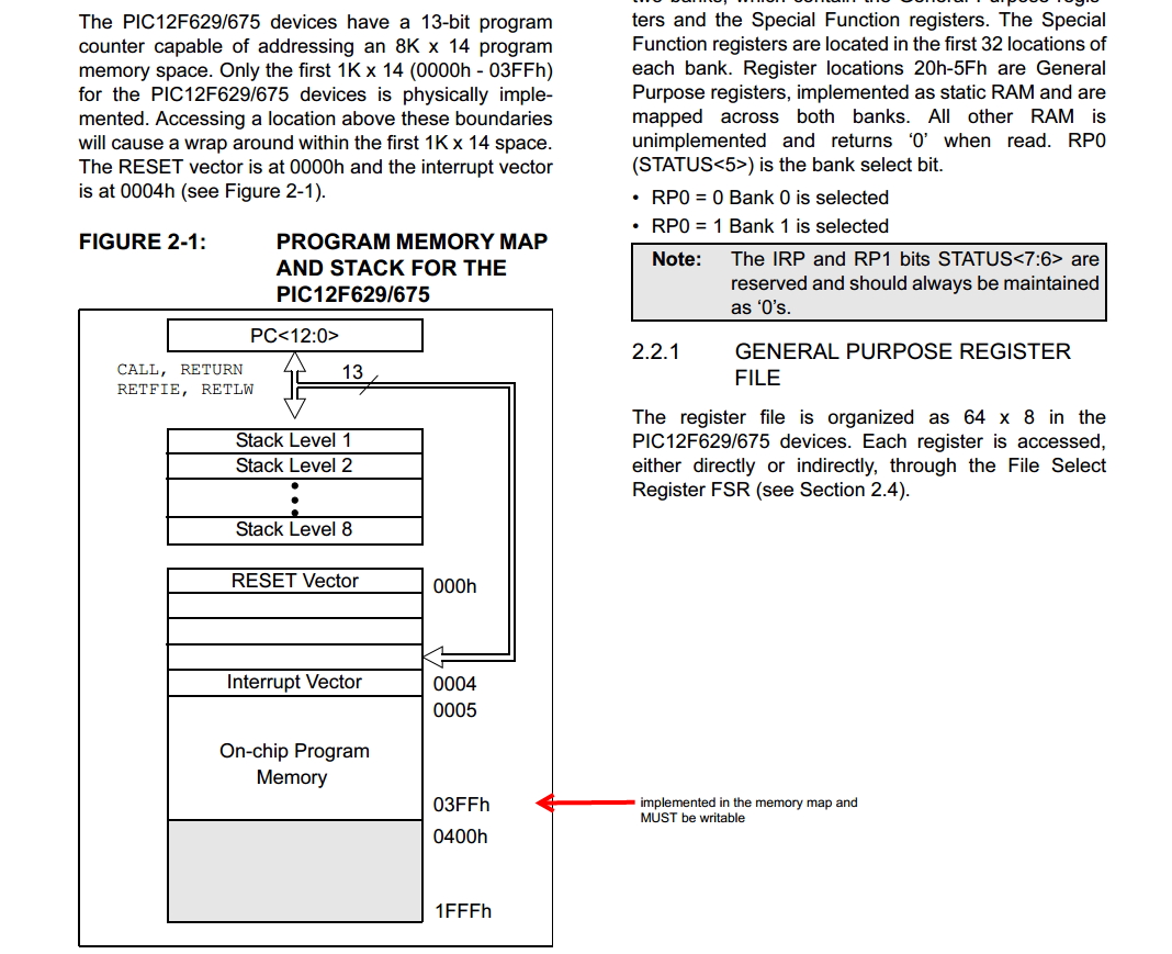

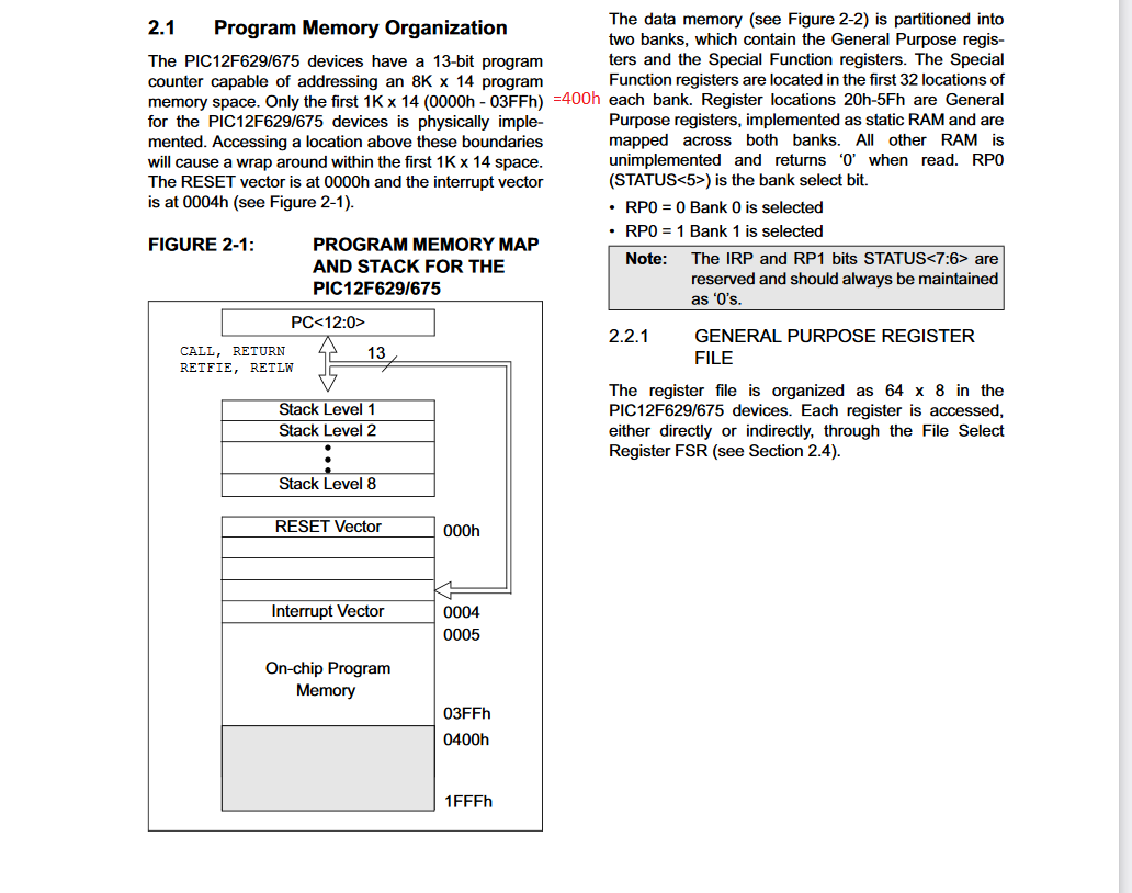

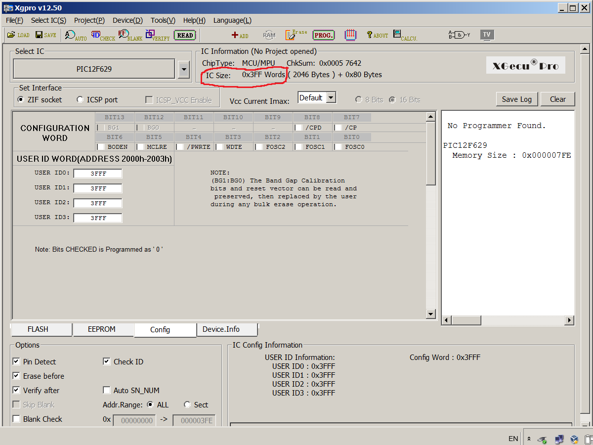

Xgecu-48 programmer, I found 2 errors. The first - PIC12F629(675) has a memory size of 0000h-03FFh = total 0x400. But the programmer says that the total memory is 0x3FF and my compiler cannot write to cell 0x3FF The second - I can not erase the PIC12F629(675)  with the installed FUSE - СPD and -CP set in the configuration word. Can I get the corrected software?

1.0x3FF is oSSCAL word.
2.There is a BUG with erasure  when CP/CPD programmed, which will be corrected in the next version

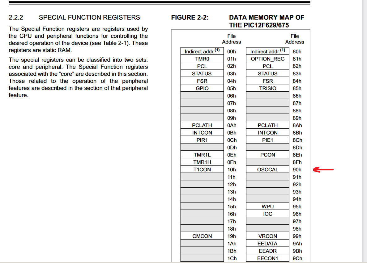

You are wrong. Cell osccal = 0X90h
I have been programming PIC12f629 for a long time.
CCS PCM C Compiler, Version 4.130, 5967               02-ÿíâ-23 15:02
               Filename: D:\PIC_Proj\Level\main.lst

0004:  CALL   3FF  // <--------------------------- jump to 0x3ff
0005:  BSF    03.5 //<-----------set Bank 1
0006:  MOVWF  10 //<-------------- mov to osccall (0x90h) W

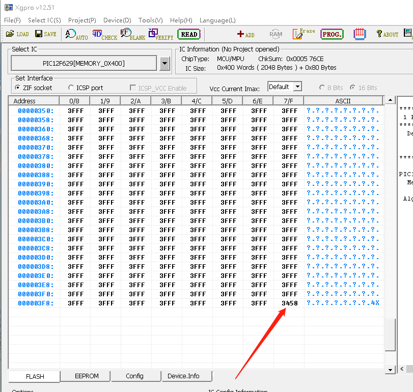

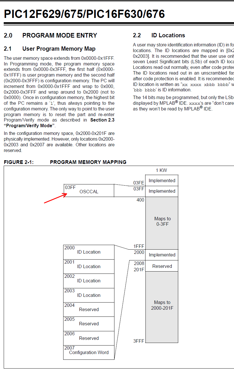

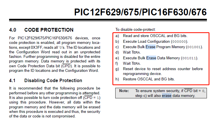

This instruction(calibration of the internal oscillator) is a  RETLW XX at addrres 0x3FF. it was factory programmed.
The location of this memory is reserved.
I did a test to read on a new chip.

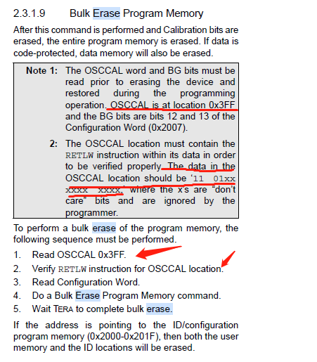

The programmer need to Read and Save  it( OSCCAL INSTRUC at 0x3FF) when erase code memory.
Please read:41191D.book (microchip.com)
PIC12F629/675/PIC16F630/676 Memory Programming
If overwritten by other programmer, the internal clock will not be able to be calibrated.

Exactly! So what to do if 3FF is erased?
T-48 does not allow you to write 3FF.
PIC12f629 read by another programmer and saved as BIN cannot be written using T-48.
But 3ff is implemented in the memory card and must be writable
3ff stores the VALUE for the register, but it's not register OSCCAL
The internal clock is calibrated with a couple of lines of code.
BSF    03.5
MOVLW  0x3b //------ any value for osccal
MOVWF  0x10 // ---- load osccal

This is not a good idea. if let T48 write 0x3FF.
1. normal , MICROCHIP does not allow erasing the 3FF value . and  it cannot  be overwriten without erasing
2.If erased, a large number of chips may be scrapped during normal batch production.
3. If the clock is calibrated no using the original factory method, do not use 0x3FF(CALL 3FF).
4.Theoretically, if 3FF is erased by other programmer, this chip is a discarded chip.
This is a temporary upgrade, about CPD/CP of PIC12F629。
I tested three chips, and one chip couldn't be erased anyway. I think one of them might be broken.

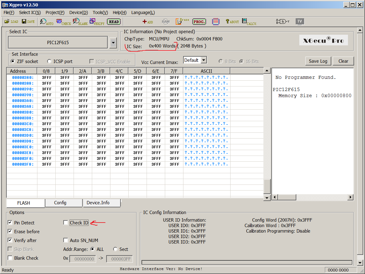

Are you suggesting that perfectly usable chips be thrown into the trash?
Other programmers write them using the checkbox to write 3FF.
In the current situation, I am forced to select PIC12F615 and turn off the id check in order to write PIC12F629
But it's not right.
