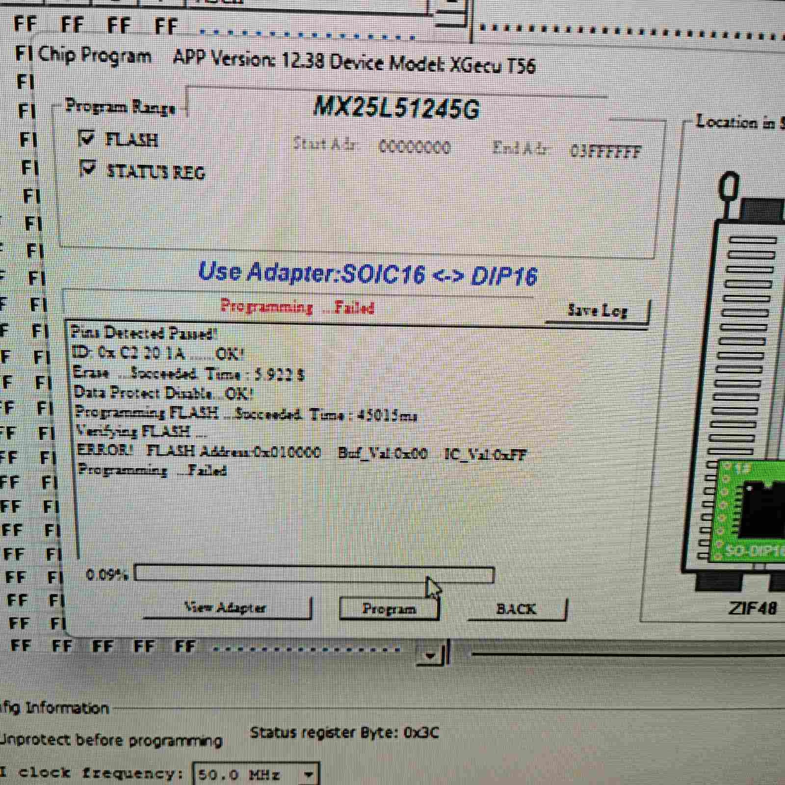

i buy new mx25l51245gmr but when i try to write i have error to write it why i cant write? programmer issue?

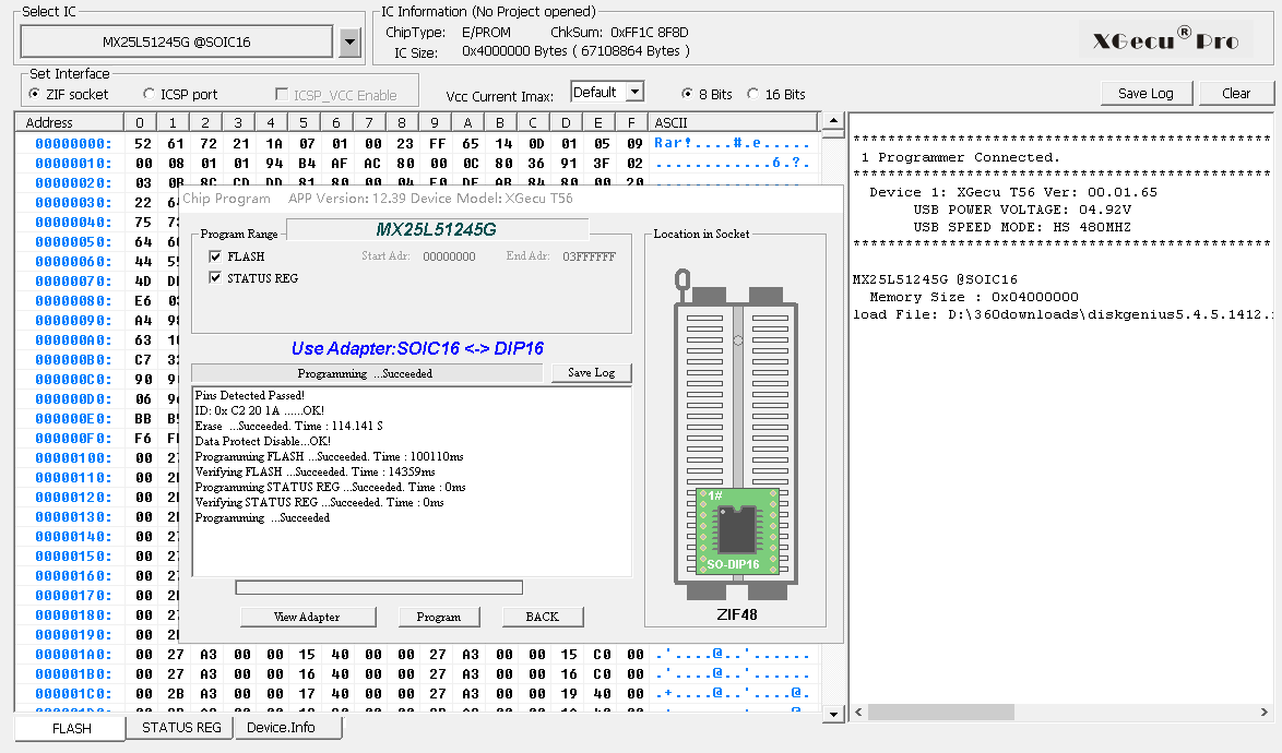

demetris11
(54.93 KB)
2022-12-17 17:46
I tested it ,all is normal.
1. self check programmer and upload result picture.
2.erase time is not right. my testing is 141s ,your testing is 5.9s.

发表于 2022-12-18 15:18
what i make wrong?

发表于 2022-12-18 15:33
tell me please what i make wrong? i cant erase it to write it

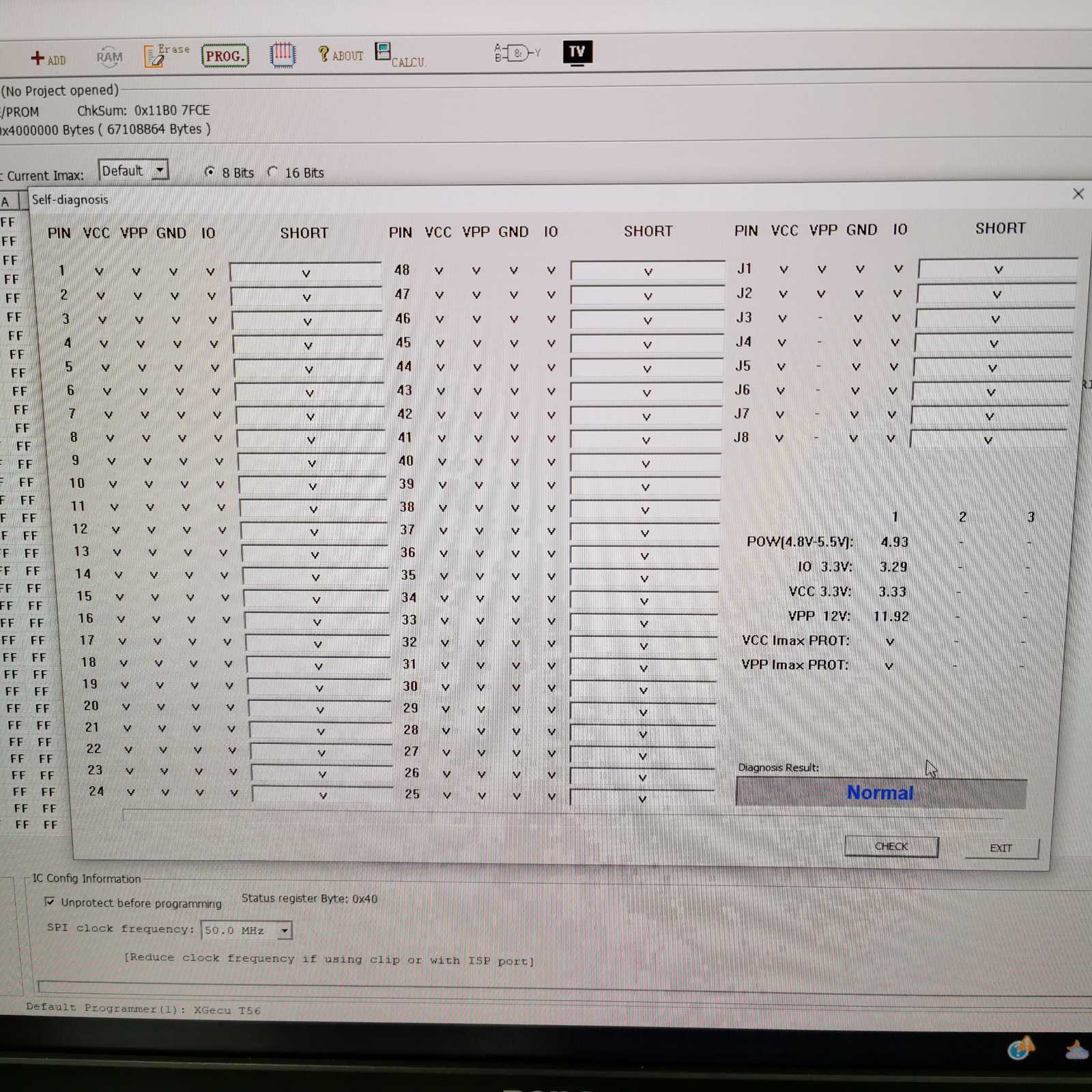

发表于 2022-12-19 13:17

发表于 2022-12-20 08:41
6#
demetris11
The programmer is normal .
1. Replace adapter and IC to test.
2. test on another compter.
3. Use the original USB cable.
4. all 25's IC use same hardware. If the other 25 chips work normally, the programmer hardware is no problem.
