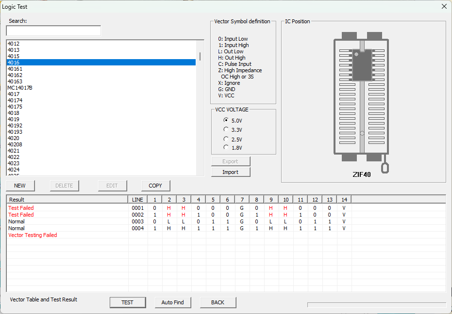

Share my new logic tests:

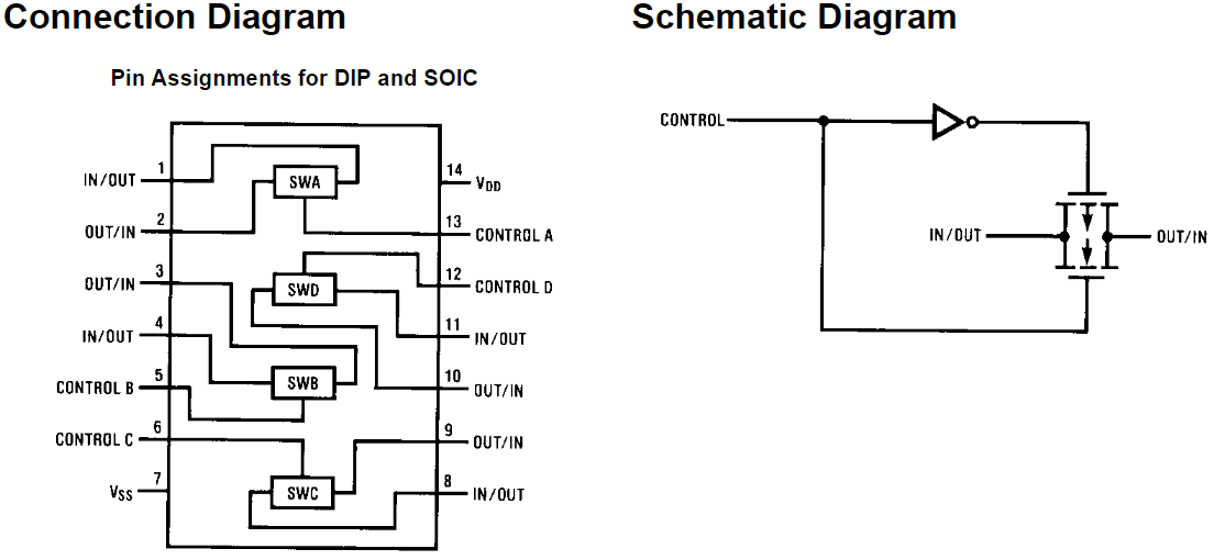

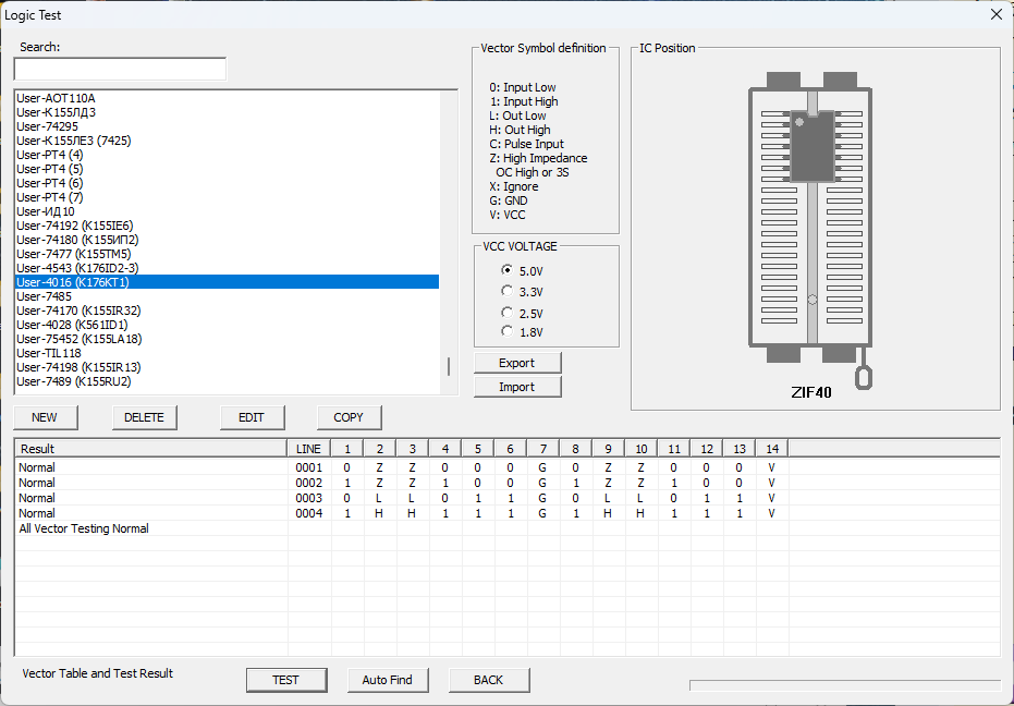

1) 4016 (К176КТ1), test in programmer is false (when "Control=0" pin 5,6,12,13 -> In/Out = Z (OC))

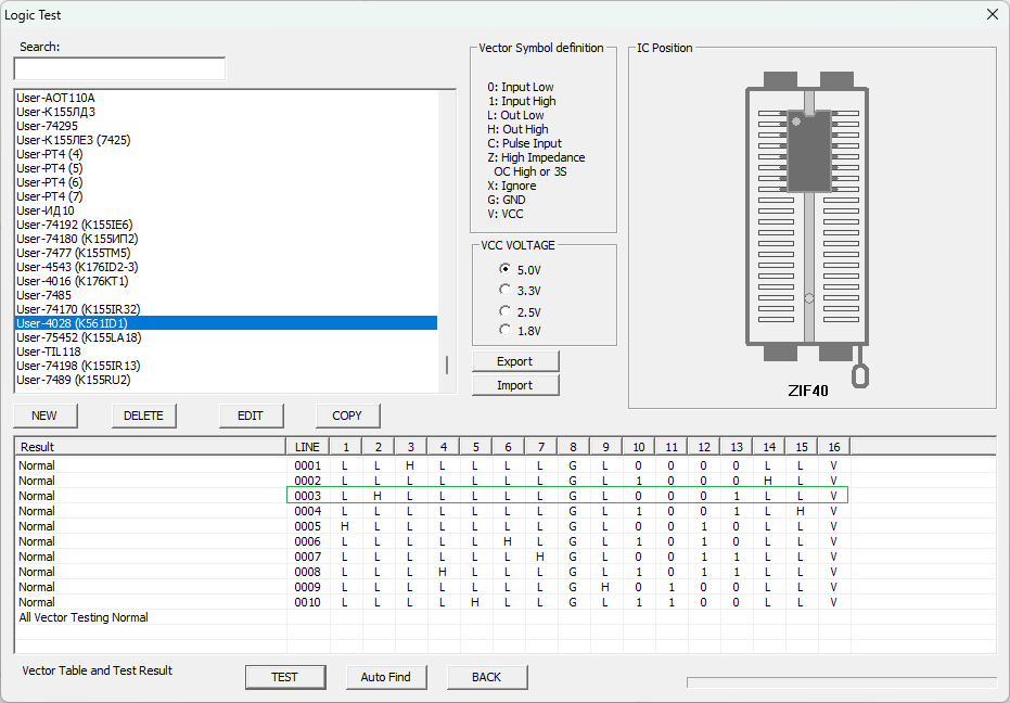

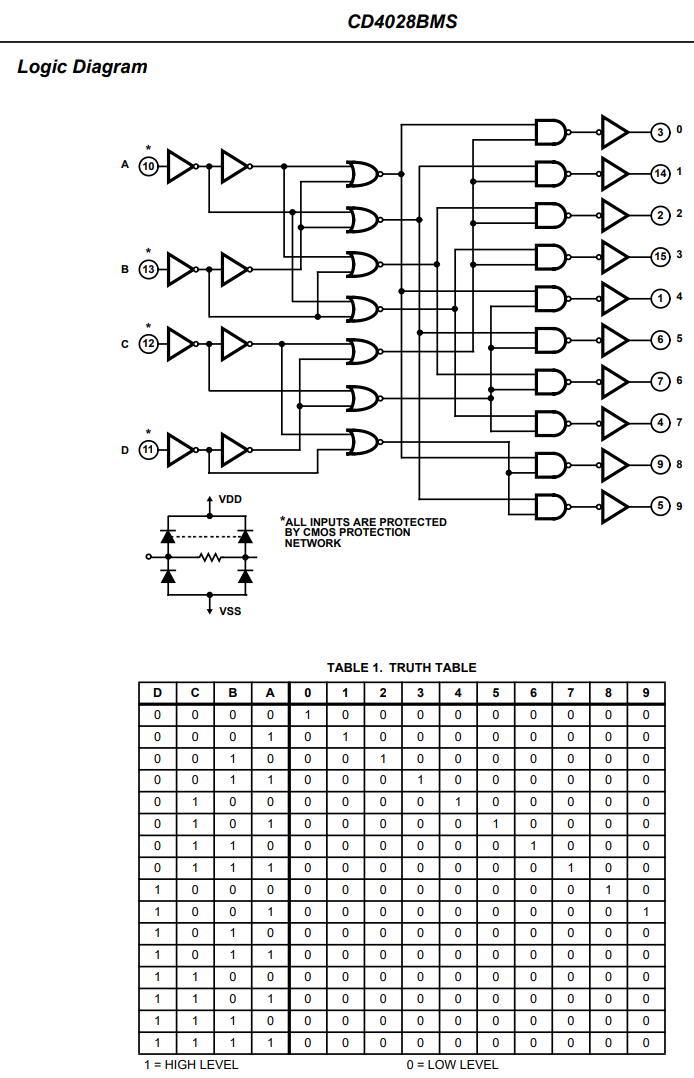

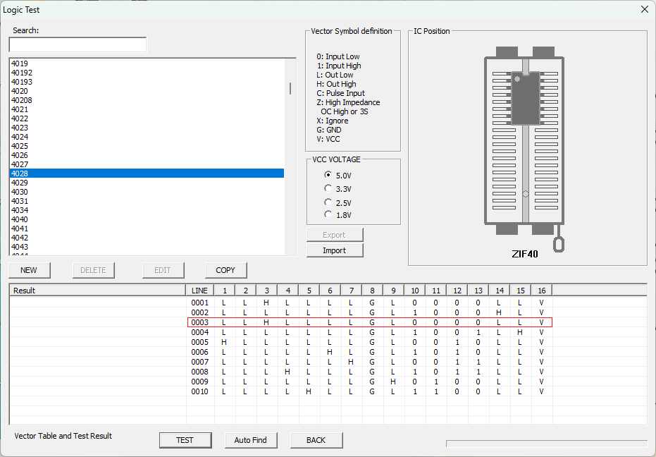

2) 4028 (К561ИД1) error in a prog.test, "line 3"="line 1"

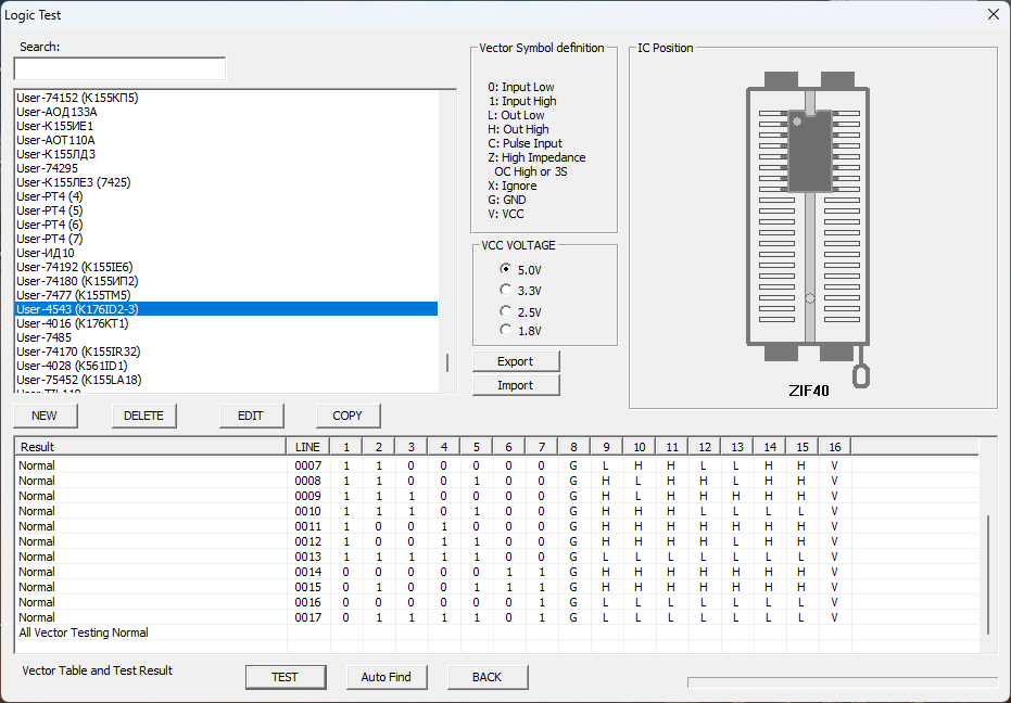

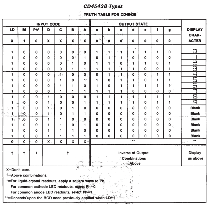

3) 4543 (К176ИД2),
more complete test

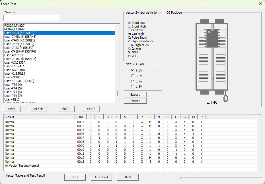

4)7453 (К155ЛР3)

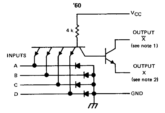

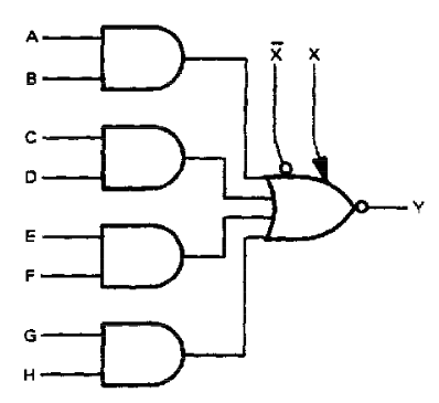

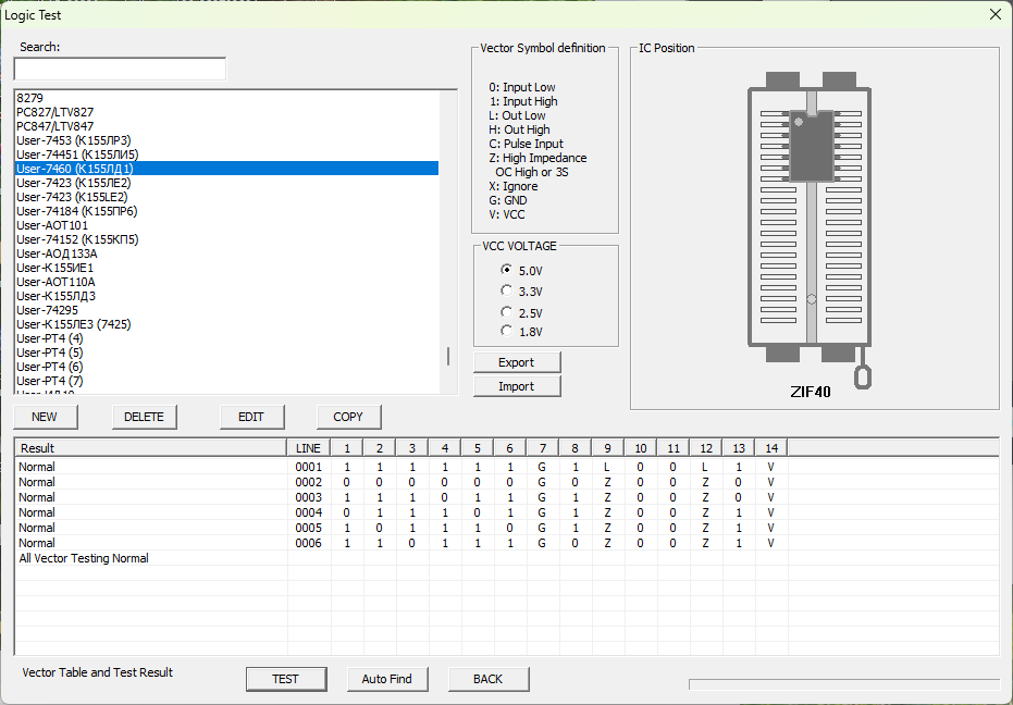

5) 7460 (К155ЛД1) Correct test

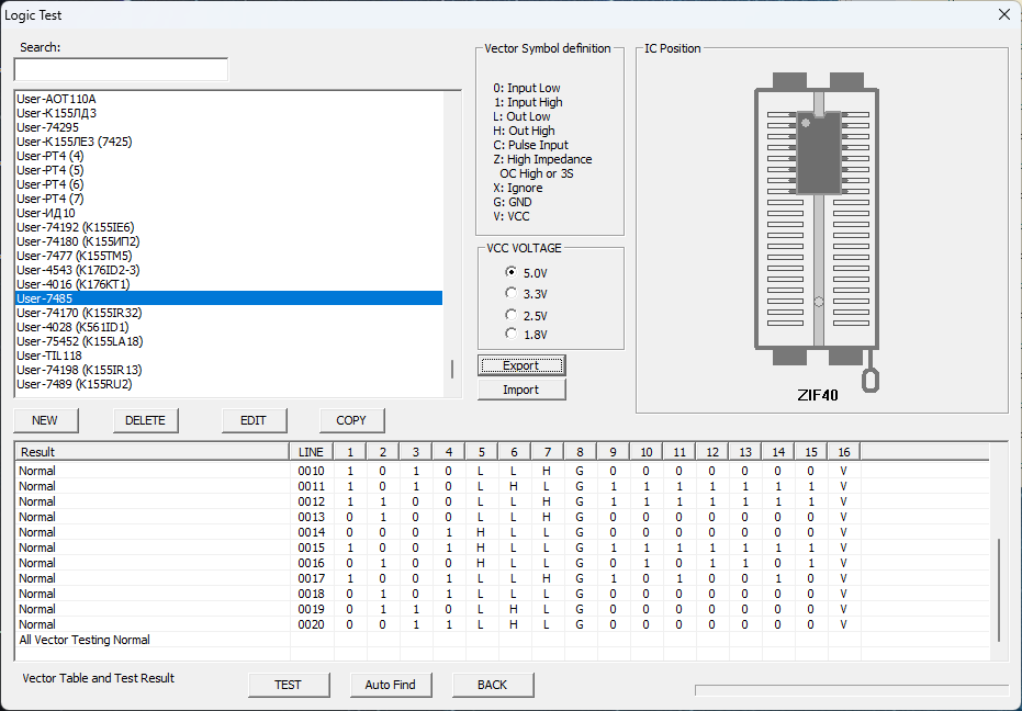

6) 7485 Full test

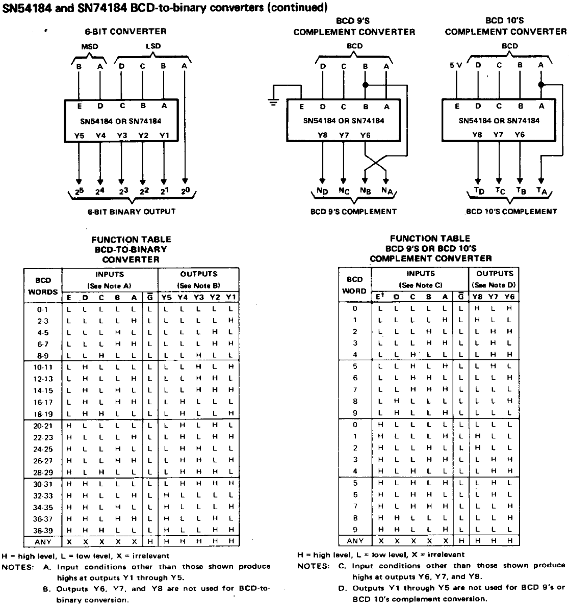

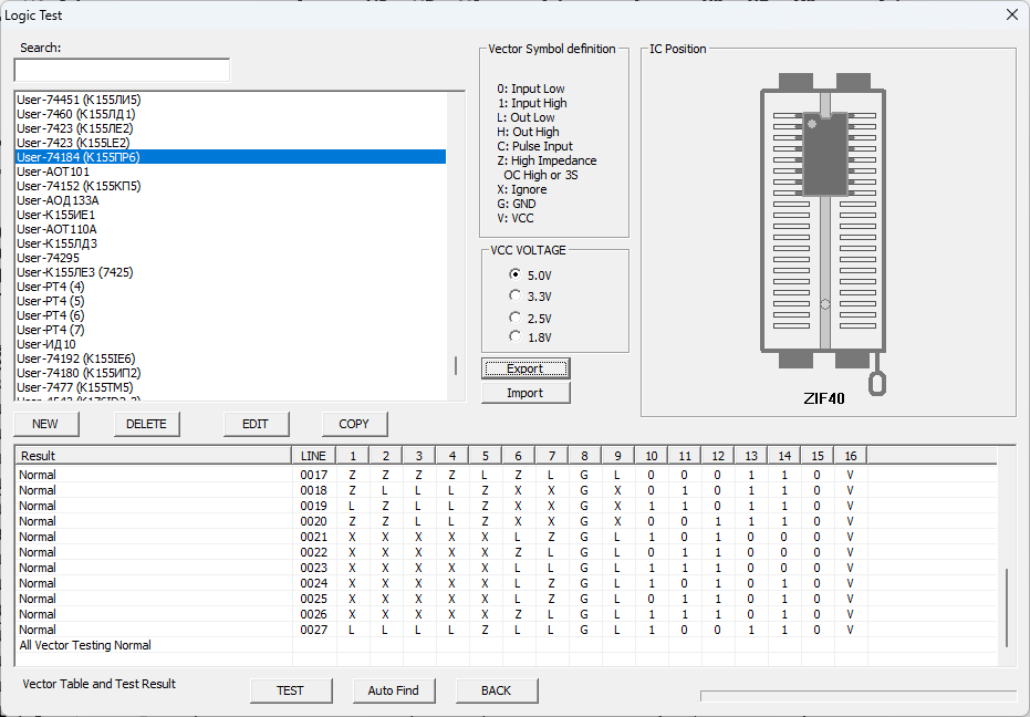

7) 74184 (К155ПР6)

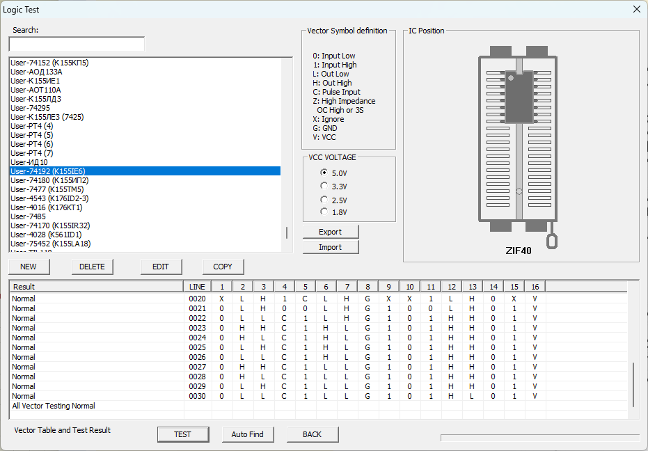

8) 74192 (К155ИЕ6) Full test

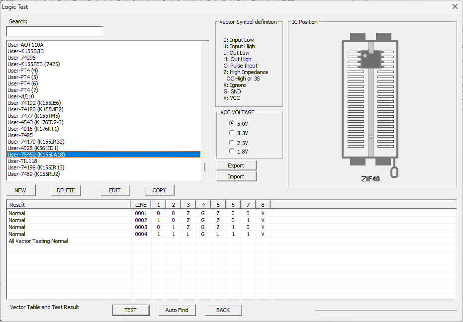

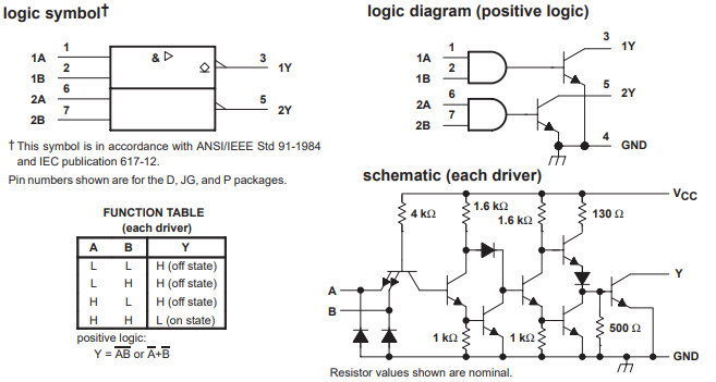

9) 75452 (К155ЛА18)
