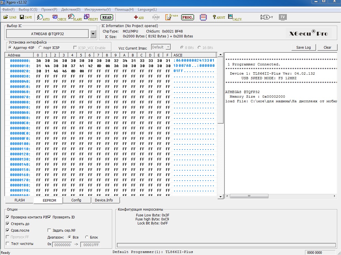

I am using TL866II Plus. The program does not correctly read the eeprom from the file. The program reads and writes Flash and config correctly, but not eeprom. This is how it started after updating from version 11.81
I also use the AVRDude programmer to flash atmega chips and I have no problems with it. AVRDude reads the flash and eeprom files correctly and the atmega flashed device works. And if I flash the atmega chip with flash and eeprom files with the XGPro program, then the device does not work correctly.
I am flashing atmega8, atmega16 chips in tqfp package.

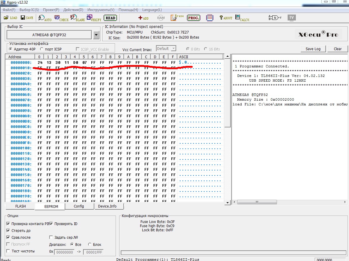

replaced the picture

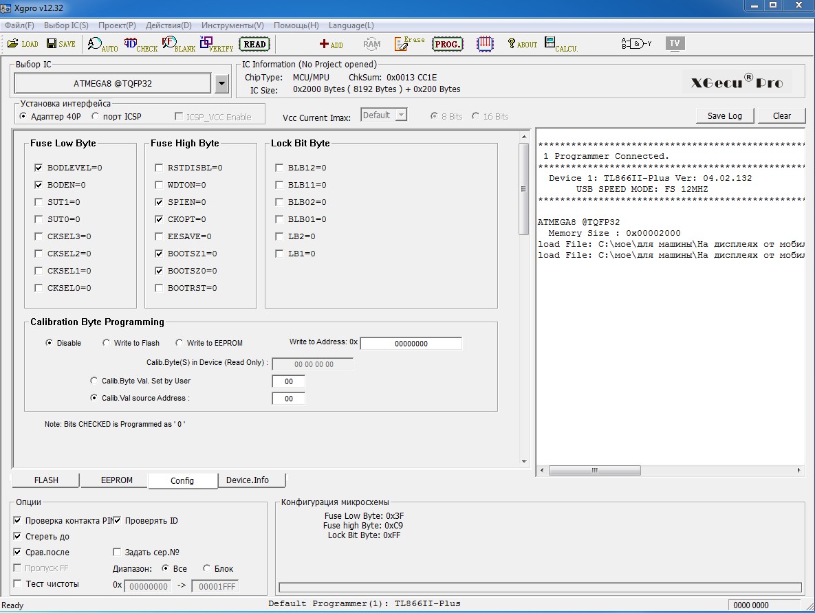

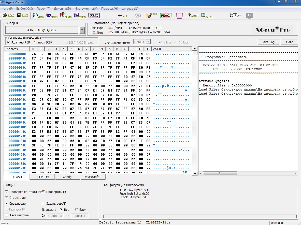

and
Скриншот 20-10-2022 175846.jpg Скриншот 20-10-2022 180528.jpg Скриншот 20-10-2022 180554.jpg

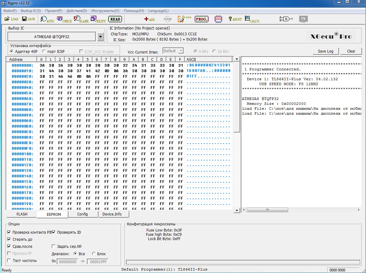

here is an example eeprom file that AVRdude reads and flashes correctly, but XGecu does not.
1.rar (108 Bytes)
this is how it should be right
this is the same eeprom read from the chip flashed by avrdude and it works correctly!
I can conclude that the program correctly reads the eeprom from the atmega chips, but the program cannot correctly read the eeprom from a file on the computer if it is not a .BIN file
