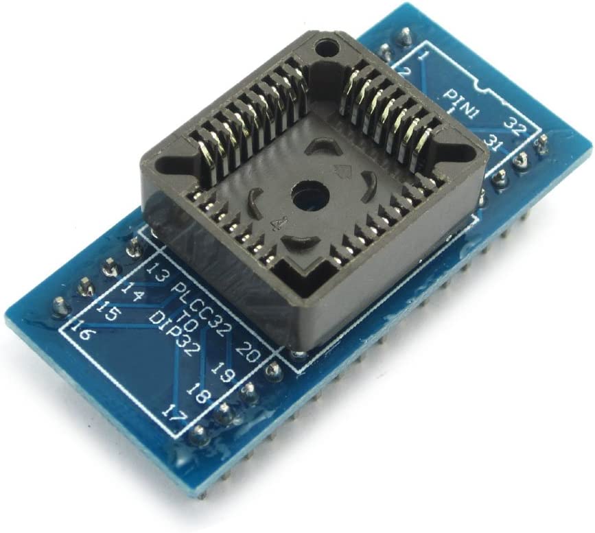

I have the TL866II plus and the T48, 2 PLCC32 to DIP32 adapters, I can't program any of my brand new devices AM27C010,  AM29F010B or SST39SF010A, the programmers sometimes write part of the devices but most commonly error is at address 800, I already damaged many 27c010 because they are one time programmable, I tried 4 different computers, windows xp, 10 or 11, 32 or 64 bits, why I'm having issues if they are in the supported list? I bought the devices from the distributors, no clones. Please help.
Best regards, vijo
Ps: they read fine and the ID also is fine

Also I noticed the 27c010 on the software  have 2 versions, DIP32 and PLCC32, the 27c010 only comes in DIP28 or PLCC32, so I suspect there is something wrong with the pin configuration. Or maybe I need a PLCC32 to DIP28 adapter instead the PLCC32 to DIP32?

1. 27C010 is not DIP28! only 32PINs IC
address 800 error ------> A11 pin is ...

Could be a bad pin, but is not supposed to let you know a pin is bad? I thought that was part of the features, I have pin check selected. Anyway I ordered a new adapter, arrives Saturday. Thanks.

Problem solved with AM29F010B, problem was the adapter, it was shorting some pins from the PLCC32 socket to the DIP32 pins, too near.

Also tested SST39SF010A, working good, PLCC32 to DIP32 adapter fixed.

Here is the adapter I purchased and I don't recommend:
The PLCC socket is too near the DIP pins and shorted. Junk.
