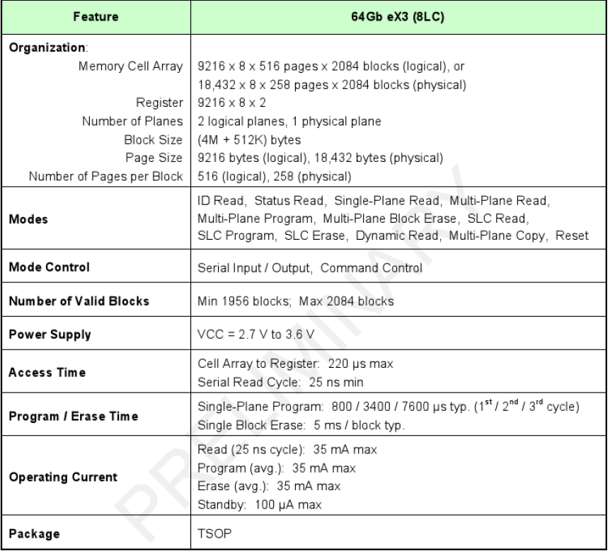

I have been trying to manually add a chip definition for the Sandisk SDTNPNAHEM-016G, but have had no success. I am using the settings gotten from the datasheet for the 008G model and increasing Page Size to get the larger chip.

Attached is the Technical Specifications of the 008G version.

Current Settings (Adjusted for the 016):
       PageSize :  16384
      SpareSize :  1024
Pages Per Block :  512
    Blocks Size :  8192KB + 512KB
   Total Blocks :  2084
    Device Size :  16GB + 1042MB
      Bus Width :  8
       nCE# Pin :  1
       nRB# PIN :  1
Is there anything that can be seen that I set up incorrectly in my settings, vs the datasheet?
