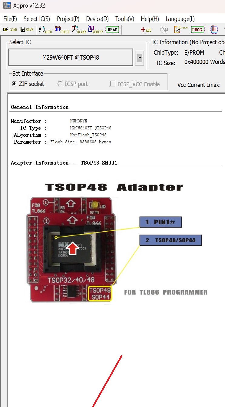

Не определяется  nand, пишет PIN detected.Нужен специальный ада ...
saishan 发表于 2022-10-27 14:29
    As a User:  I think you may need support for M29W640FT, but not for M29W460FT as you write it,just guessing.
On TL866II if the guessing is correct, the information for adapter needed is  in the tab Device info,
the base adapter is the one you need, you may need to remove the top adapter, and insert it in the
correct base adapter.
Post some pictures, may help
Best Rgds

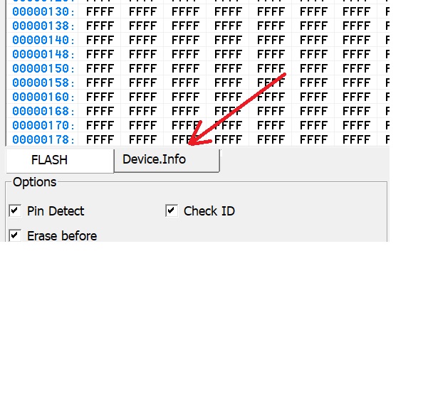

saishan 发表于 2022-10-27 16:59
   Hello Saishan,                        For this IC you will need the base adapter shown in the photo i've post, sorry.
Allways press Device.info tab to see the needed Adapter to avoid mistakes.
The top adapter is correct and can be used , but the bottom is not! you may found it
in the link Adapter - Shop Cheap Adapter from China Adapter Suppliers at XGECU Official Store on Aliexpress.com
or in a shop near your location.
Rgds
