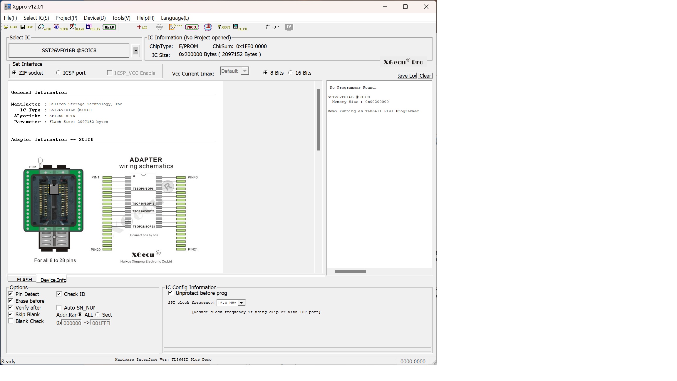

I have this chip that I am having weird issues reading.I have a xgecu tl866II-PLUS reader
waynehorner 发表于 2022-6-17 03:54
As an User....  I cannot see the images you post, but you describe the problem very well.Have you tried to lower/change the SPI clock speed at bottom right?
The 26V016B it's indeed an SST26VF016B , the JEDEC-ID shows correct, when it shows...
Hope you are using Xgrpro 12.01.
Other issues: Bad contact in adapter (Chip side or adapter side), usb cable faulty,
any lock the IC may have programed to avoid reading/copying ,
any software bug (if Yes, ADMIN will help, hopefully)
