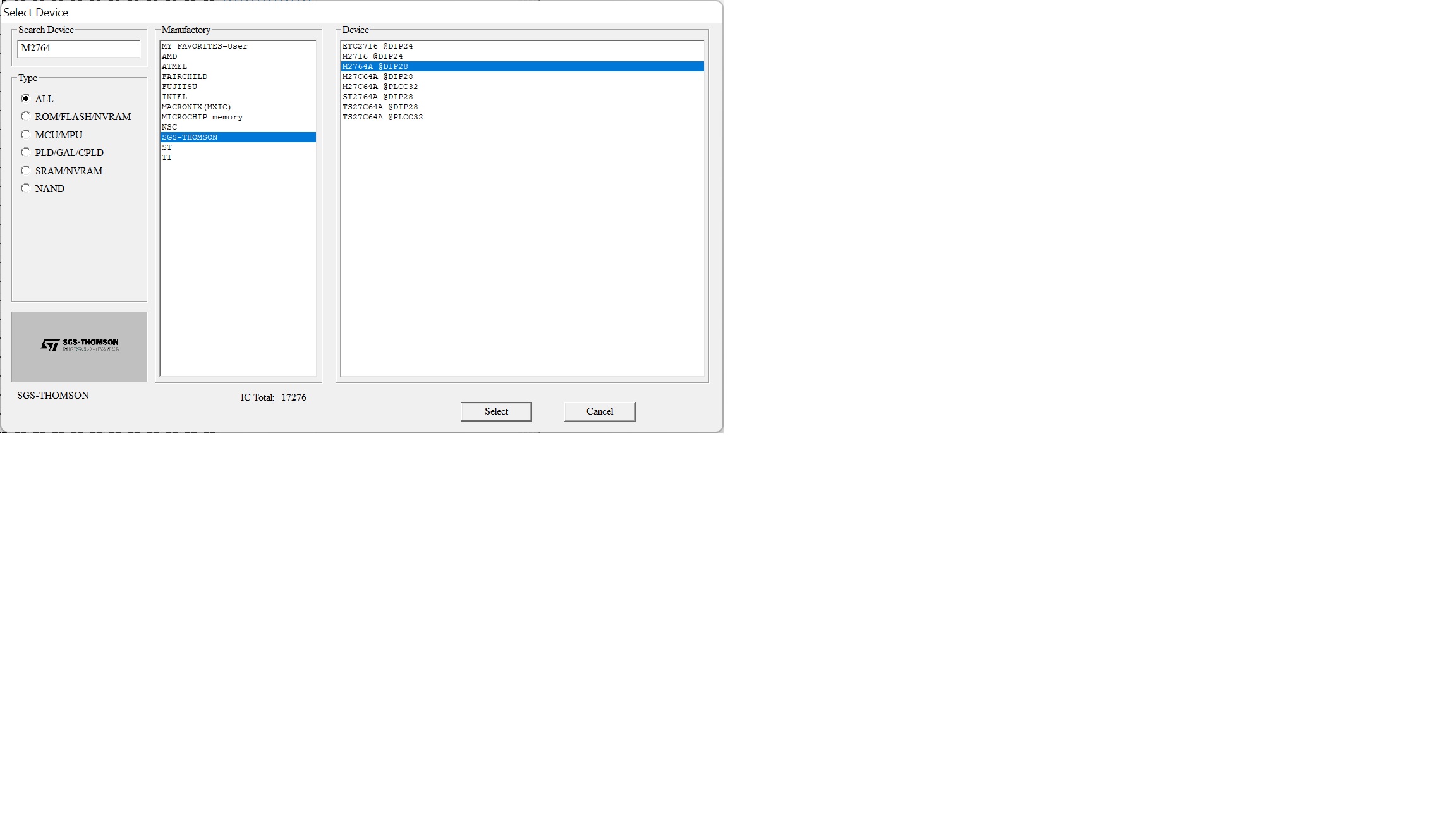

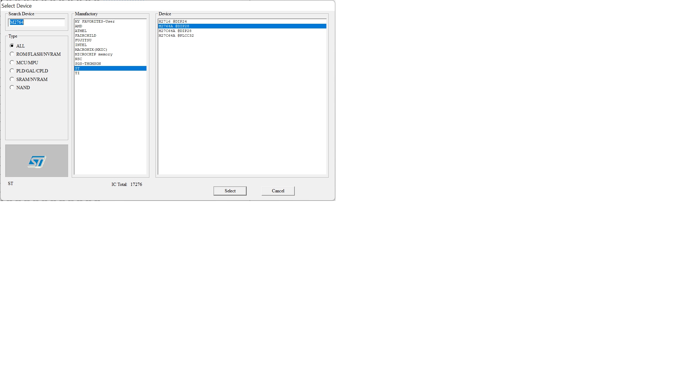

Hello... as an user. Sorry if i am wrong :-(
I think it will work. Anyway some chips are remarked and gave ID error.
If Chip is correct you can put ID : XX XX Here and maybe ADMIN will help
to select the correct Chip, or at bottom of app window, left side, you will find
the tick to ignore ID. Any error, post here image :-)

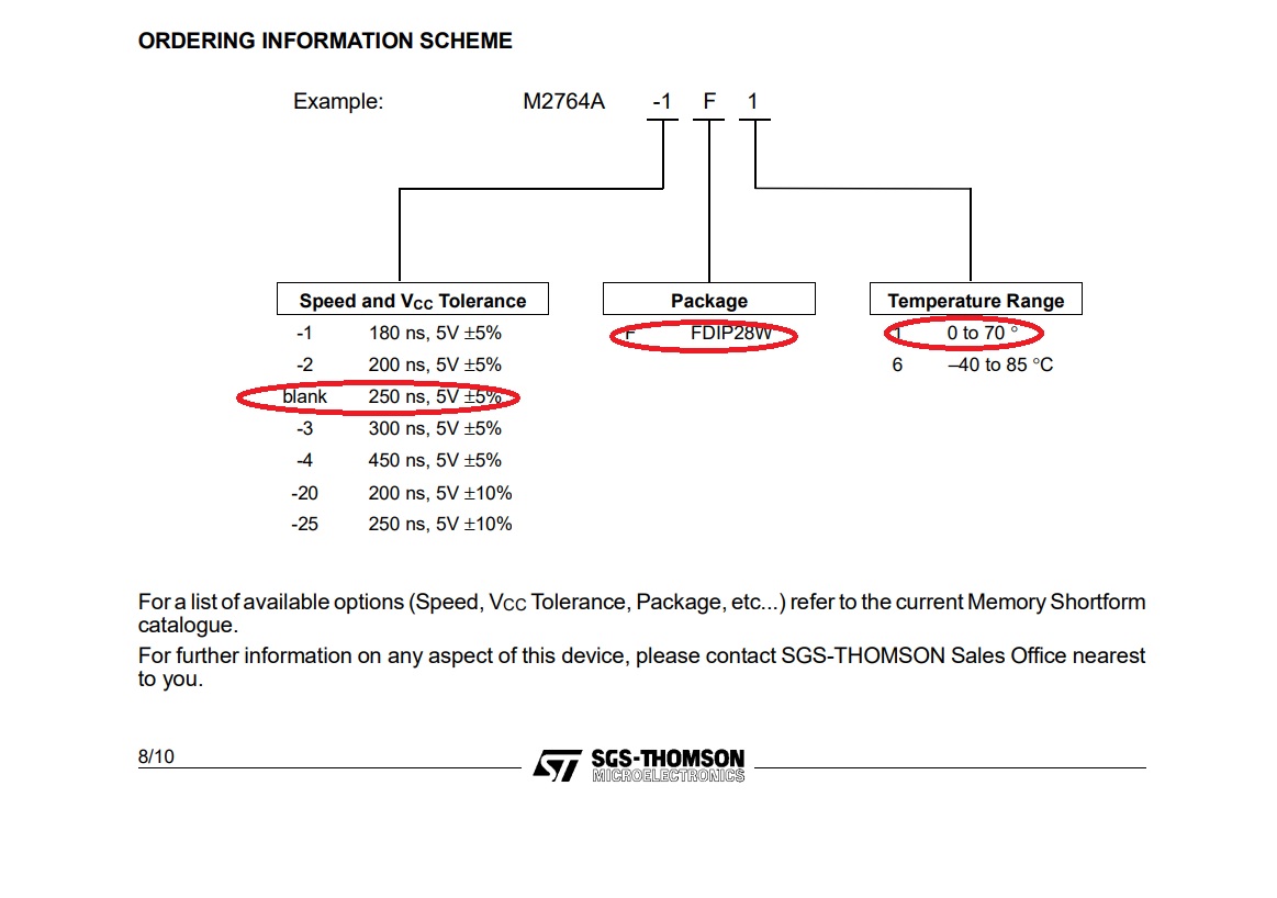

M2764A....
F=it means DIP28 version
1=it means o to 70 deg version |
