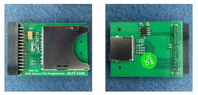

2. Completed support for SDNAND and TF/SD 1.0/2.0/3.0 cards, with read/write speeds up to 20+ MB/s. The SDNAND chip uses the WSON8 high-speed socket, and the TF/SD card uses the T76 dedicated SD card adapter.

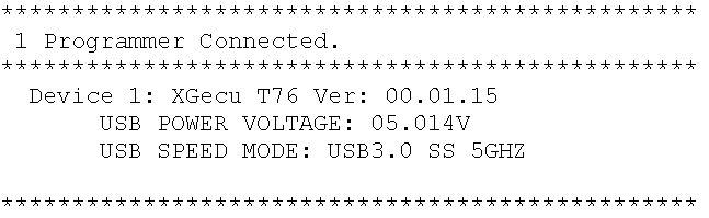

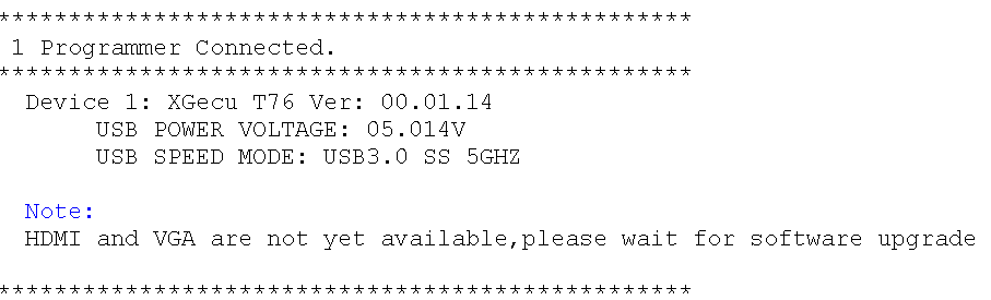

Message in the log, now say...

New dedicated adapter for SD/TF, and some latest other adapters. not yet seen for sale.

Firmware 1.15 from 1.14
Message in the log, now say... it seems that project it's now 'on track'. :D

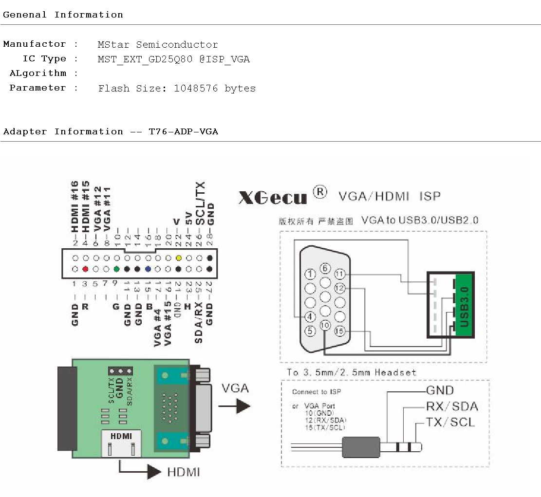

回复 5# Albano.Matos
  With Software 13.11 for T76, it brings the need of a new VGA adapter for the latest added functions, not yet seen for sale.... T76-ADP-VGA

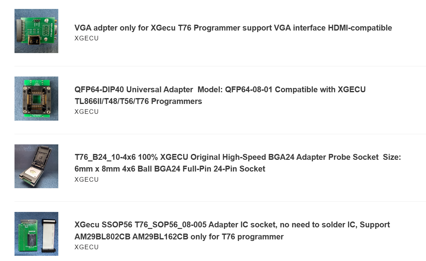

回复 6# Albano.Matos
    New adapters seen on Shopify Adapters for XGecu T76 Programmerand AliExpress platforms....
NOTE: Found info, that first batch of T76 VGA adapter board, need a simple rework, to work correctly with
latest's XGECU software . Read Here VGA adpter only for XGecu T76 Programmer support VGA interface HDMI-compatible

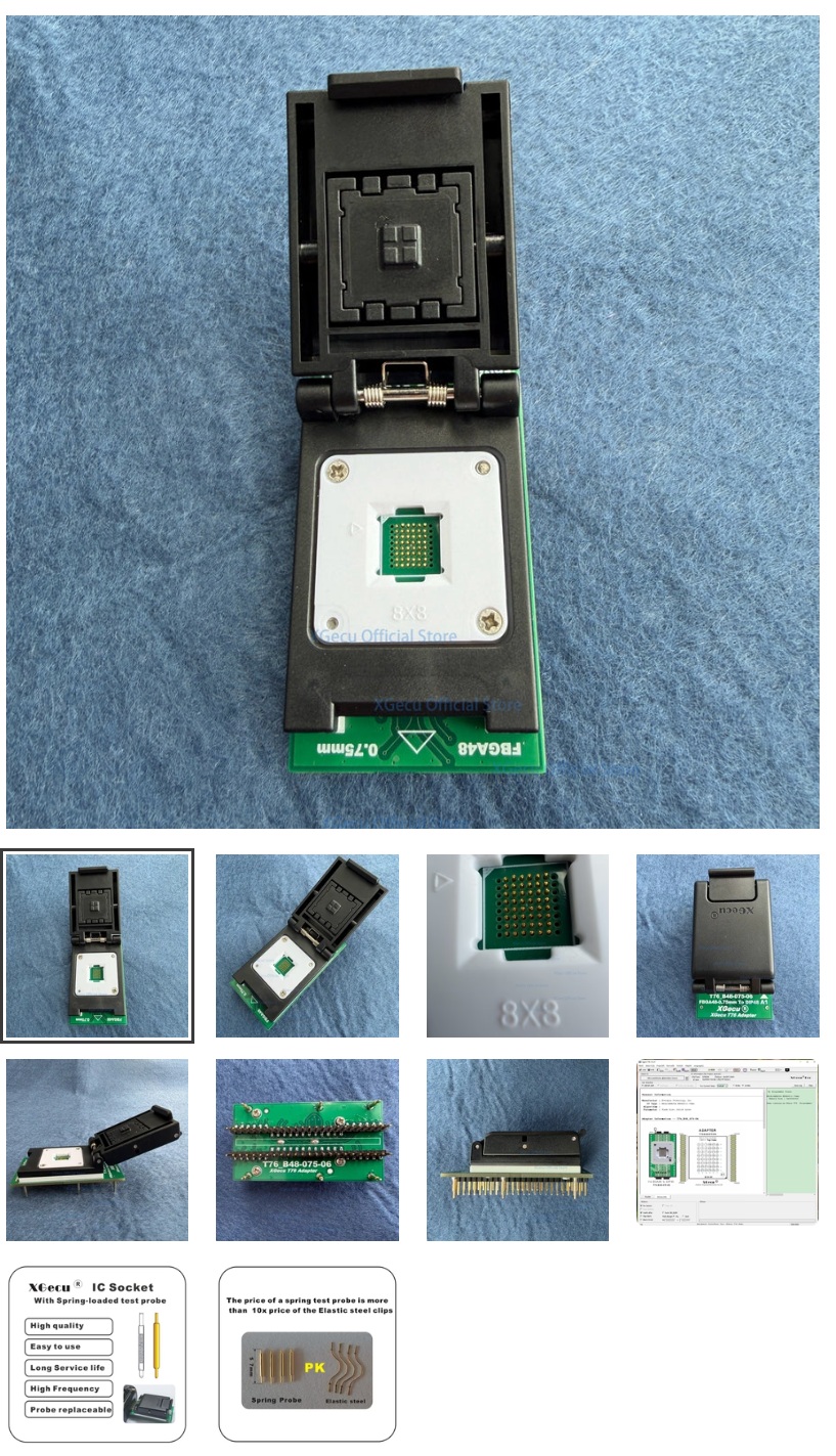

             From software version 13.21, one more adapter maybe needed to use all supported ICs. Seen for sale on shopify, It's an 0.75mm, for some BGA48 ICs adapter, but not existent ones with 0.80mm...
T76_B48_075-06 XGecu BGA48 Adapter (0.75mm) for Everspin MR1A16AMA35x, Compatible with T76 Programmer Only
