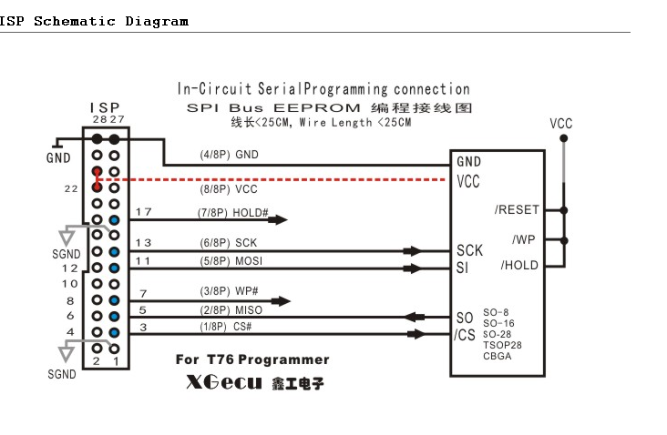

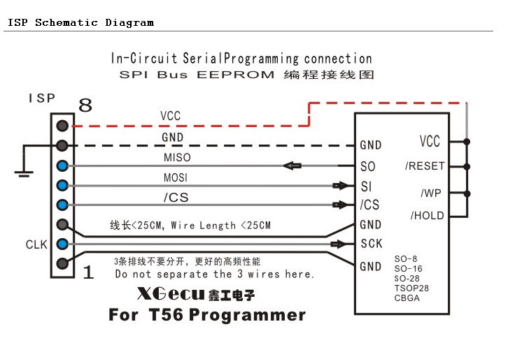

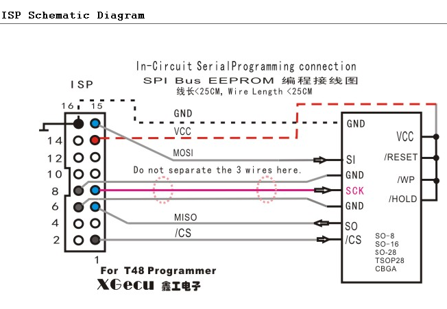

Hello, voltage can be stable for M95640W, from 2.5 to 5.5v, but 'stable'
as per datasheet, but in circuit with other ICs can be higher or lower....
[attach]2277[/attach]
You can see that they recommend lower then 25cm... For T76, T56 or T48, and recommendations
for clock lines....
Screenshot 2025-03-21 143857.png Screenshot 2025-03-21 144058.png Screenshot 2025-03-21 144220.png
You show, in the proto board the IC in an adapter that may fit the programmer socket directly,
then length cables at the lowest :-)
If any software change that may help you, hopefully Admin read this, and implement.
Rgds

Sorry,I haven't specified that I am using a T48.
I am following the guide for the clock. The M95640 ...
