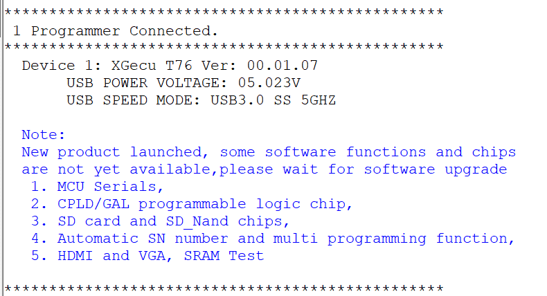

Evgeny 发表于 2025-3-9 11:03
           Software 12.85 , only for T76, is out for use. Ive noticed they removed SRAM chips in the previous list,
as support still in 'BLUE PRINTING', they also published the List of Supported ICs and 88C64 is there. Only testing
to see if it works now for you. Firmware was updated to 1.07, number of ICs in the list is now a bit above T48 in
number, but some features of T48 not available in the T56, still in the works, then the list will have to grow a lot
in the future....just wait, they are working, it seems, to get job done a.s.a.p.
Thanks for the update. You can send us a list of chips?

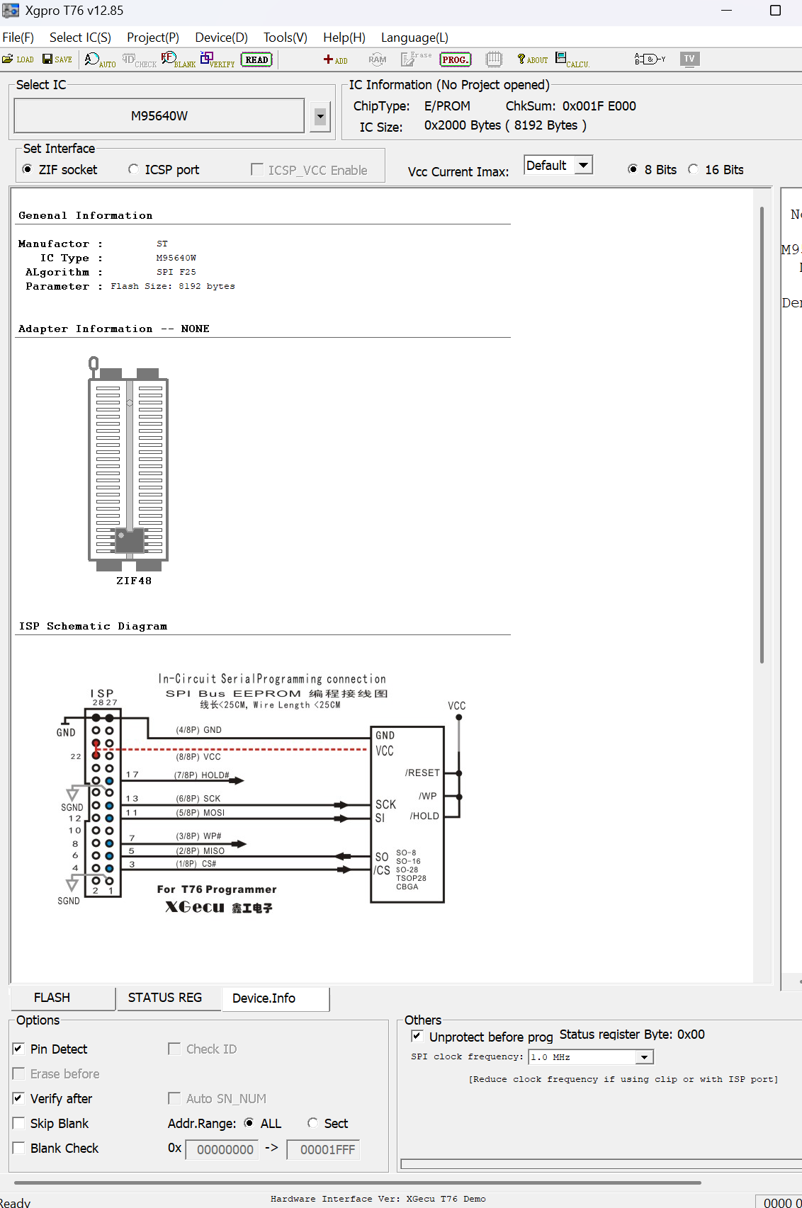

.If you need to setup any external connection, select the IC, then near the bottom, select Device.Info tab, it
will display some information how to connect. You can also display, bigger images of those images, if you
browse the IMG folder, inside the application folder . There, you can also see previous programmer images,
as they also be used in some occasions.

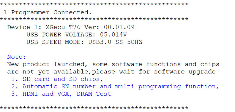

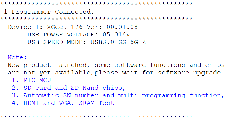

   Hello,            The T76 also, if you have the programmer connected to it, show some ongoing information
about features that still are in development fase, a bit of time outside initial schedule, but still already
above numbers of T48, but not support all ICs yet.

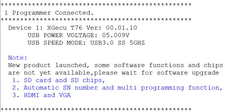

   Hello,            Today Xgecu software was updated for all latest devices. T76 (12.89)  setup grow up near 3MB in size.
ITExxxx reference disapear from list, firmware updated to 1.08, and welcome message is new, now say in 4 steps, previous 5...
User manual still is at T56 level, but not much difference needed so far :-).

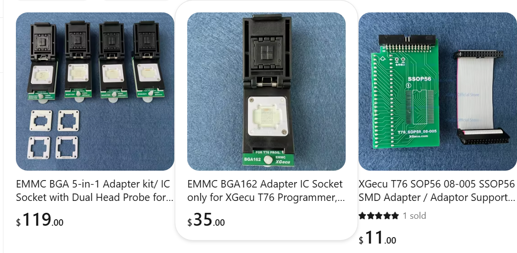

A wish is, they offer to sell already build cables, the one that connects the adapter to
the ISP Connector, to use the massive investment done on T56 adapters, even at lower speeds,
at least till all adapters are available and have fair price, or maybe to use much better, like
the T56 ssop56 with Zif socket, great product, as the new available for T76 need to solder the IC,
not very practical.

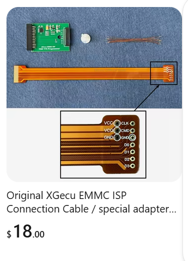

   Hello,            Today noticed that the same Emmc 5 in 1 Kit available for T48, is now also available for T76...
in aliexpress, unfortunatly more expensive, and not  free sending :'(
Also available at https://xgecu.myshopify.com/products/emmc-bga-5-in-1-adapter-kit-ic-socket-with-dual-head-probe-for-xgecu-t76-programmer-support-bga100-bga153-bga169-bga162-bga221
And one more, for those that need it: ICSP for MMC Adapter https://www.aliexpress.com/item/ ... 91d39EpIOlS&pdp_npi=4%40dis%21EUR%21%E2%82%AC%2020%2C00%21%E2%82%AC%2020%2C00%21%21%2122.14%2122.14%21%40211b430817464174085922801e3867%2112000047382933599%21sh%21PT%210%21X
Also have noticed that BGA48-BGA63 Adapters, will also work in T48, T56 and T76 with BGA67 format, 0.8mm pitch ( as others also exist)
Screenshot 2025-05-02 085324.png (697.59 KB)
Screenshot 2025-05-05 045026.png (201.46 KB)
Hello,            Today noticed that the same Emmc 5 in 1 Kit available for T48, is now als ...

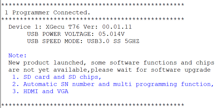

Albano.Matos 发表于 2025-5-14 20:19
   Hello,            No news for almost last two months :'( . It still miss SD_ADP support from T48, and also the hardware needed to work with it, as the SD_ADP from T48 without any kind of converter, isn't hardware compatible with T76. Also not seen yet for sale, a new BGA24 hardware shielded adapter exclusive for T76 Ref:  T76_B24_10-4x6 , to work with PN27xxxx Ics, support in App is already there, probably they will run with older BGA24 at slower speeds. VGA adapter, it seems that T56 adapter will also fit in T76, wait to see, but no support yet in T76 app.
Hopefully, more news soon :o
Hello,            No news for almost last two months  . It still miss SD_ADP support fro ...
Albano.Matos 发表于 2025-6-26 12:57

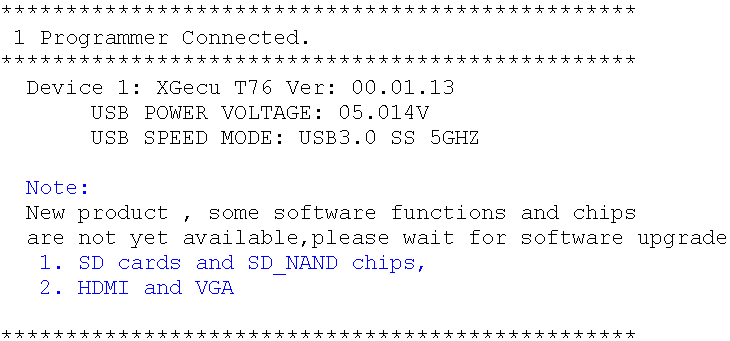

   Good News, new T76 only software version is out. 12.95
6. Fixed some known BUGs
It seems that page Haikou Xingong Electronic Co,Ltd Blue prints, are already outdated.
Hopefully, get it done, message in app is now:
T48-56-TL866II-12.90
T76-12.95 (firmware from 1.09->1.10)
T76-----.38540 from 38319 from 36111 from 35186  ( T76 ICs List and software available at xgecu   )
Some new announced adapters, only for T76, but none seen yet available for sale, but most ICs can use 'old' (previous) adapters, but at slower speeds.
For first time, number of ICs supported by T76 is bigger then T56 :)
More news as soon as they are available.
1. Added SRAM test function complet ...
Albano.Matos 发表于 2025-7-15 12:17
V12.97 for T76- Lists  and software will be here shortly xgecu.
Now at http://www.xgecu.com/MiniPro/xgpro_T76_V1297.rar , and the list at
http://www.xgecu.com/MiniPro/T76_List.txtFirmware now at 00.01.11 level
1. Added support for over 100 chips
2. Fixed a major bug in the previous version
3. Fixed some other known bugs
Supported Chips:
TL866II-.19326 from 19272 from 19023 from 18991
T48-----.35969 from 35779 from 35267 from 35138
T56-----.38783 from 38537 from 38062 from 37906
T76-----.38649 from 38540 from 38319 from 36111 from 35186

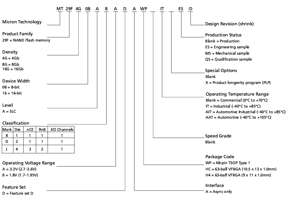

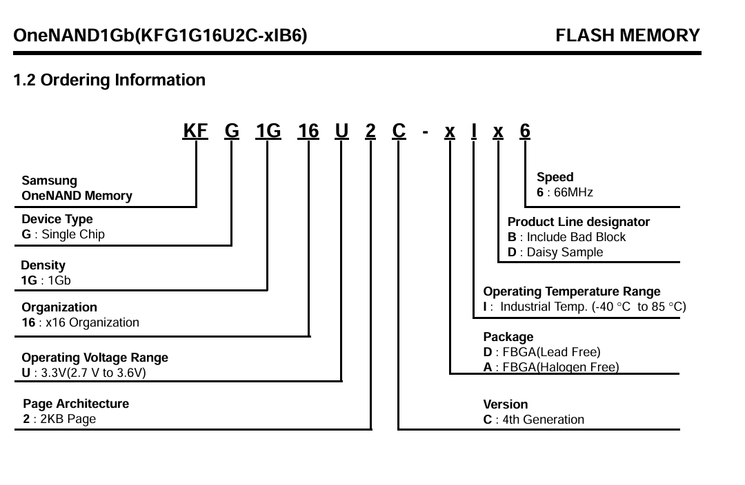

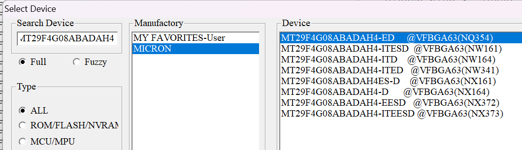

Hello, please add this IC.
NQ437 FBGA63
MT29F4G08ABADAH4-ITX
biyache 发表于 2025-8-19 21:31

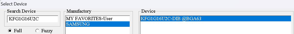

        Until they add the line for your IC, based in the Datasheet info, page 2,
there are already some identical ICs in the list, only planed use, or case maybe
different. Do not know if ID is the same, but if not, you can remove 'CHECK ID'
For T76-T56...
Hope it helps, or not :(

   Hello,             Three new HIGH SPEED adapters for T76 seen for sell.
T76_B24_5x5-02   ,
T76_WSON8_127  , and, T76_SOP16_127EX
on Xgecu store at AlIexpress  XGECU XGecu Official Store - Amazing products with exclusive discounts on AliExpress,or also at myshopify  Adapters for XGecu T76 Programmer
Based in the latest Xgecu T76 Software, other 3 adapters can also appear soon
T76_B24_4X6-03
T76_B24_10-4x6
and also
QFP64-08-01
Still have doubt, if a 'full pin' BGA24 will be available in the future, as T76 tend to conciliate
adapters, to a one only for every package, with this have at least 3 different, or if one of them will
be the '0ne for All'. Let's wait a bit more to know.
More news as soon as possible.
KFG1G16U2C-AIB6 BGA63
TC58RYG0S8EBAIA BGA63
biyache 发表于 2025-9-7 00:52
        Until they add the lines for your requested ICs, for KFG1G16U2C-AIB6 BGA63, based in the Datasheet info, page 4, there are already one identical IC in the list, only planed use,
or case maybe different. Do not know if ID is the same, but if not, you can remove 'CHECK ID'.
Always remember to read Datasheet, as some ICs, like this one, have OTP areas that you cannot rewrite,
write only in a completely new, not programmed IC. Software also show some info about.
For T76,
Hope it helps a bit, or not :(
V12.97 for T76- Lists  and software will be here shortly .
Now at  , and the list at
Firmware  ...
Albano.Matos 发表于 2025-8-19 21:07
V13.03A for T76- Software and IC support  List are here xgecu.
(Newer 'A' setup file seen for download, maybe corrected any install error)
1. The number of supported chips has been increased to 39,009, with over 250 chips added. This primarily includes support for Micron's MT35XUxxx and MT35XLxxx series Octal chips.
Read speeds reach 60+ MB/s.
2. Automatic serial number increment for T76 has been implemented.
3. Support for multi-machine programming has been implemented (up to four programmers can be connected to one computer simultaneously).
4. The software interface now automatically adapts to high-DPI monitors.
5. Multiple software optimizations have been made to ensure greater stability.
Firmware updated to version 1.13 from 1.11

          Two new  ISP cable adapters for T76, seen for sale at LRF. For those who may need them, link t76
