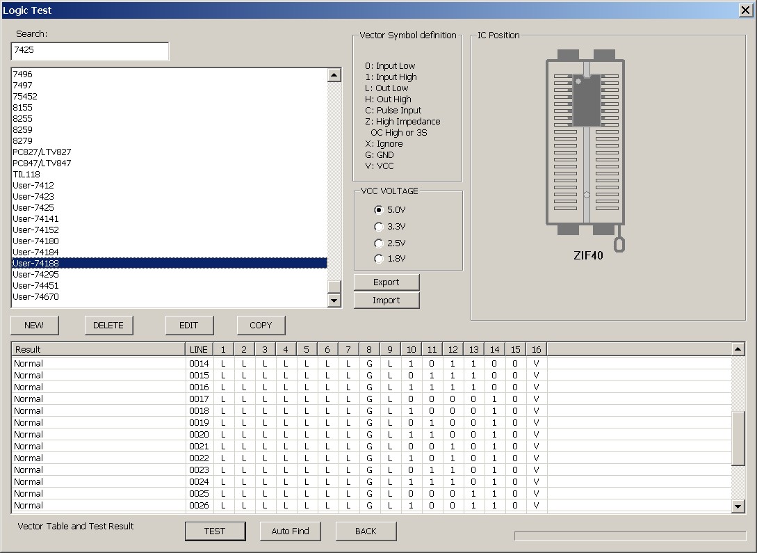

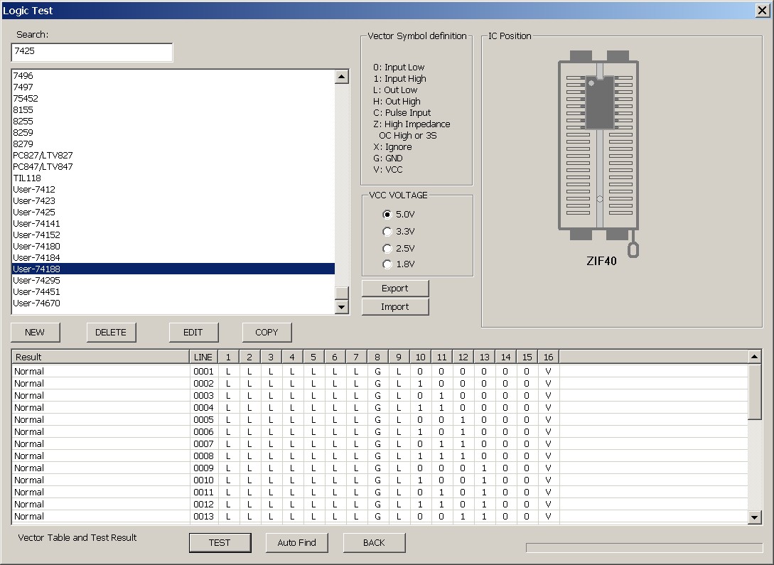

发表于 2024-4-16 02:44
74188 empty or programmed?
Igor 发表于 2024-4-15 11:33
Only empty

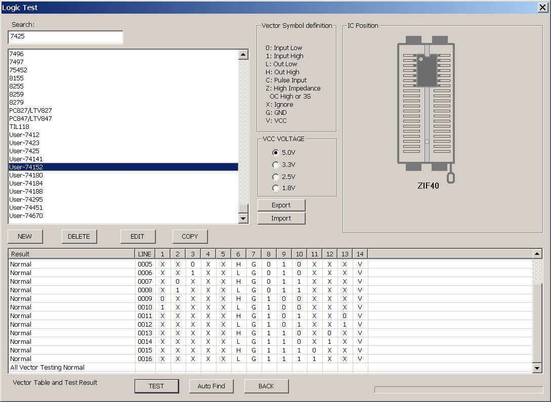

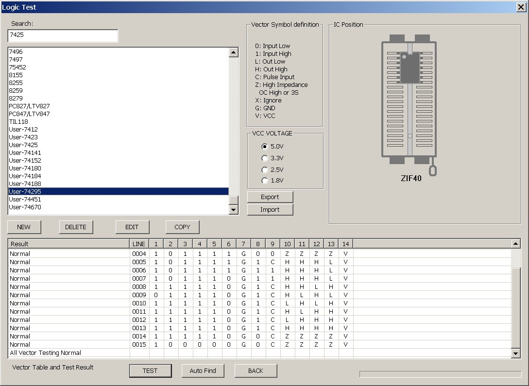

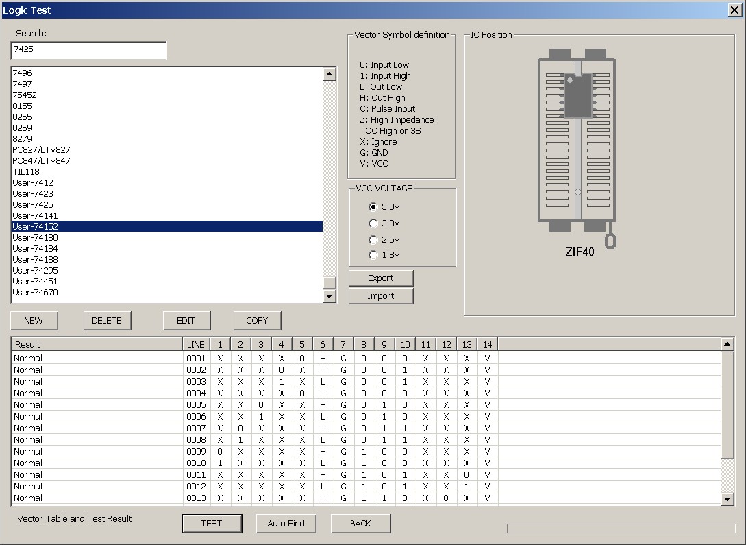

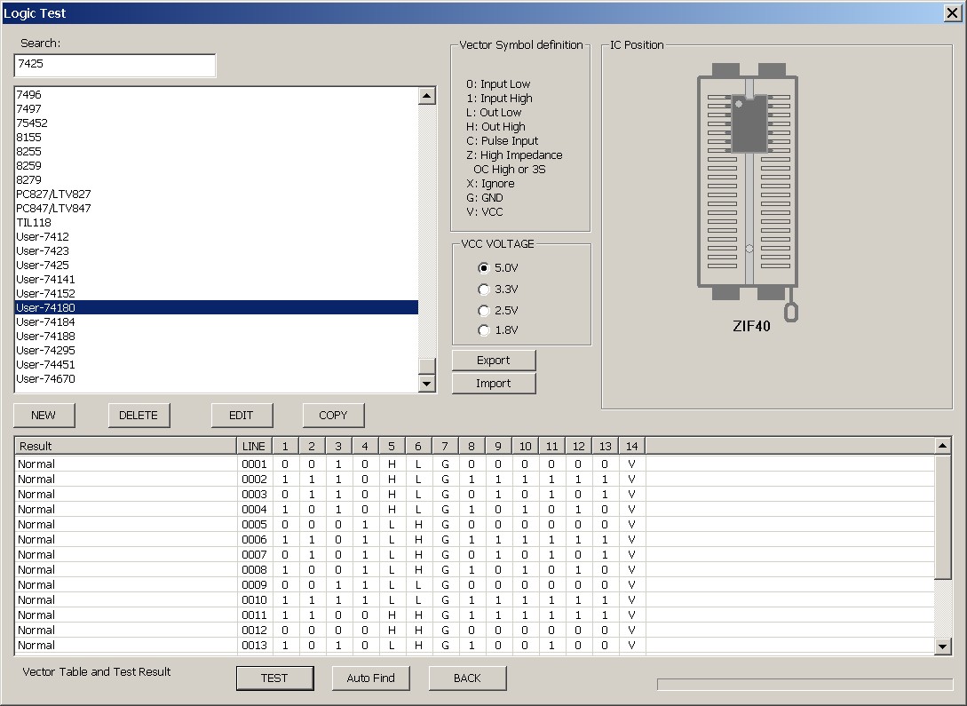

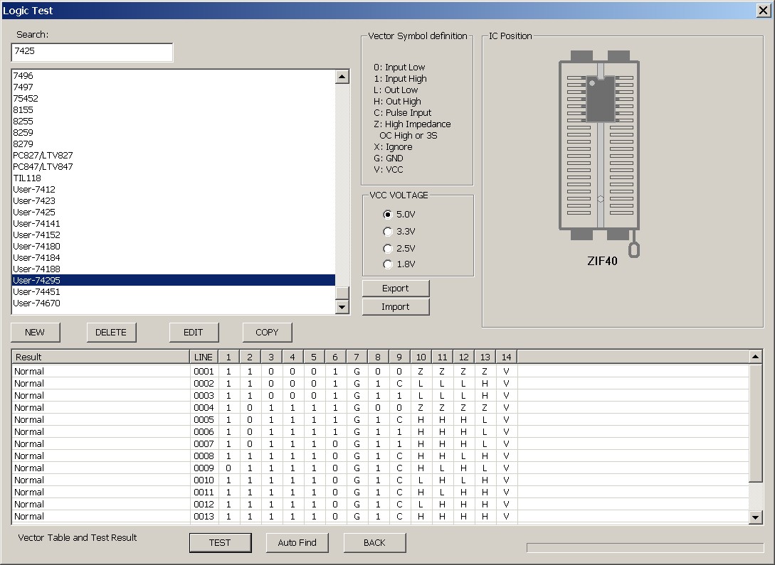

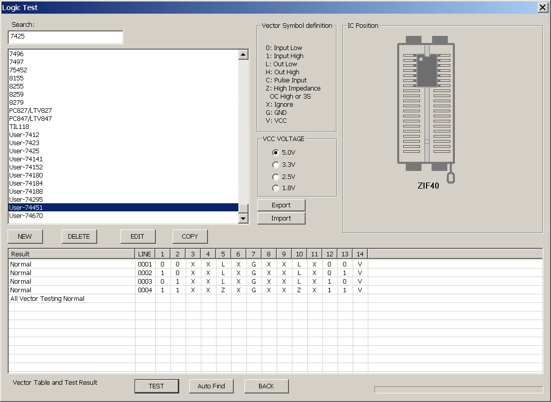

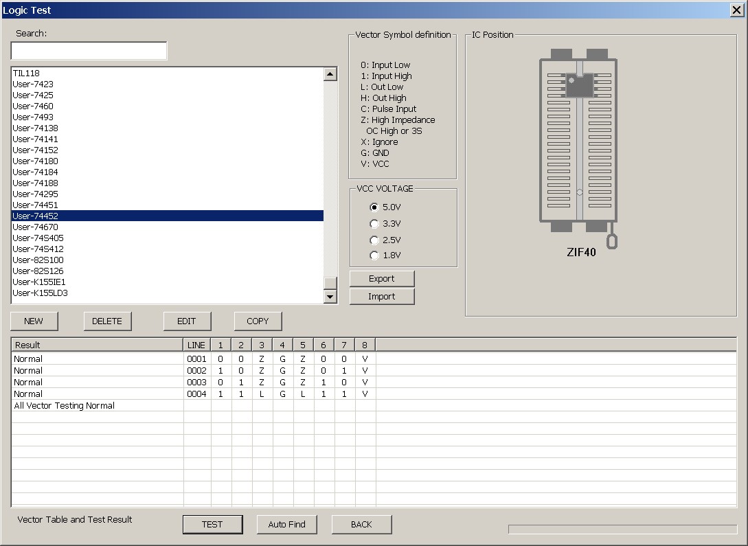

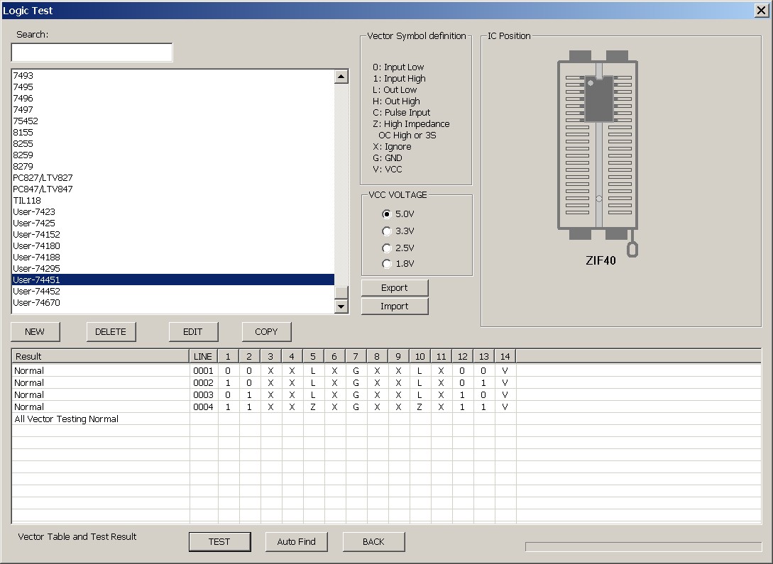

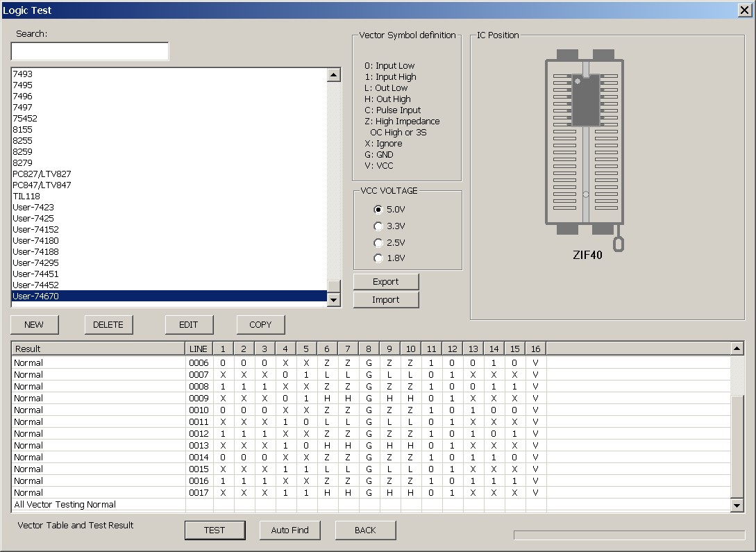

发表于 2024-4-17 02:01
74152, 74180, 74188, 74295, 74451, 74452, 74670, 82S126
(147.77 KB)
2025-8-10 19:28
(145.93 KB)
2025-8-10 19:28
(146.29 KB)
2025-8-10 19:29
(146.27 KB)
2025-8-10 19:29
(124.44 KB)
2025-8-10 19:29
(120.02 KB)
2025-8-13 01:04
(149.87 KB)
2025-8-10 19:29
(150.98 KB)
2025-8-13 01:04

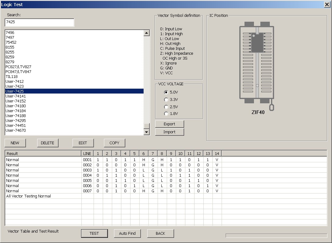

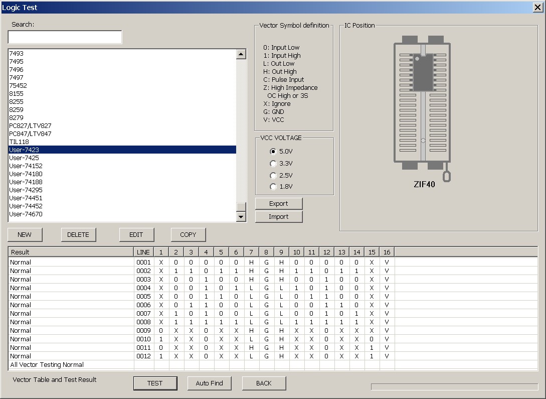

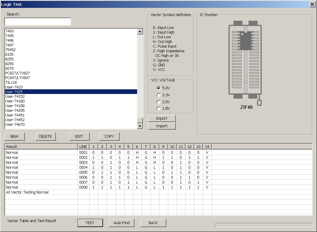

发表于 2024-4-22 02:21
7423 (16 pin), 7425 (14 pin)
(149.31 KB)
2025-8-10 19:18
(134.86 KB)
2025-8-10 19:18
