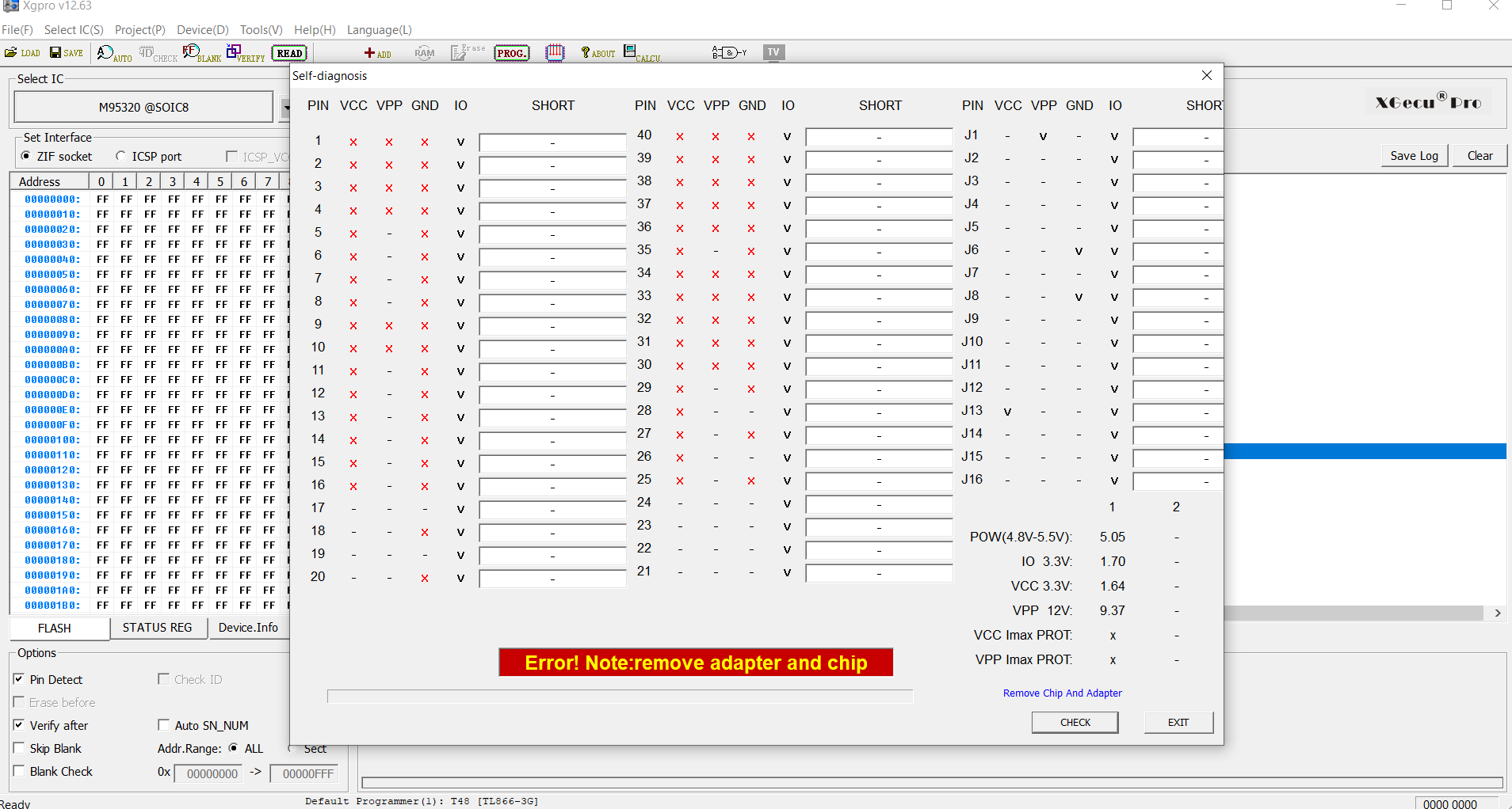

I have a T48 fail self-test with no chip inside.
How can i fix it ?
From time to time is working without do something,

More tests return short on :
O-25 G-25
on allmost all positions.

Thank you for replay,
I got my new T-48 programmer, but i want also to repair this one as backup.
I will replace U2A ( AMS1117 ) i next days and return with feedback
Device SN HYR4LK-YX39SF-LWG5TH-BP0894 maybe it helps.

Component changed.
All working good.
