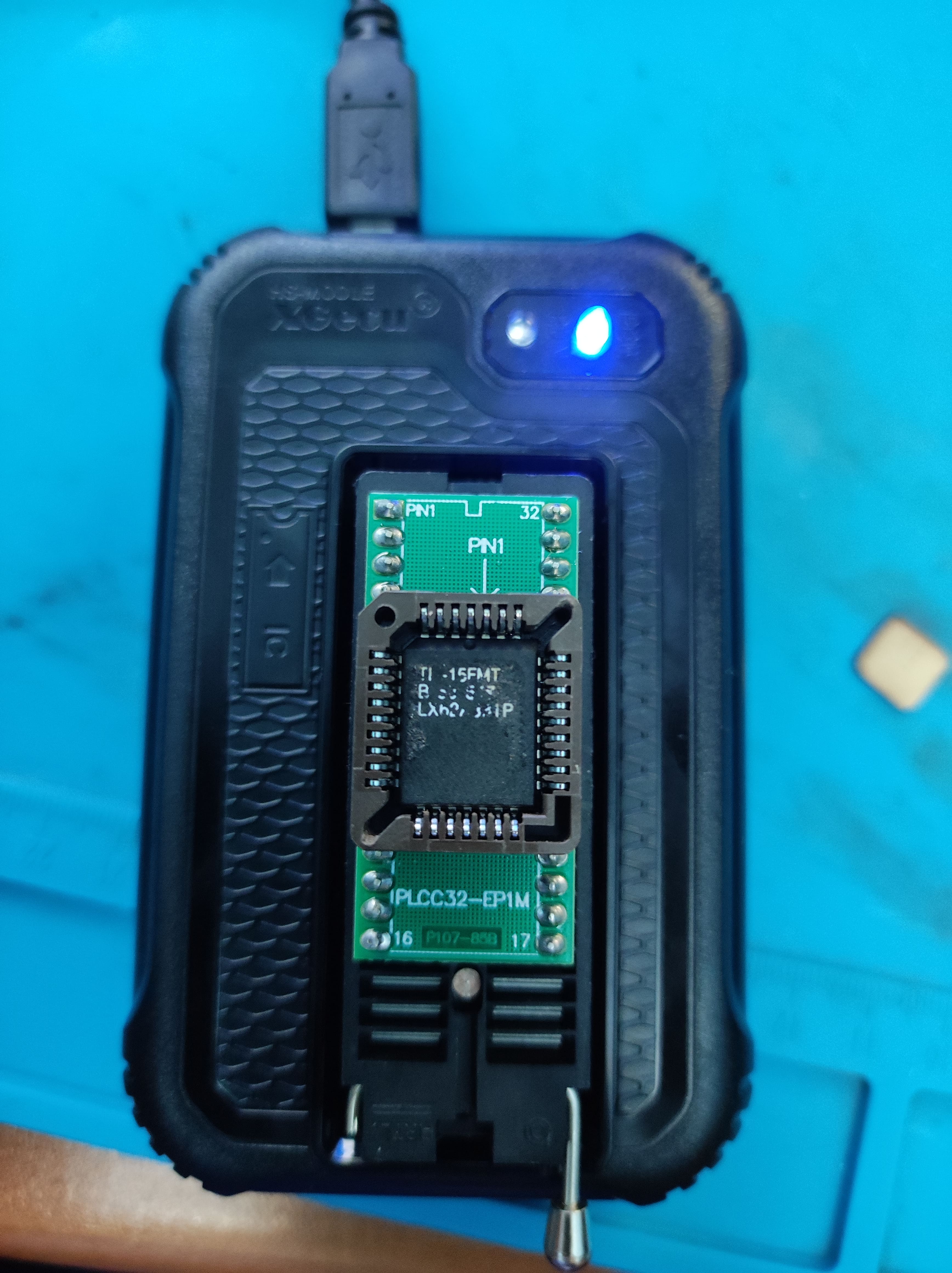

XGecu T48 - TI TMS29F010
hi, i've problem with my XGecu T48
i can't read  TI TMS29F010 @PLCC32
Error Log
------------------------------------ID ERROR! Check the chip Correctly? whether contact good pin?
     Device : TMS29F010 @PLCC32
Pins Detected Passed!
Check ID Error!
Checked ID is:0x 97 97
Wish to continue programming , please cancel [Check device ID] option!
-----------------------------------------I have tried others device model, but end with the same result.
I have disabled Check ID, but end with diferent ChkSum when read two times.
The PLCC32-DIP32 adaptor has been tested.
Read Device ID: 97 97
Thanks for help.

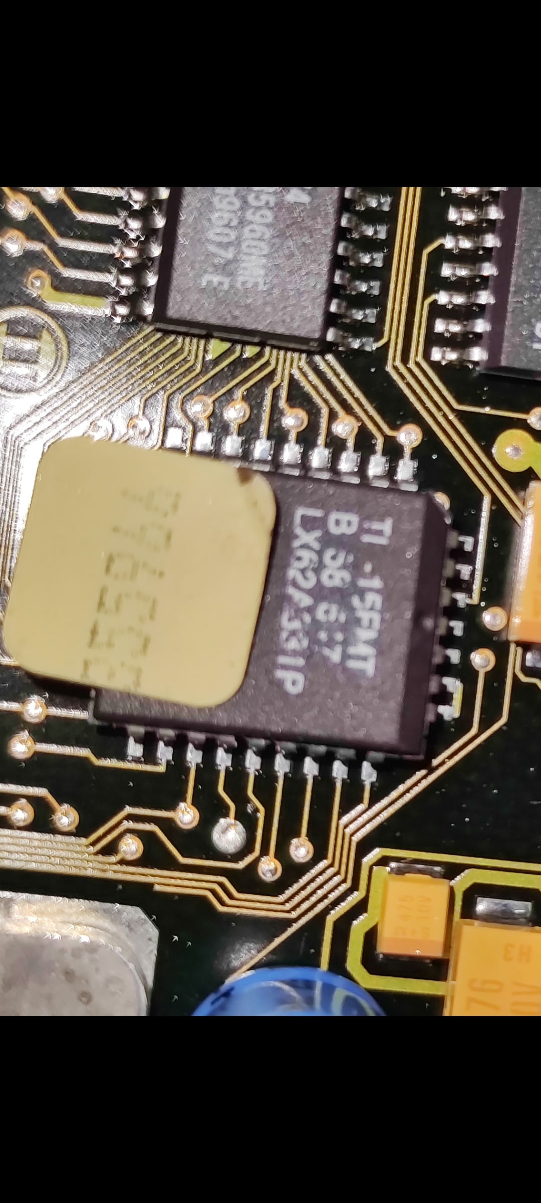

Thanks for the quick response.
The model number of my device is scratched off, it is either b58547, b58517, b58647.------------
TI-15FMT
[model]
LX62A331P
I have tried several compatible devices such us:
29F010
28F020
87C257
27C010
27C010A
27C020
27C1001
27C2001
27C512
But none of them works.
How can I find an algorithm that works with my device?
Solved. Turn out that the zip adapter had a short in two data lines.After fixing it, the memory could be read no issue with the AM29F010 algorithm.
This was the same issue that causes the problem covered in this other post:
http://forums.xgecu.com/viewthread.php?tid=1109&pid=3315&page=1&extra=#pid3315
