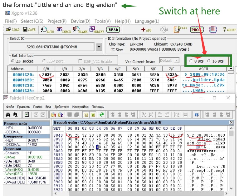

1. Lock and unlock funtions can be added later.
2.
(454.63 KB)
2022-12-5 11:23
发表于 2022-12-6 14:00
Viperam

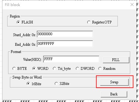

I didnot unstand you .This is only the switching of 8-bit 16 bit display mode.the file your saved is same of course.
if you want swap buffer.
use fill block funtion as follow:
