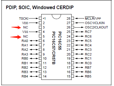

1.PIC16C57 Pin 3/5 is Not Connect, can not be detected . you can disable
[pin Detect]
in Options. T48 Pins sets of PIC16C57 is wrong. will be fixed in next version.
