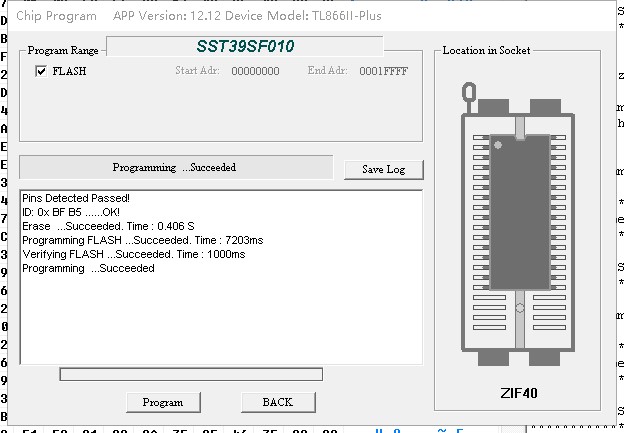

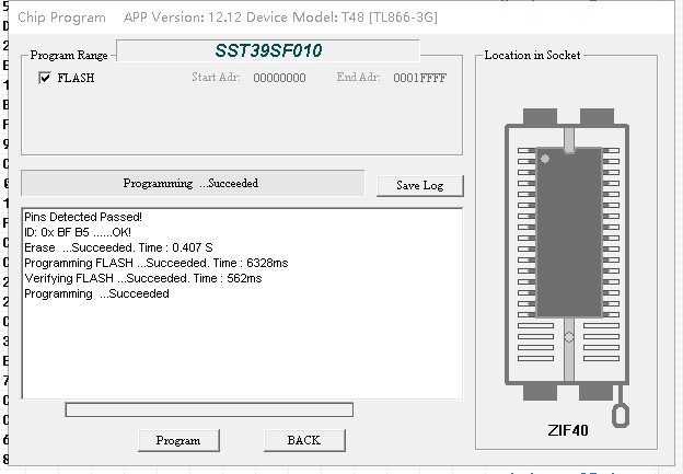

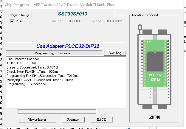

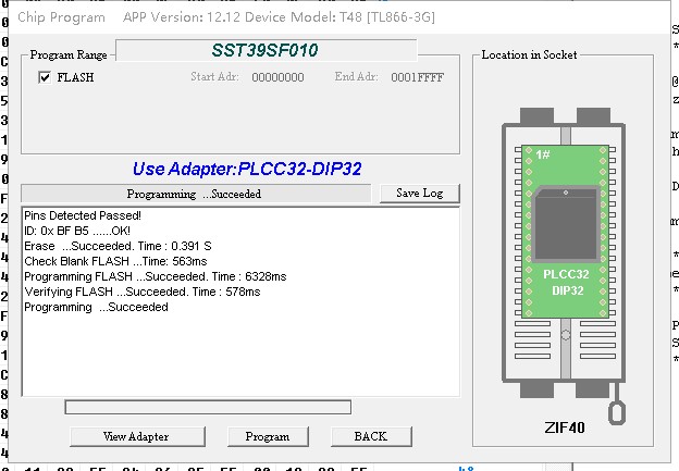

1. 27C010 is not DIP28! only 32PIns IC
address 800 error ------> A11 pin is bad of your adapter
2. It should your PLCC32 adapter is bad.
PLCC32 shuld to DIP32 , not to DIP28
3, I tested TL866II and T48, all is normal!
T48
(53.96 KB)

TL866II
(57.15 KB)
2022-8-18 11:48
(62.27 KB)
2022-8-18 11:51
