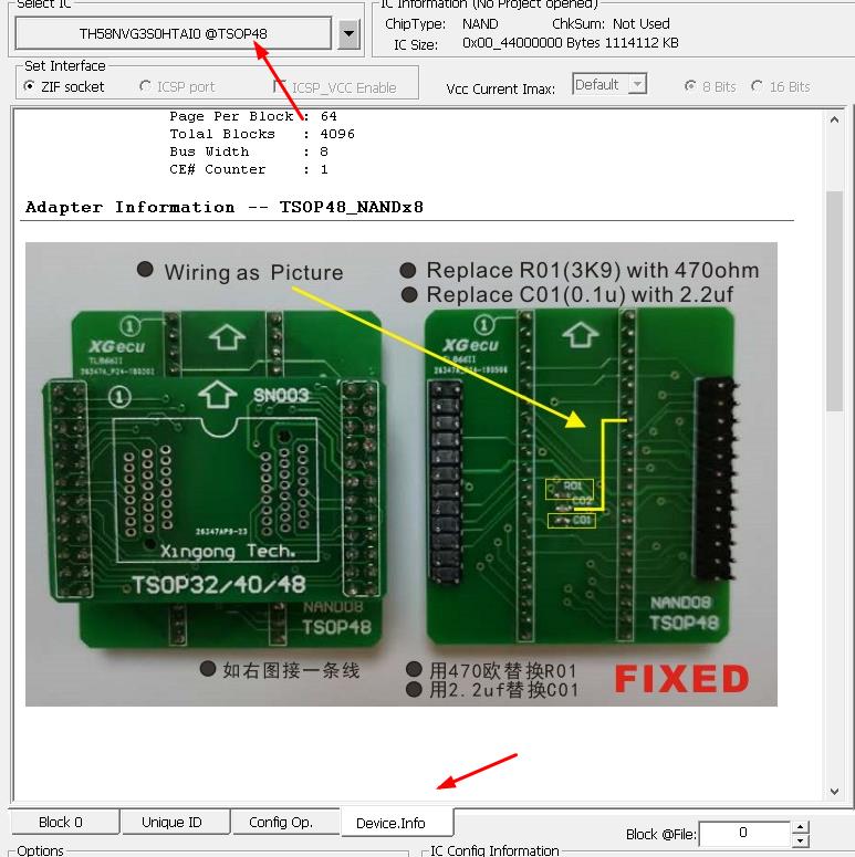

» TL866II-Plus pin errors on 48 pin chips
发表于 2021-10-18 21:36
see <device Info>for correct adaper,
TL866 NAND use a specail adapter
