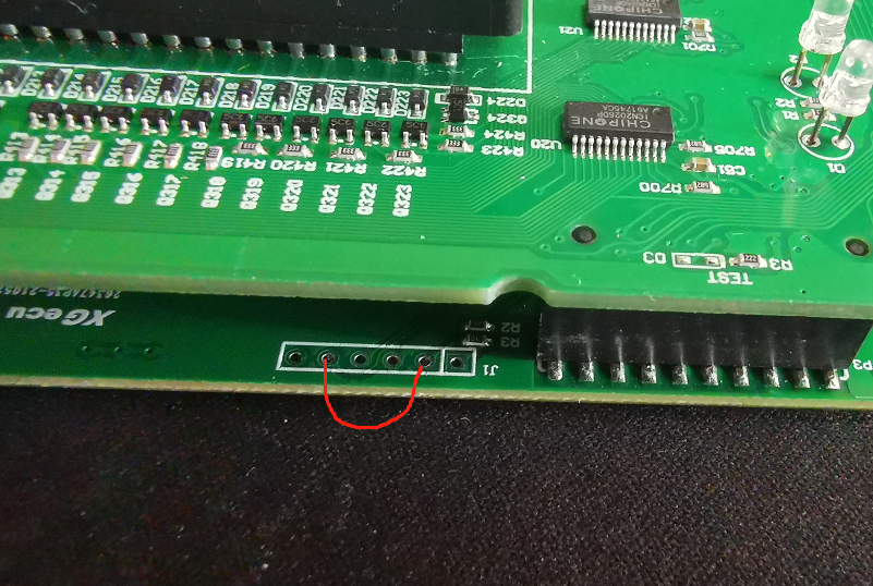

» Programmer not recognized after firmware update failed
发表于 2021-7-8 11:08
rickseiden
run light is flashing: USB driver software is damaged, reinstall the software
发表于 2022-8-23 09:47
4#
CrisELDi
Disassemble the programmer and connect the ports PIN2 and PIN5 of J1 connector.
Power on the programmer, it will enter BOOT.
if it is normal . reflash firmware.
then diconnect pin2 and pin5 of J1
