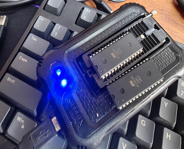

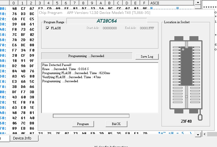

» KM28C64A fails programming, also AT28C64 fails
发表于 2023-3-17 15:30
stevemas
select IC: AT28C64, not AT28C64E.
they have diffrent page size when programming.
error on adaddress: 0x00080 and 0x00040
发表于 2023-3-19 17:56
4#
stevemas
I have tested the AT28C64B and there is no problem. I will find several chips to try。
发表于 2023-3-20 13:55
4#
stevemas
all are normal.
