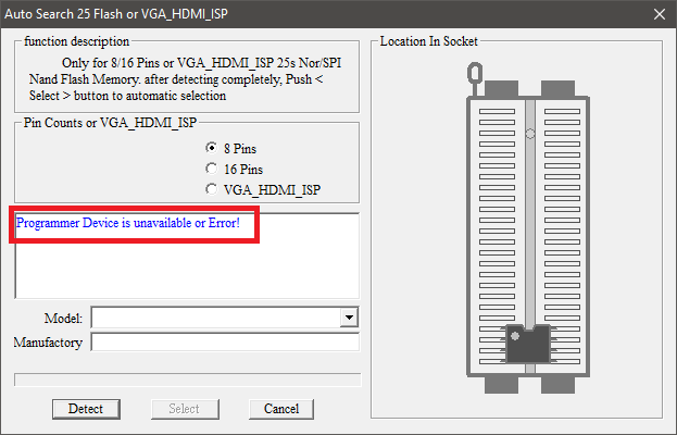

How to add XMC 25RH256CXIQ ?
图片附件: XMC 25RH256CXIQ.png (2023-1-13 06:41, 17.55 KB) / 下载次数 16710
http://forums.xgecu.com/attachment.php?aid=1683&k=ce85a39e369faa37e5354928cc60ce5b&t=1793224509&sid=RXi21l

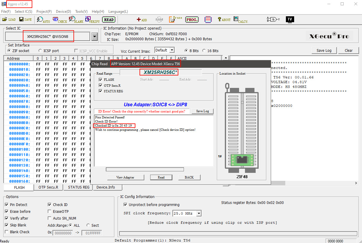

作者: DjamelGsm    时间: 2023-1-13 17:38
As a User: Have you tried latest software 12.45?
XMC 25RH256C* is available for all Xgec ...
Albano.Matos 发表于 2023-1-13 14:43
Always use the latest update
  1. APP Version : 12.45   Model : T56  MFG:2020-10-27
  2. Device : XM25RH256C* @WSON8
  3. Pins Detected Passed!
  4. Check ID Error!
  5. Checked ID is:0x 20 43 19
  6. Wish to continue programming , please cancel [Check device ID] option!

作者: Albano.Matos    时间: 2023-1-13 18:25
DjamelGsm 发表于 2023-1-13 17:38
   Hello,             I see now. Some times with so many IC variants, the ID present in the software,
is only from one IC, sometime something is wrong and need to be corrected,
and to work, need removing check ID tag, at bottom of window. Can you, please try it?
For sure, time permits, Admin will help further.
Just trying to help
Rgds
作者: cgtecINFO    时间: 2023-2-25 03:55
i try to unchek ID . i read dump but its crupted .... there is problem . i try w25r256 work perfect
