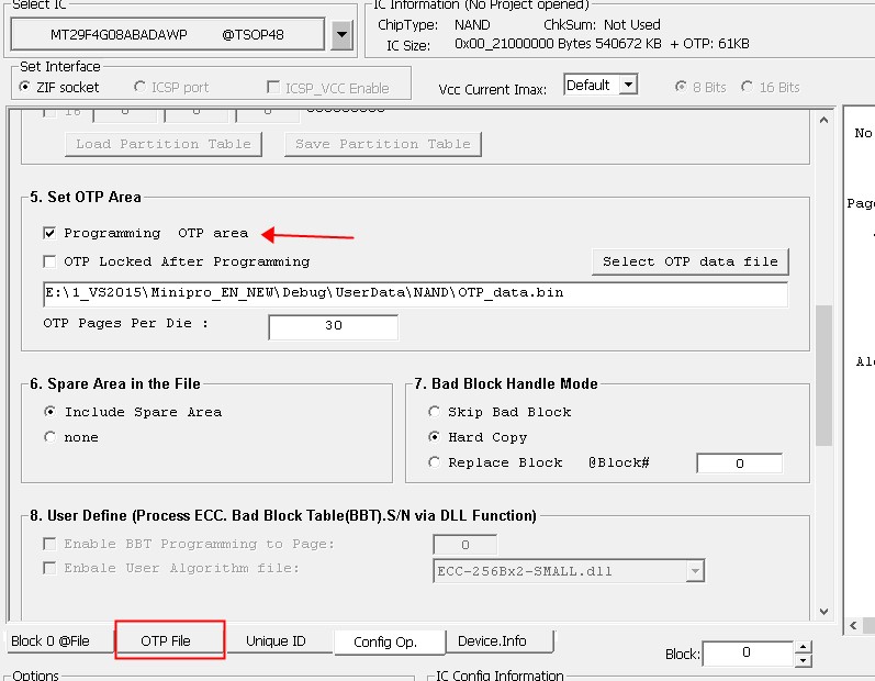

Hi! I need to copy data from a nand memory MT29F4G08ABADA. Is it possible to find a way to copy the OTP data and write it to a clean memory?

回复 1# Bruno
图片附件: 1.JPG (2023-1-3 10:47, 111.13 KB) / 下载次数 19330
