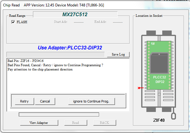

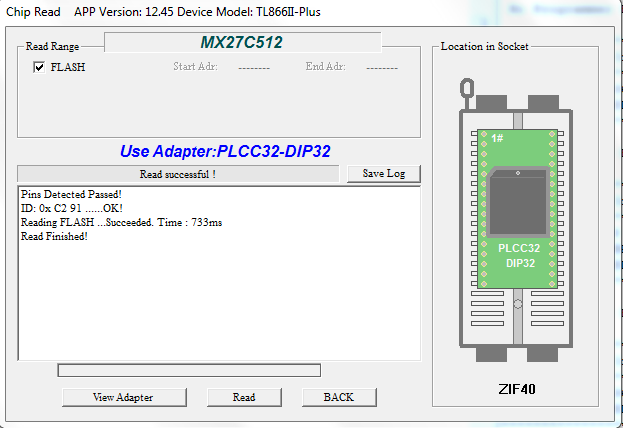

Hello, I tried to program the 27C512. I got an error message that pin 16 was bad. So I tried the TL866 II Plus programmer and it worked without any problems.
Is this a software error because the T48 self-test is true with no errors?
图片附件: [T48] T48.PNG (2022-12-24 21:42, 33.41 KB) / 下载次数 8631

图片附件: [TL866II Plus] TL866.PNG (2022-12-24 21:42, 34.05 KB) / 下载次数 8649

作者: admin    时间: 2022-12-25 09:35
回复 1# gmxspooker
this Pin is a Vss PIN. TL866 do not detect it.
VSS pin of few IC can not be detected. only ignore it.fix it in next version.
