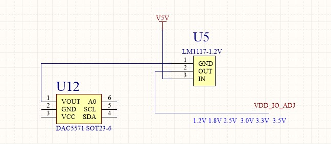

There are questions about what should be in place u5
Yes, and in principle for future repairs in case of a short circuit
作者: admin    时间: 2022-12-25 17:41
回复 1# Oleg_Skalskiy
U4 and U5  is a LDO on T56. MODE is AMS11117-1.2V.  Packge is SOT89.
1.U4 Normal voltage about 1.2V always.If it is broken, the programmer maybe not be connected to the computer at the same time.
2.U5 normal voltage is about 3.3V on idle state. If it is broken, self check maybe not passed. and test IO voltage is not correct.
These two components have been replaced for the newly delivered programmer.
作者: Oleg_Skalskiy    时间: 2022-12-25 18:16
U5 1.2v but produces 3.3
And why is adj not installed. Why is it so hard to do.
U5 exactly at 1.2V?

作者: admin    时间: 2022-12-26 12:48
U5 exactly at 1.2V ...
Oleg_Skalskiy 发表于 2022-12-25 18:16
   AMS1117-1.2V LDO is also adjustable, but the minimum voltage is not less than 1.2V .
  T56  adjust the output voltage of VCCIO through DAC5571
VIOout=Vdacout+1.2V
