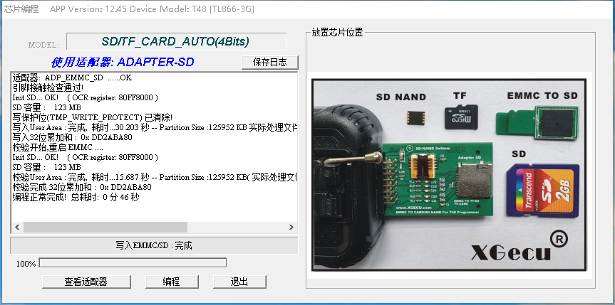

使用T48专用的SD卡适配器
功能:
1、作为EMMC芯片转SD接口使用,在软件中可以任意选择BGA适配器,适合1B/4模式,最高速度17MB/S
2、读写SD卡
3、读写TF卡
4、读写SD NAND芯片(QFN8封装)
使用方法:
1、读写SD/TF卡时,选择SD/TF_AUTO(4b或1b)
2、读写EMMC时可以选择任何封装的EMMC芯片
操作方法同EMMC
图片附件: 1.png (2022-12-22 12:09, 235.31 KB) / 下载次数 35603

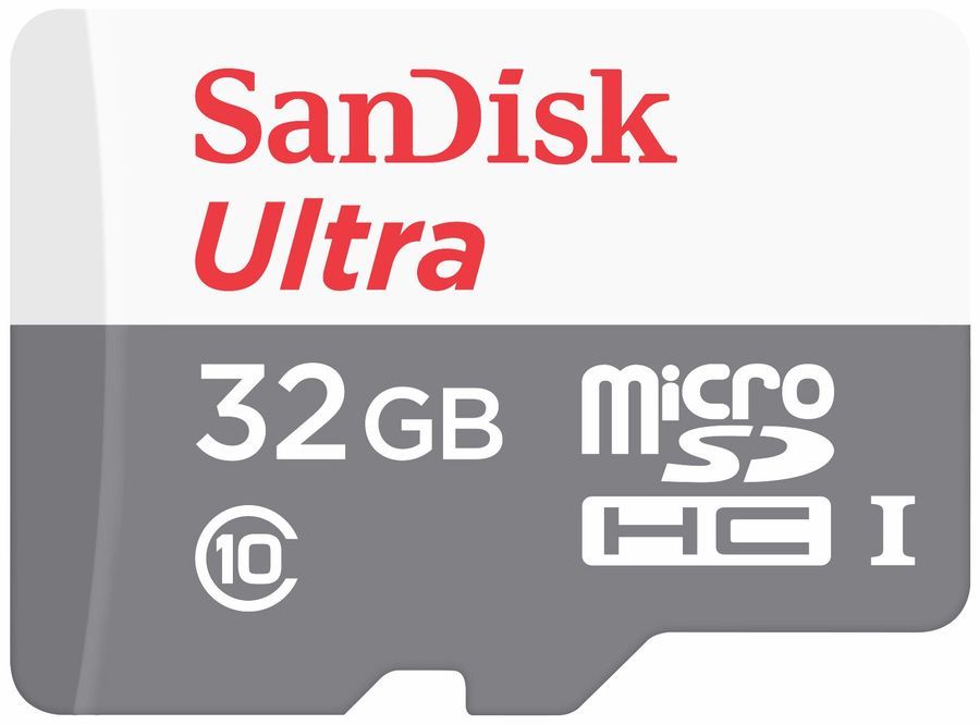

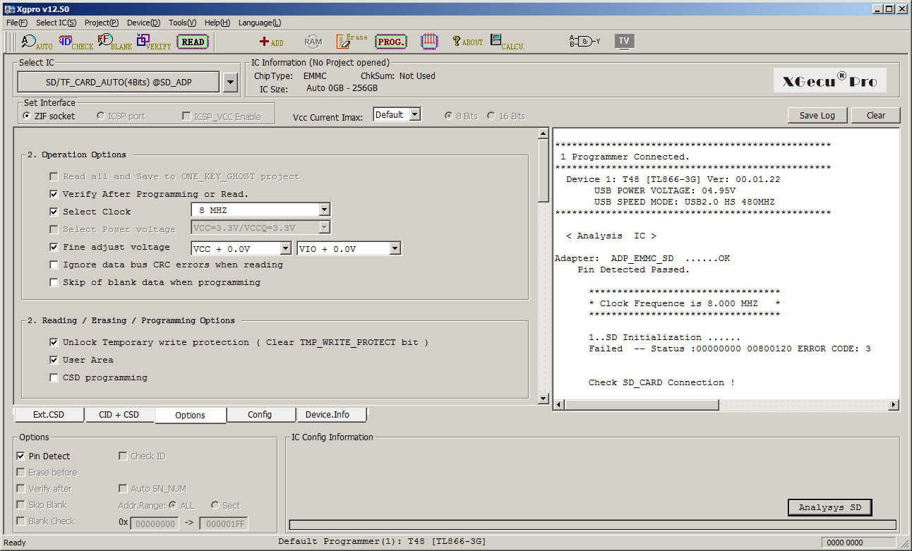

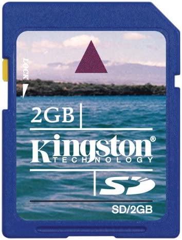

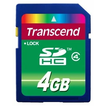

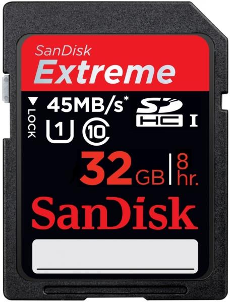

Hi !
I tested about 30 cards and found five that are not detected by the programmer.
Like this :
"Failed  -- Status :00000000 00800120 ERROR CODE: 3"
But cards are good and working in cardreaders.
They are
SD Transcend TS4GSDHC4    4GB
SD Kingston SD-M02G    2GB
SD Sandisk Ultra 45MB/s  32GB
microSD Sandisk Ultra    32GB,  I have two pcs, both same error
TS4GSDHC4.webp.jpg Kingston SD-M02G.jpg Sandisk-SDSDX-032G-X46-1429562254.jpg Sandisk Ultra 32.jpg

作者: admin    时间: 2023-4-9 11:00
回复 6# vafomin
It may be due to compatibility of instructions, if the card is found. Will test it.

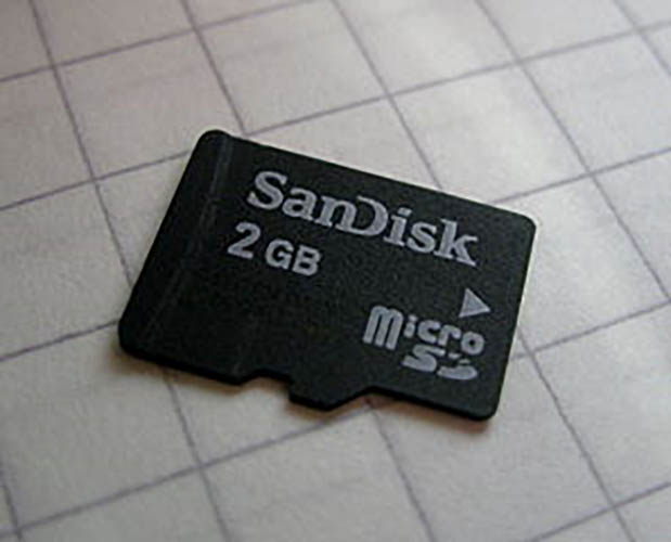

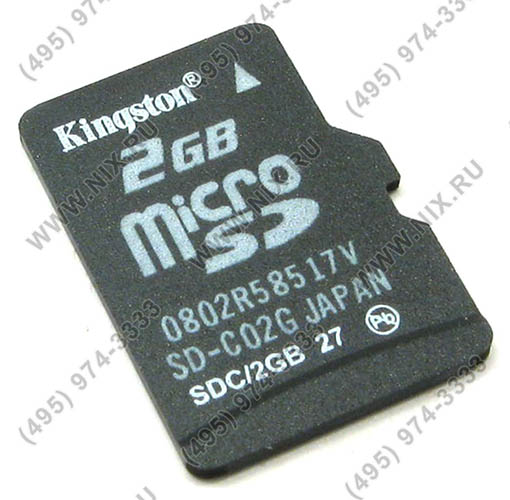

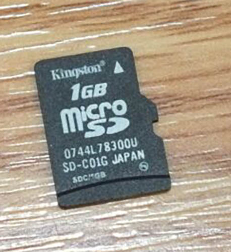

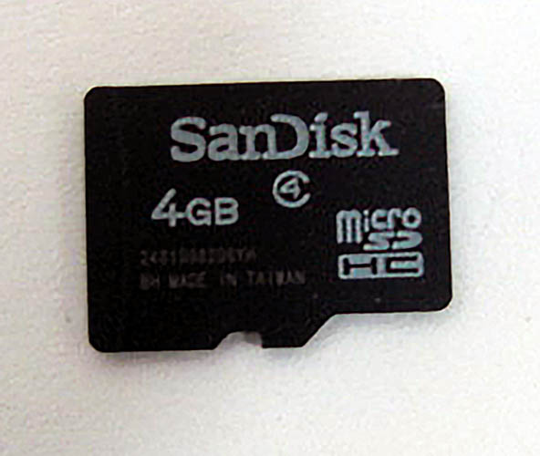

作者: vafomin    时间: 2023-4-26 00:58
Some more not working SD cards with such problem.All microSD now.
SanDisk 2gb
SanDisk 4gb SDHC 4 class
Kingston 1gb SD-C01G
Kingston 2gb SD-C02G
Kingston-SD-C01G.jpg Kingston-SD-C02G.jpg SanDisk 4gb SDHC 4 class.jpg SanDisk_2GB_MicroSD.JPG
