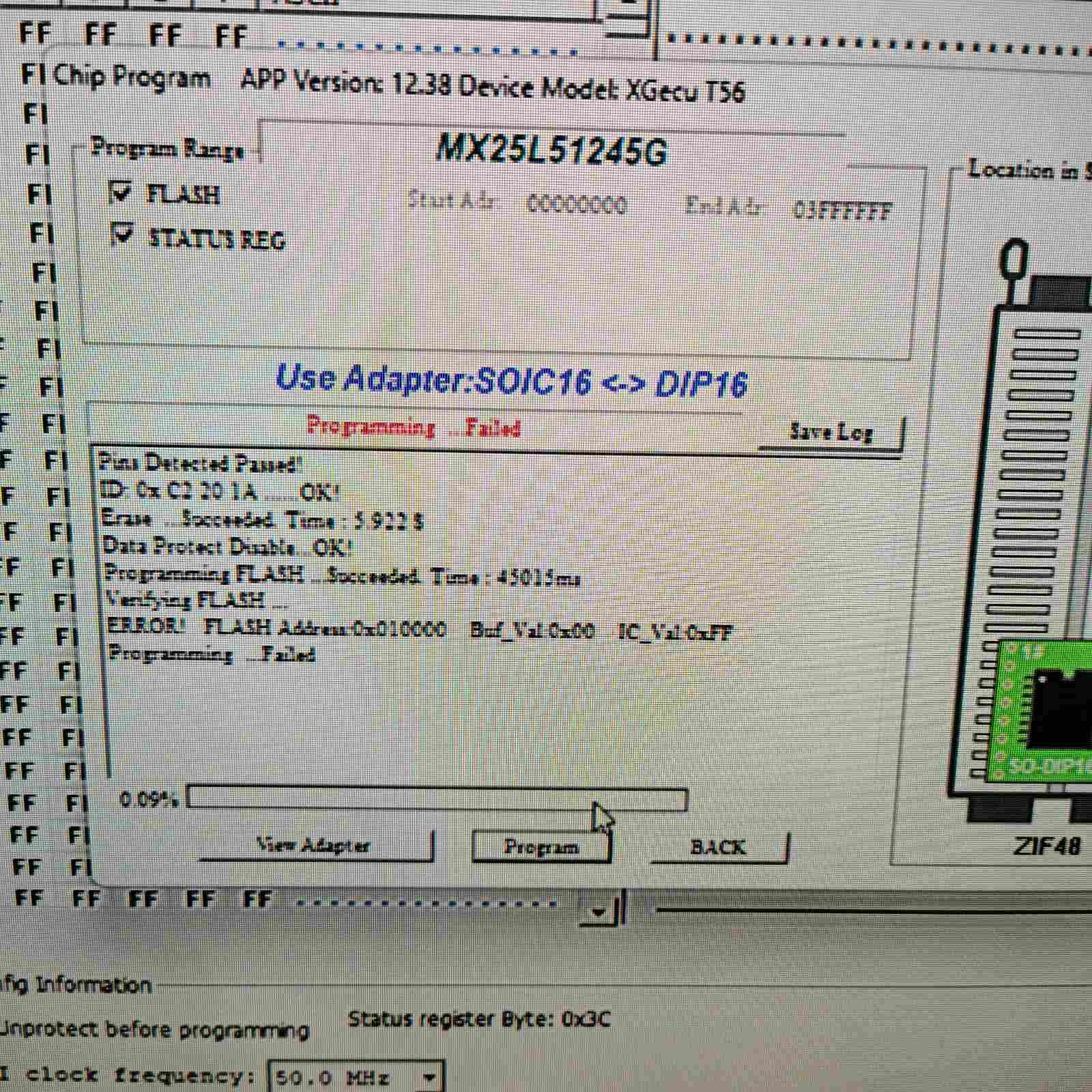

i buy new mx25l51245gmr but when i try to write i have error to write it why i cant write? programmer issue? viber_image_2022-12-17_10-24-41-977.jpg
图片附件: [error] viber_image_2022-12-17_10-24-41-977.jpg (2022-12-17 16:25, 211.62 KB) / 下载次数 23714
http://forums.xgecu.com/attachment.php?aid=1641&k=176f2b3fa3cedc78cef0e884b0a296e4&t=1793762761&sid=VHAN33

1. self check programmer and upload result picture.

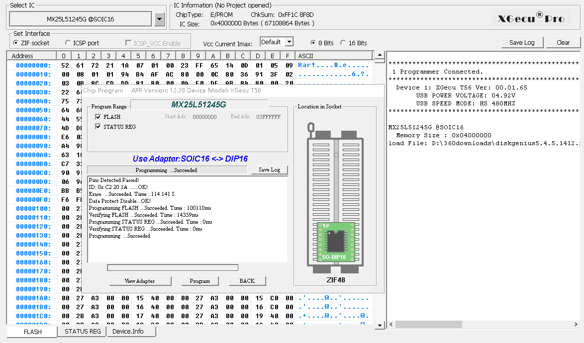

2.erase time is not right. my testing is 141s ,your testing is 5.9s.
图片附件: 1.png (2022-12-17 17:46, 54.93 KB) / 下载次数 21431
http://forums.xgecu.com/attachment.php?aid=1642&k=53824c779d582b5c5da754beffbb5101&t=1793762761&sid=VHAN33

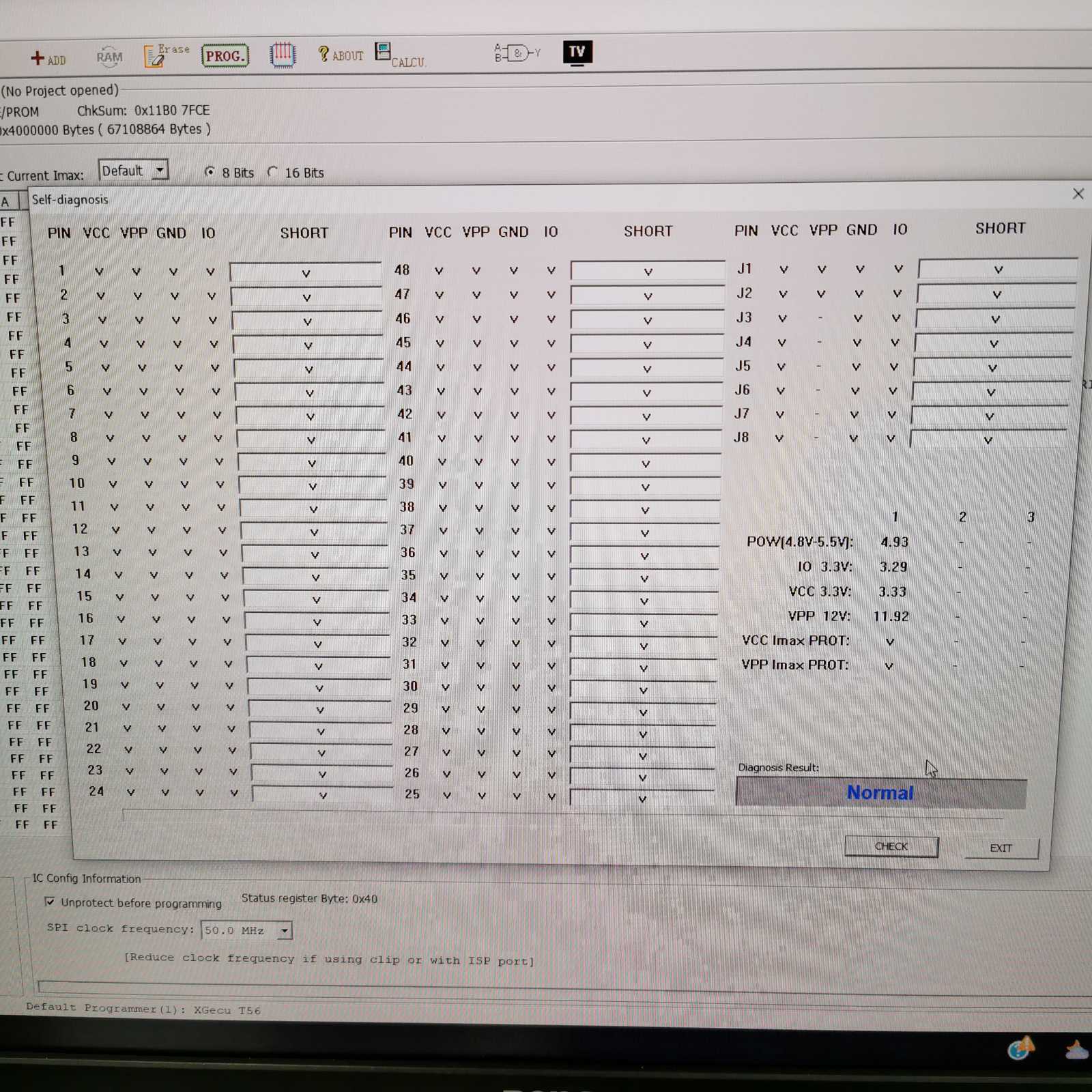

作者: demetris11    时间: 2022-12-19 13:17
图片附件: viber_image_2022-12-19_07-15-52-664.jpg (2022-12-19 13:17, 244.71 KB) / 下载次数 23650
http://forums.xgecu.com/attachment.php?aid=1643&k=bb0cd6e141f468dbbeefd4c044cb62a6&t=1793762761&sid=VHAN33
作者: admin    时间: 2022-12-20 08:41
回复 6# demetris11
   The programmer is normal .
