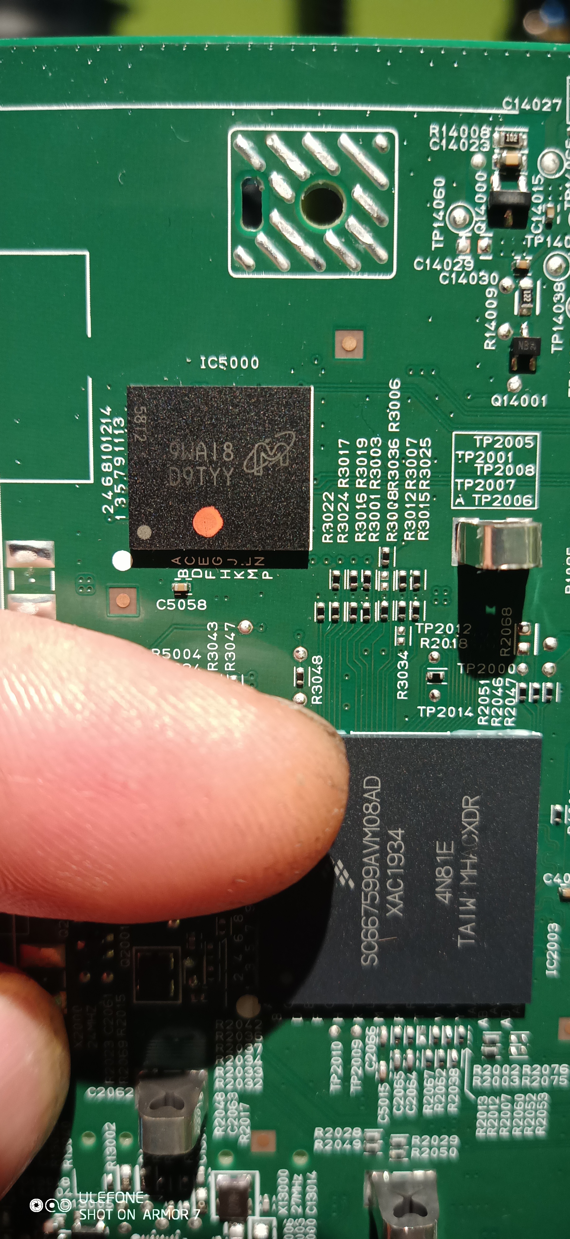

Hi guys
I try to read it's Micron on the motherboard and I can't read this EMMC memory
Can you tell me with which bga you can read this EMMC???9WA18
and what micron do I choose?
I have BGA 64A-1.0 and BGA100, but I think with these I can't read

this is   MTFC8GACAENS-K1 AIT  MARK: D9TYY  BGA153
Find on micron WEB:FBGA and Component Marking Decoder (micron.com)

   Thanks for your help
