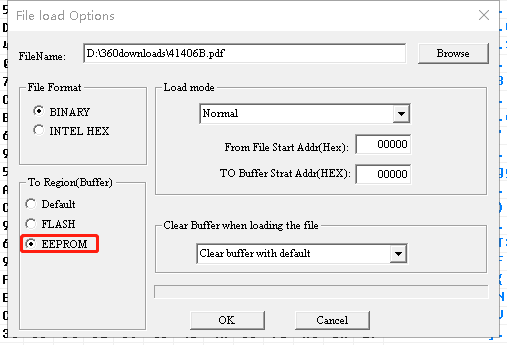

problema com os atmegas só carrega o flash. a eeprom não carrega no software. a eeprom é toda ff, ff, ff,...

作者: admin    时间: 2022-12-11 09:42
回复 1# marck3
图片附件: 1.png (2022-12-11 09:42, 9.7 KB) / 下载次数 19436
http://forums.xgecu.com/attachment.php?aid=1621&k=7652b60768e418ddf65f91e1a0c5f30e&t=1793839406&sid=iOowtM
作者: marck3    时间: 2022-12-12 05:59
:victory:  funcionou, obrigado.
作者: marck3    时间: 2022-12-12 06:03
it worked, thanks
