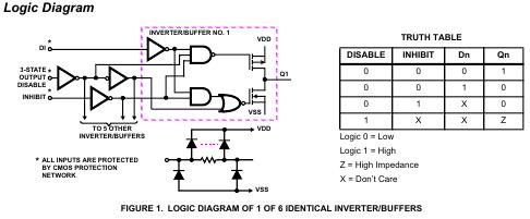

New Logic Test - 4502
4502 - CMOS Strobed hex inverter/buffer. Russian analog - К561ЛН1 (K561LN1)
