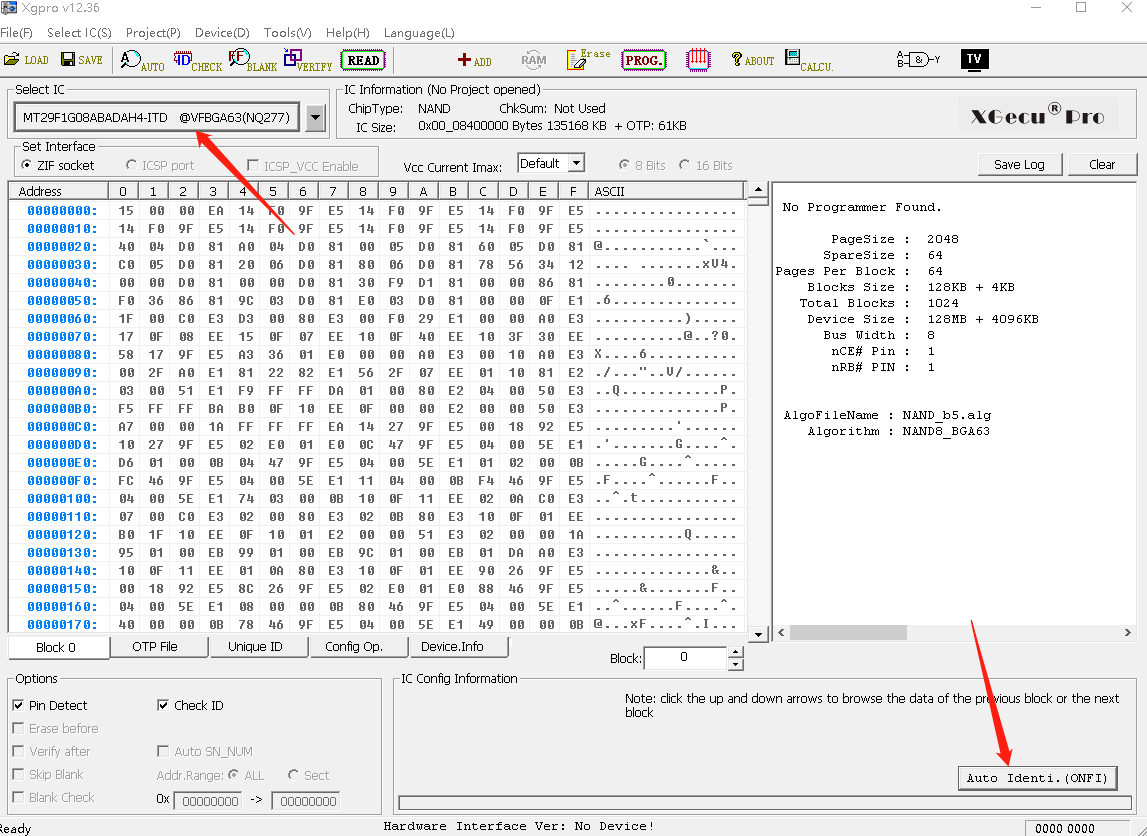

Please, add a way to read this memory: JS27HU1G08SCDA (JEJU SEMICONDUCTOR).
I have Xgpro and T56 and don't recognize.
Thx

作者: admin    时间: 2022-11-16 09:57
回复 3# frankviana
   There is no specification datasheet, and it can't be added. If you are a user, you can apply from them
you can select MT29F1G08ABADA @BGA63
and click [auto indenti] ,if it is an ONFI standard chip. you can read and programming it.

作者: frankviana    时间: 2022-11-17 01:30
I'll try and post here.
Thanks
作者: frankviana    时间: 2022-12-18 05:56
READ OK.
Thanks
