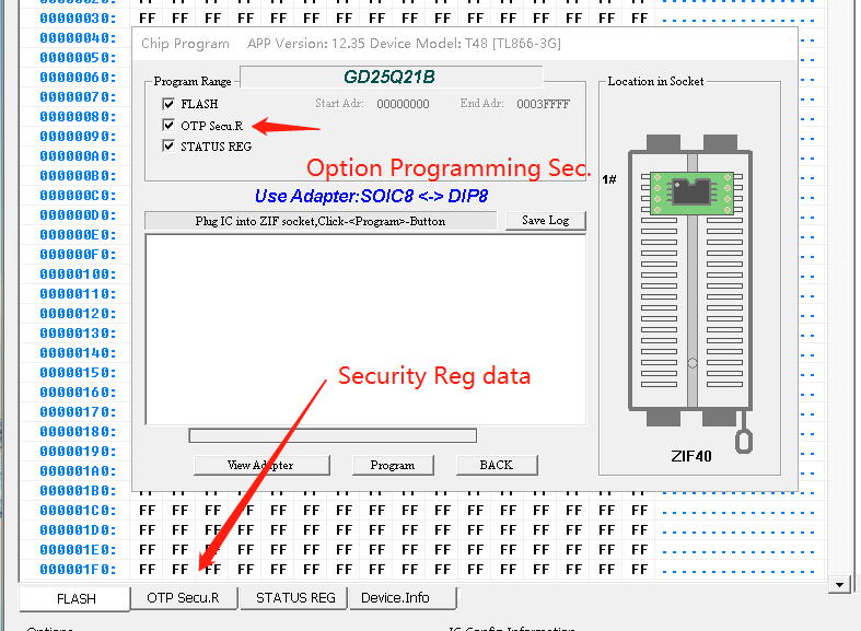

Most 25 series chips have special SecurityRegistersArea, known as OTP area. How to read/write this area?
作者: admin    时间: 2022-11-15 09:58
回复 1# vladi552
图片附件: 1.png (2022-11-15 09:58, 37.79 KB) / 下载次数 15403
http://forums.xgecu.com/attachment.php?aid=1547&k=4cfbc8f692f0d19f6a2141c482d0c063&t=1793839422&sid=Nq618Q
作者: vladi552    时间: 2022-11-15 23:25
Currently working with GD25Q16C on T56 interface! 1. Do you mean I need to switch to another IC to working with SecurityRegisters?
2. Is it true, TL866 do not support this functionality at all? Otherwise, where I can found this ability?
For T56 this issue looks like 25 series not fully supported. Do you plan to add security registers functionality to futher software release for EACH 25ser chips?
作者: admin    时间: 2022-11-16 09:54
回复 3# vladi552
  miss Secu.reg progamming in  GD25Q20C/40C/80C/16C .
  fixed in next version.
