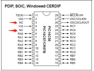

When I read a PIC16C57 I have error PIN 3 and 5 are not connected.
On my TL866II the PIC16C57 works without any problems.

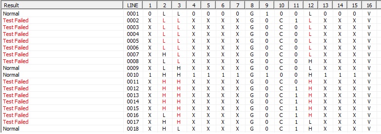

When I do a logic test on a CD4021, the chip is not recognized by the T48.
When I do the logic test with CD4021 on my TL866II, it works without problems.

1.PIC16C57 Pin 3/5 is Not Connect,  can not be detected . you can disable [pin Detect] in Options.   T48 Pins sets of PIC16C57 is wrong. will be fixed in next version.
2. Please you upload a picture of Testing 4021. (not AUTO FIND)

2. HEF4021BP:
图片附件: HEF4021BP.jpg (2022-11-5 01:36, 96.81 KB) / 下载次数 22555
http://forums.xgecu.com/attachment.php?aid=1516&k=c21572c53eaa2c8a4f3fa53787fea30f&t=1793239258&sid=9F5U50

    CD4021.lgc (2.48 KB)
4021 fixed .
import this file.

作者: mvlc    时间: 2022-11-11 03:21
Thanks for the 4021 solution! It's working fine.
