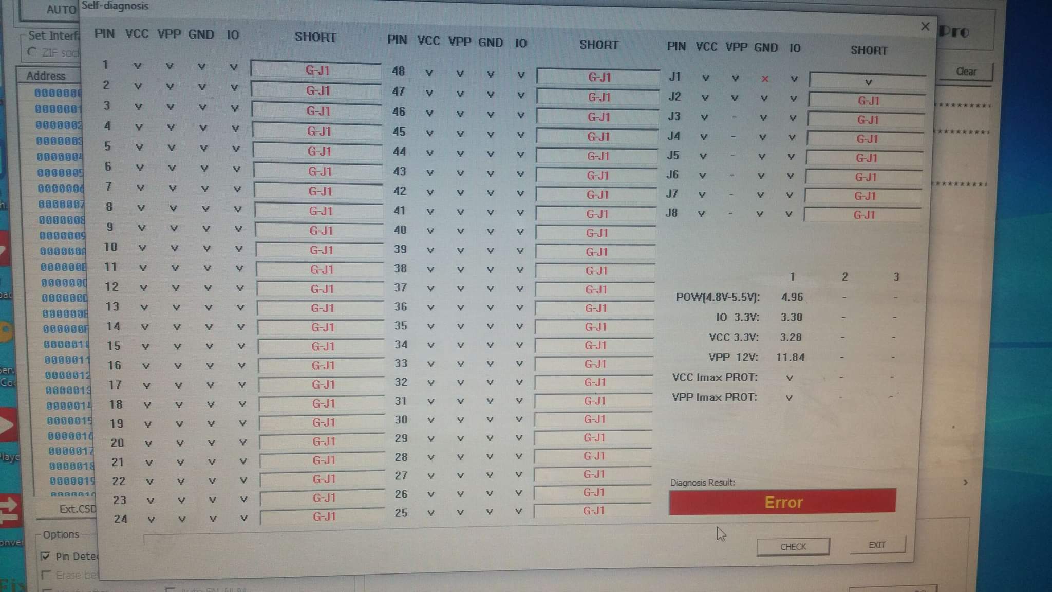

Wath is the probleme
作者: flashdm    时间: 2022-11-1 06:21

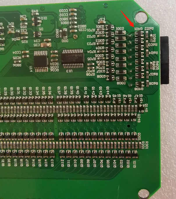

作者: admin    时间: 2022-11-1 09:15
回复 2# flashdm
This is ISP PIN1 short circuit to ground。Q401 may be bad. Please replace it.
(Q401:  BC817-40W Package:SOT323)
