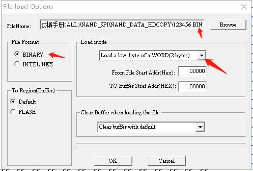

I have a .HEX dump and the instructions are following:
"2x 27C256 are required, The hex file has to be split up in even/odd bytes to obtain High byte/Low byte"
Question:
How do I split or burn a .HEX to 2 x 27C256 with the XGpro software?
Example attached:
Hex.zip (38.75 KB)
附件: Hex.zip (2022-10-28 17:33, 38.75 KB) / 下载次数 95549

作者: admin    时间: 2022-10-29 11:47
回复 1# teevee
   HEX to BIN to file, and then load bin file
作者: teevee    时间: 2022-10-29 20:51
回复 2# admin
Thank you and then I will have a .bin file instead of Hex, how do I then split it into 2 x 27C256 of HI/LO?
Since the guide says 2 x 27C256, then I guess the input should be 27C512.
作者: admin    时间: 2022-10-30 14:38
回复 3# teevee
right!
作者: teevee    时间: 2022-11-1 15:16
回复  teevee
right!
作者: admin    时间: 2022-11-2 10:49
回复 5# teevee
图片附件: 1.png (2022-11-2 10:49, 10.4 KB) / 下载次数 24870
