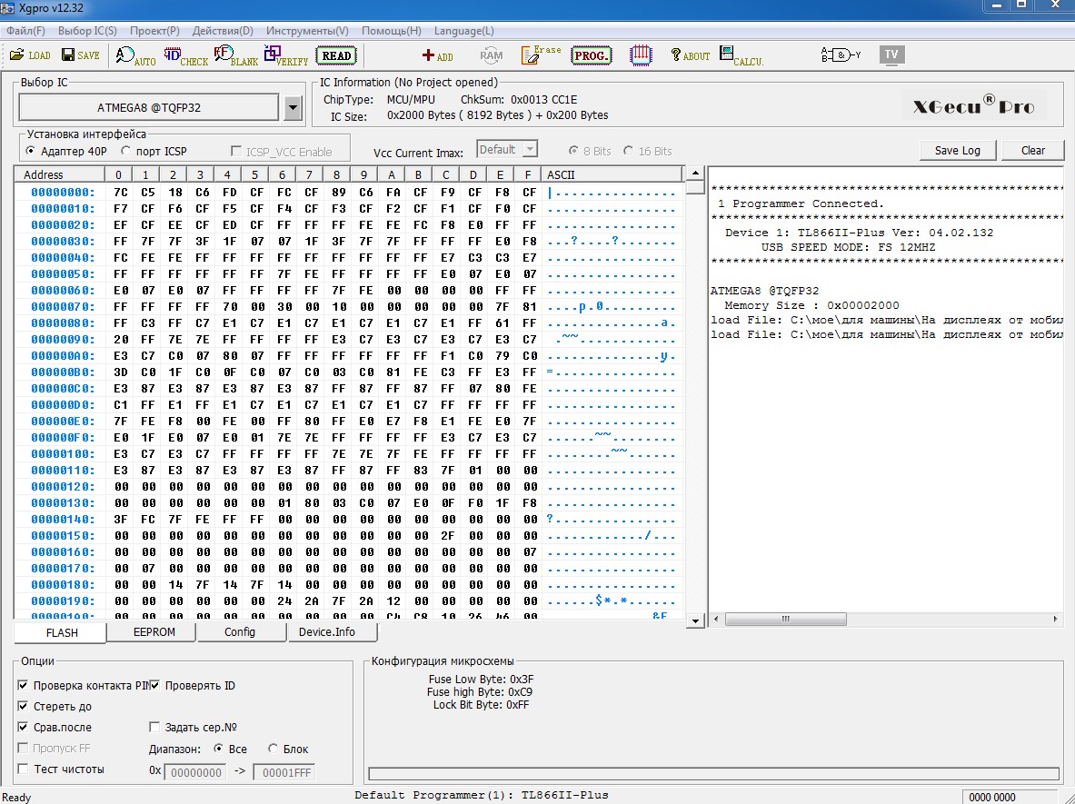

I am using TL866II Plus. The program does not correctly read the eeprom from the file. The program reads and writes Flash and config correctly, but not eeprom. This is how it started after updating from version 11.81
作者: tomas37    时间: 2022-10-20 17:14
I also use the AVRDude programmer to flash atmega chips and I have no problems with it. AVRDude reads the flash and eeprom files correctly and the atmega flashed device works. And if I flash the atmega chip with flash and eeprom files with the XGPro program, then the device does not work correctly.
图片附件: Скриншот 20-10-2022 160622.jpg (2022-10-20 17:42, 335.81 KB) / 下载次数 19700
http://forums.xgecu.com/attachment.php?aid=1485&k=9a81d09ed04de0b15317b4aaa7fba680&t=1793474993&sid=92j1Nz

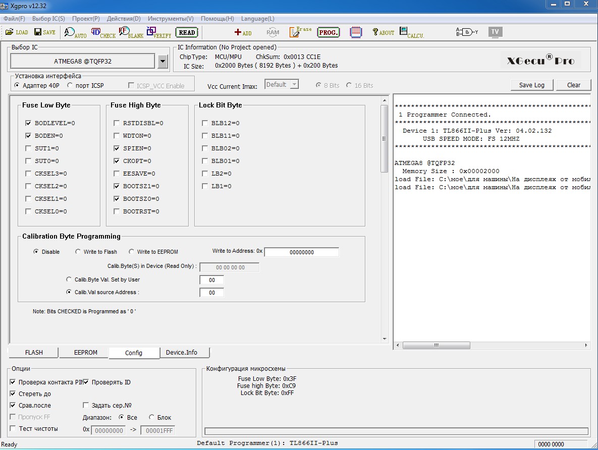

作者: admin    时间: 2022-10-20 17:36
回复 4# tomas37
Device configuration item is not set! There is no configuration information in the saved file.
you must set correct Fuse low byte and  fuse high byte .

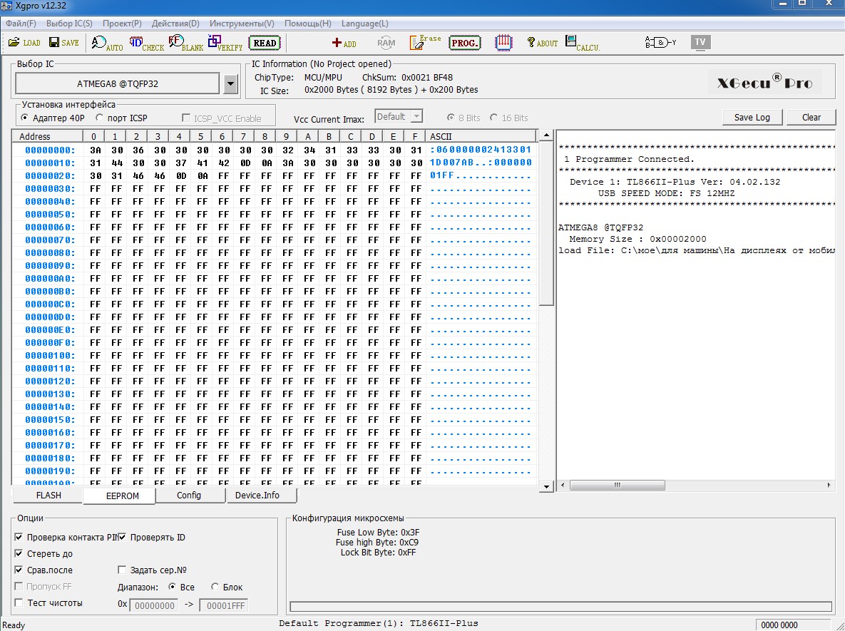

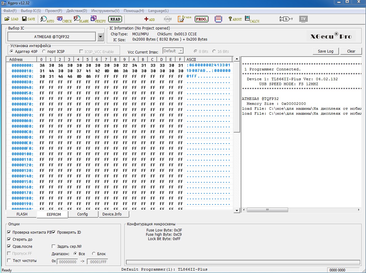

作者: tomas37    时间: 2022-10-20 19:00
and
Скриншот 20-10-2022 175846.jpg Скриншот 20-10-2022 180528.jpg Скриншот 20-10-2022 180554.jpg
图片附件: Скриншот 20-10-2022 175846.jpg (2022-10-20 19:06, 207.61 KB) / 下载次数 18365
http://forums.xgecu.com/attachment.php?aid=1487&k=f0f7b8712c9e327c9fa47dd9a1a7ae70&t=1793474993&sid=92j1Nz
图片附件: Скриншот 20-10-2022 180528.jpg (2022-10-20 19:06, 345.1 KB) / 下载次数 19375
http://forums.xgecu.com/attachment.php?aid=1488&k=6efcf97b69797f417d864b33666ad667&t=1793474993&sid=92j1Nz
图片附件: Скриншот 20-10-2022 180554.jpg (2022-10-20 19:06, 346.43 KB) / 下载次数 19466
http://forums.xgecu.com/attachment.php?aid=1489&k=c96474a601b18125beadcd45609ac52a&t=1793474993&sid=92j1Nz

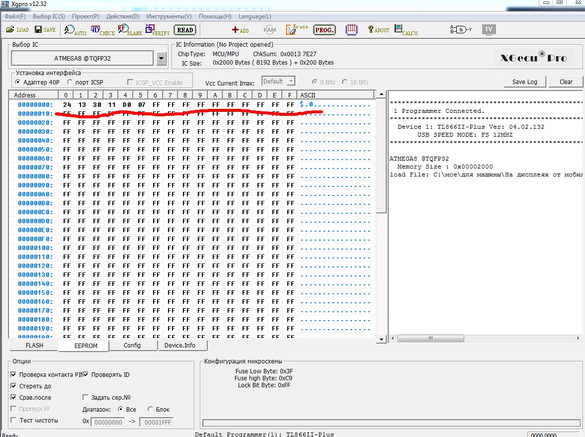

作者: tomas37    时间: 2022-10-20 22:02
this is how it should be right
this is the same eeprom read from the chip flashed by avrdude and it works correctly!
图片附件: Скриншот 20-10-2022 210035.jpg (2022-10-20 22:01, 325.04 KB) / 下载次数 19428
http://forums.xgecu.com/attachment.php?aid=1491&k=5e2e5efb49c94db2721571dd3485562b&t=1793474993&sid=92j1Nz

作者: tomas37    时间: 2022-10-20 22:41
I can conclude that the program correctly reads the eeprom from the atmega chips, but the program cannot correctly read the eeprom from a file on the computer if it is not a .BIN file
thanks for 11.81 :handshake
作者: Albano.Matos    时间: 2022-10-20 23:21
I can conclude that the program correctly reads the eeprom from the atmega chips, but the program ca ...
tomas37 发表于 2022-10-20 22:41
   Hello:  Have you tried to open the EEP file , using 'INTEL HEX' mode?File Load options, choose the EEP file, in the file format (left) change to INTEL HEX, and press ok.
作者: tomas37    时间: 2022-10-20 23:57
yes, it worked!!! Thanks! :D
