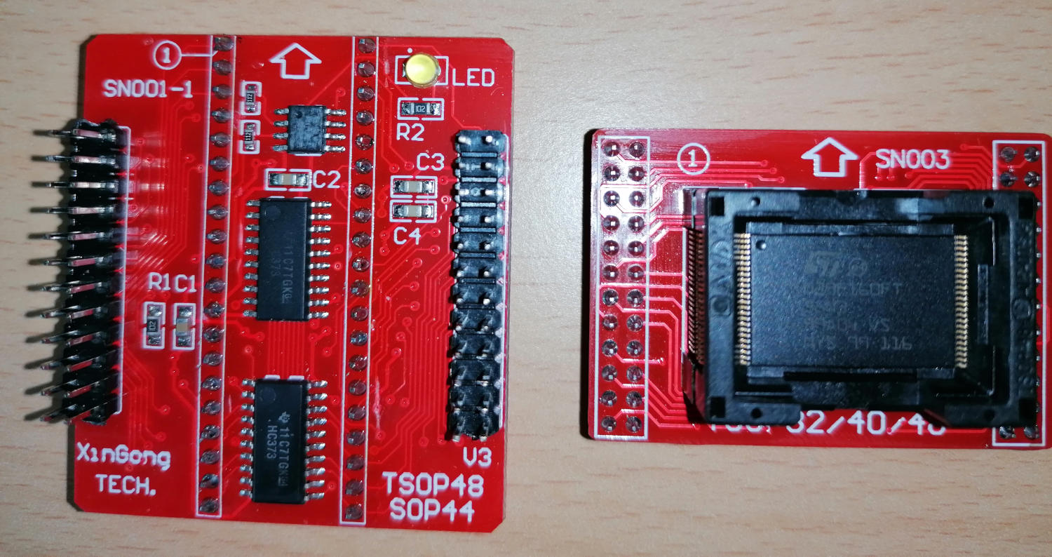

Hi,
i have an Xgecu TL866II Plus programmer and ordered an TSOP48 Adapter Board (SN001 V3 and SN003). When i try to read the flash chip M29F160FT i only get the message "check adapter and position" from the software Xgpro v12.32.
I read that there are fake adapters out there so i'm wondering if i got one. I ordere the adapter from here:
https://www.aliexpress.com/item/32994124021.html
and it says that it is the official Xgecu store.
How can i check if my adapter is a genuine or a counterfeit one?
Or what else could be the problem that the adapter seems not to be recognized?
Ciao,
       Rainer
图片附件: [adapter] adapter.jpg (2022-10-15 22:47, 226.67 KB) / 下载次数 20061
http://forums.xgecu.com/attachment.php?aid=1477&k=565c403b25b1c50c4ede985836a7964a&t=1793659302&sid=qYDDaQ

It's sad that no one has any idea how to solve this problem.
XGecu also doesn't respond to my emails and i hoped to get a little  bit support here in the forum. :(

回复 2# quakeman
It is possible that the adapter is bad. try to Solder all solder joints again.Especially the two resistors on the left of SOIC8 Key IC
