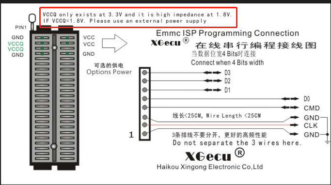

作者: admin    时间: 2022-10-11 14:21
only at 3.3V power ,VCCQ is valid.

作者: Oleg_Skalskiy    时间: 2022-10-12 18:44
Maybe you need some modification of the box? Here on the forum, most of the engineers will be able to fix it!

作者: Test    时间: 2022-10-17 04:19
To correct! Instead of 1.8V, the voltage is 1.5V
Add the ability to edit firmware (dump files or di ...
Oleg_Skalskiy 发表于 2022-10-10 17:36
Hand mode VCCQ 1,5V 🤔
作者: Oleg_Skalskiy    时间: 2022-10-18 01:53
Test 发表于 17-10-2022 04:19
    I installed AMS1117 1.8V on the adapter
But the partition manager is missing
作者: admin    时间: 2022-10-18 08:43
回复 6# Oleg_Skalskiy
AMS1117-1.8V  is Is inappropriate.
need a LDO as XC6206 1.8V

作者: Oleg_Skalskiy    时间: 2022-10-19 04:37
Thanks
Oleg_Skalskiy 发表于 18-10-2022 21:30
may be into the box to make a modification?
