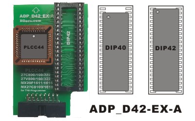

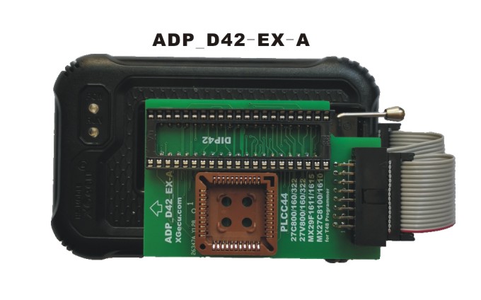

1.DIP42/PLCC44
for 27C800/160/322  27V800/160/322  MX27C8100/1610
only for T48 Programmer
T48_DIP42-2.rar (657.12 KB)

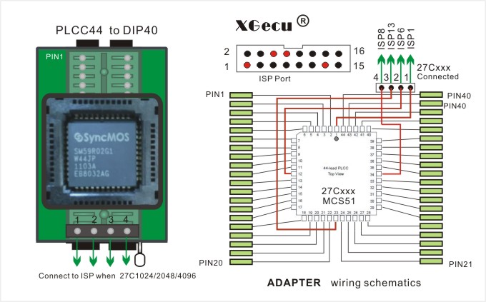

2.PLCC44  for  C51 /27Cxxxx / PIC
PLCC44_T48.rar (1.07 MB)

图片附件: T48_DIP42.jpg (2022-8-20 12:10, 46.47 KB) / 下载次数 39307
http://forums.xgecu.com/attachment.php?aid=1399&k=c676400749e8df22a2943944ab95b9d5&t=1793566177&sid=nRBI0i
图片附件: T48_DIP42_P.jpg (2022-8-20 12:10, 27.25 KB) / 下载次数 38510
http://forums.xgecu.com/attachment.php?aid=1400&k=4763a7e829e6a3d213d5913bcd8ff185&t=1793566177&sid=nRBI0i

图片附件: T48PLCC44.jpg (2022-8-20 12:12, 68.23 KB) / 下载次数 39273
http://forums.xgecu.com/attachment.php?aid=1402&k=53a7e7ab052ae7af92d4b33b7dce189b&t=1793566177&sid=nRBI0i
