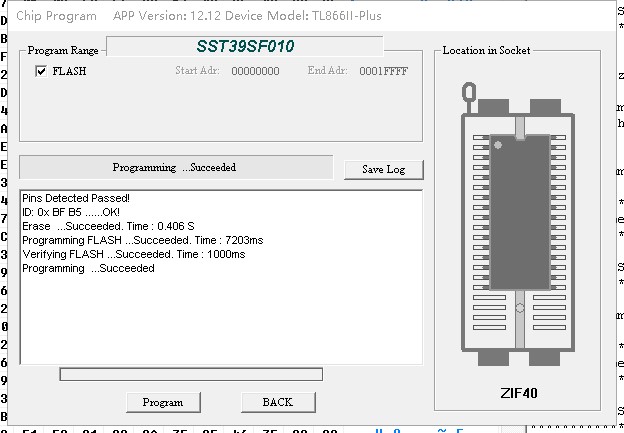

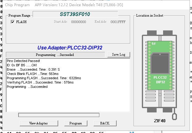

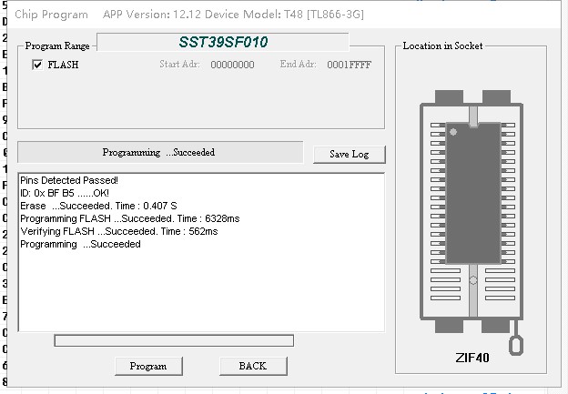

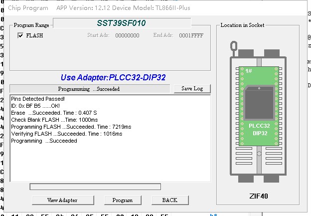

作者: admin    时间: 2022-8-18 11:48
回复 2# vijovijo
1. 27C010 is not DIP28!  only 32PIns IC
address 800   error ------> A11 pin is bad  of your adapter
2. It should  your PLCC32 adapter is bad.
   PLCC32  shuld to DIP32  , not to DIP28
3, I tested TL866II and T48, all is normal!

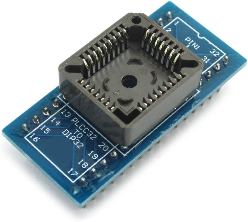

作者: vijovijo    时间: 2022-8-18 15:48
Problem solved with AM29F010B, problem was the adapter, it was shorting some pins from the PLCC32  ...
vijovijo 发表于 2022-8-18 14:08
Also tested SST39SF010A, working good, PLCC32 to DIP32 adapter fixed.
Thanks for the fast responce.
作者: vijovijo    时间: 2022-8-18 16:03
As A User: Happy for you .Some shops in internet do not test adapters, or do not test ada ...
Albano.Matos 发表于 2022-8-18 15:38
Thanks.
Here is the adapter I purchased and I don't recommend:
The PLCC socket is too near the DIP pins and shorted. Junk.
Thanks to all for the help.
