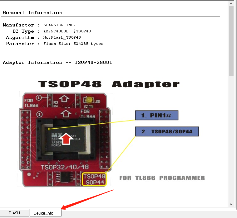

Please tell me what is the problem when reading chip AM29F400BB from AMD? I have original xgecu tl866 II Plus programmer from you and tsop48 V2 adapter. I updated programmer to latest software and firmware but i get error from image. I checked alingment of pins and they are good. I took another same chip but same problem. I try to put ST chip M29F400BB, but i get same error only different pins are "missing" in XGecu software. Please help me. Thank you

回复 2# matej_sb
wrong adapter used.
correct adapter

作者: matej_sb    时间: 2022-8-15 19:18
Thank you for your help. I see now that i use wrong adapter. Can I use green tsop48 adapter that I have on red V3 base board (SN001) ?
作者: admin    时间: 2022-8-16 10:31
回复 4# matej_sb
   Yes
