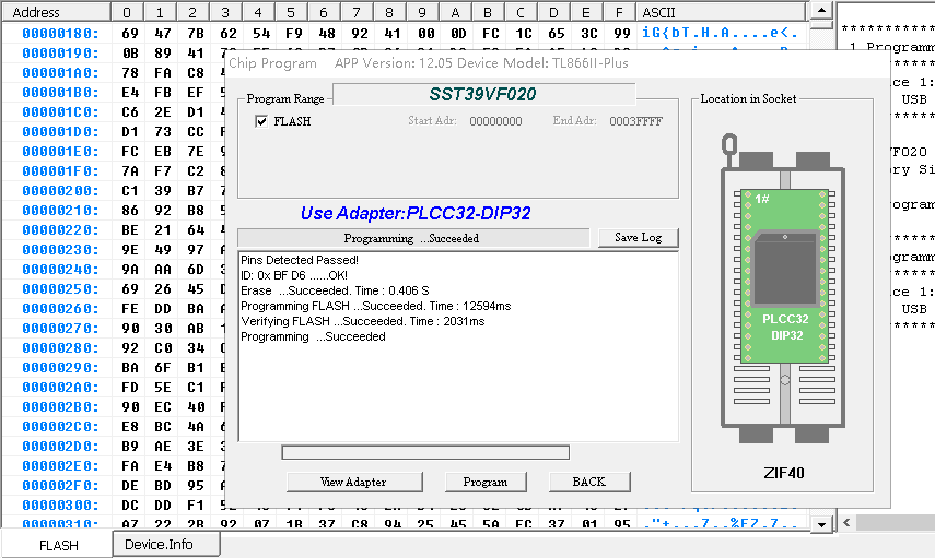

why disable CHECK ID?
these chips maybe too old.
i found this model of chips are often broken, and the ID cannot be read. Generally, it is a bad chip.
I tested it . everything  is normal.

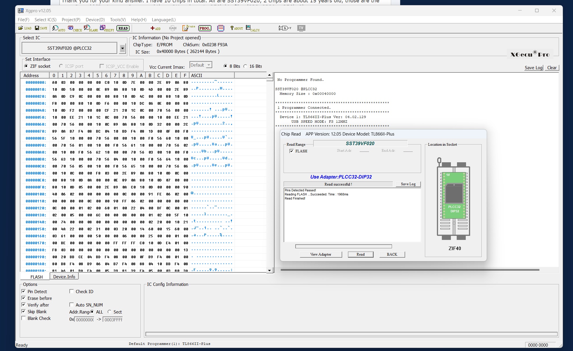

Thank you for your kind answer. I have 10 chips in total. All are SST39VF020, 2 chips are about 15 years old, those are the ones I would like to copy. I can read them OK and create 256k bin files (020, 020A = 256kx8)
I then have 2 blank chips, those are 2 years old. I can not write to them at all, so I thought they might be faulty and old.
So I just bought 6 more chips last Monday, July 18. Again, I cannot write to them at all. They all fail, but they are new.
I then bought a new PLC/DIP adapter, but this did not help either. I also re-flashed the firmware to my TL866II and changed the USB cable, but always programming fails.

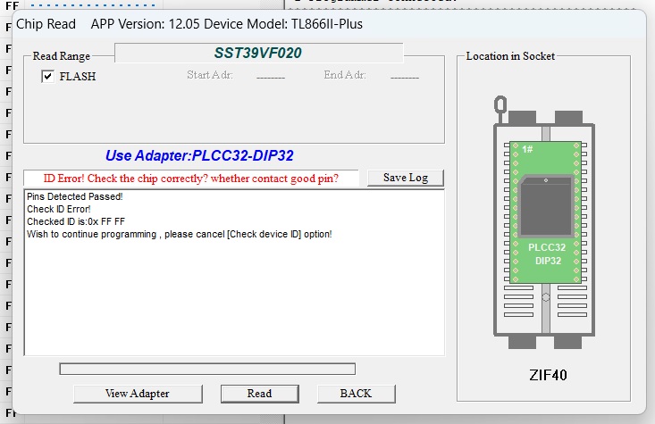

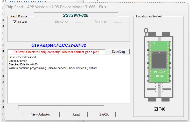

I do have to turn "Check ID" off, as it always fails for any PLCC chip.
Here reading the old master chip with Check ID ON
Here the new chip with Check ID ON
Here the master chip with Check ID OFF... it reads the data
Here the .bin files
Bin_Files.zip (297.39 KB)

作者: tokyoskies    时间: 2022-7-22 03:48
I tried several bin files now, some with only little content. Still no chance to program any eeprom. Reading is fine.
So, I thought, lets try similar chip profiles. Using CAT28F020 it appears to program and its really slow, but then fails anyway.
After all factors considered, I believe the programmer is faulty.
Another thing that is weird, I tried to reflash the original master. It seems to work at first, no errors, but it did not flash anything. I tried another completely different bin file and no error, but it did not erase or flash the chip. (I cannot even erase it, it just wont work.) This leads me to believe that the programmer has a fault, as it cannot even erase a PLCC32
I then re-flashed an older firmware (Version 1013) but still no luck.
