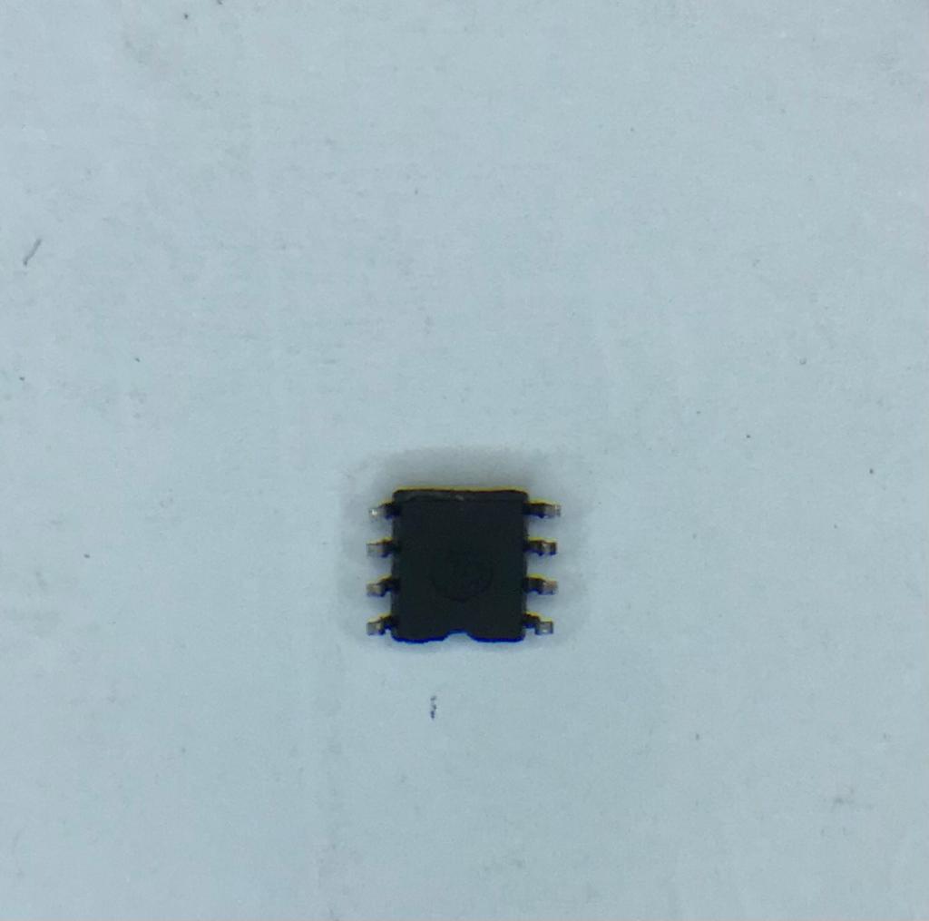

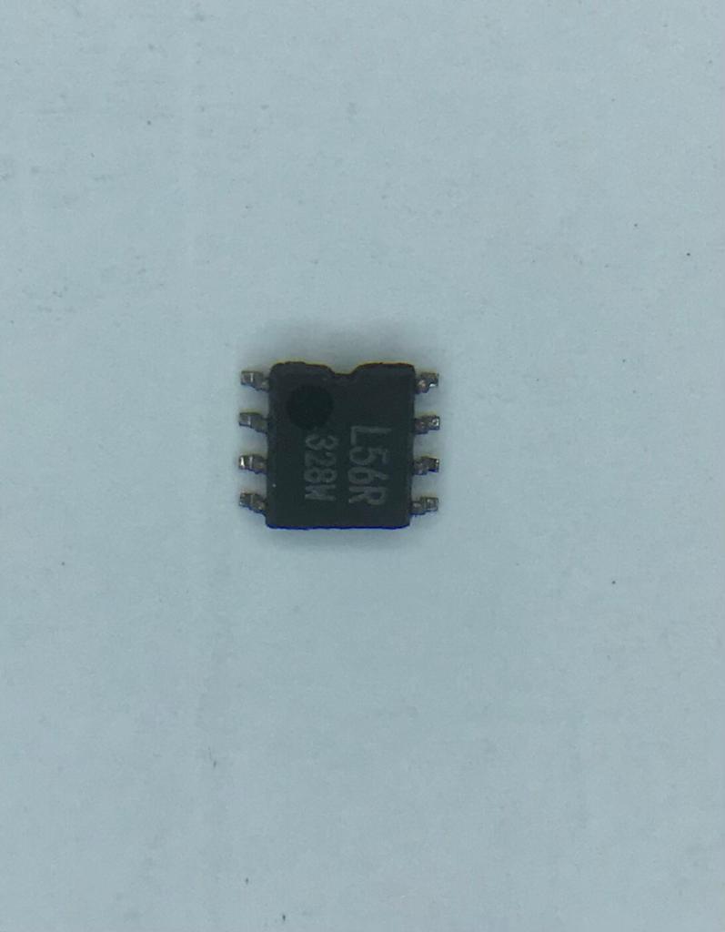

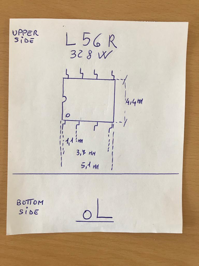

L56R memory support
Hi I ask if it is possible to have L56R memory support i tried to do the reading using 93C46, 93C56, M93C56, M93C56R, BR93C56, BR93LC56 (RF), but the test gives me different readings, you can add the read / write support for this device?
I am attaching photos and drawing of the upper / lower side and dimensions
I am waiting for an answer
A thousand thanks.
Tonino.
PHOTO-2022-06-04-12-57-52 (1).jpg PHOTO-2022-06-04-12-57-52.jpg PHOTO-2022-06-04-12-57-53.jpg

作者: Albano.Matos    时间: 2022-6-6 15:42
L56R memory support
Hi I ask if it is possible to have L56R memory support i tried to do the read ...
tonino 发表于 2022-6-4 18:56
    As an user....Have you tried with BR93L56Rx (not LC) from manufacturer ROHM (Xgpro 11.90)?
Hope it helps :-)
作者: admin    时间: 2022-6-8 17:08
回复 2# Albano.Matos
test with BR93L56 (RF) or BR93L56 (F)
2 chips pinout is diffrent.
作者: tonino    时间: 2022-6-14 16:40
Thanks for the replies, my experience had the same reading with soic8 support, Microchip 93C56 (x16), Rohm BR93C56 (X16), BR93L56 (RF) (X16), BR93LC56 (RF) (X16), ST M93C56 (X16) , M93C56R (X16), then I chose the modified, programmed ST M93C56 (x16) reading, reassembled everything "successful". Thanks a lot for the technical support.
